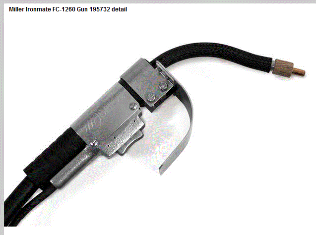

You still need the nozzle for self-shielding flux core. The only difference is the gas comes from the wire, rather than a tank. Drop the nozzle and you disturb formation of the shield gas. The wire is more forgiving of gas loss, but it helps to have a nozzle. That said, I've done some "long shot" wire welds using flux-core where the nozzle might as well have been in New Jersey. :)
I would respectfully disagree with this statement.
Flux core guns do not have gas nozzles.
/ Tips for fluxcored? #9
<img src="http://www.tractorbynet.com/forums/attachment.php?attachmentid=390946"/>
And you can get a protective cap to go in place of the gas nozzle for self shielded wire. Helps keep spatter off of the gun, and reduces the chance of shorting to the work
