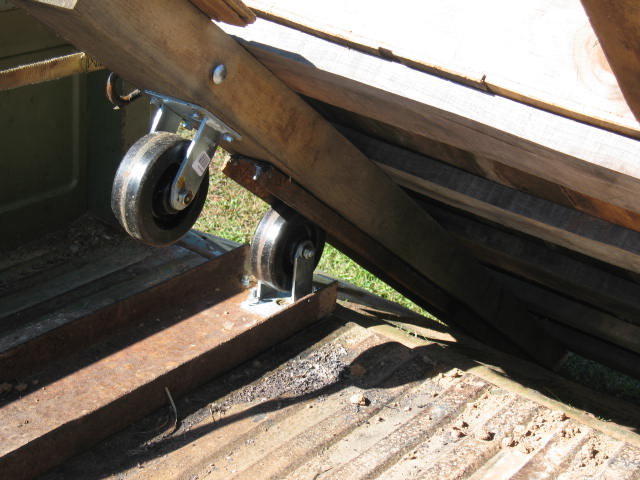

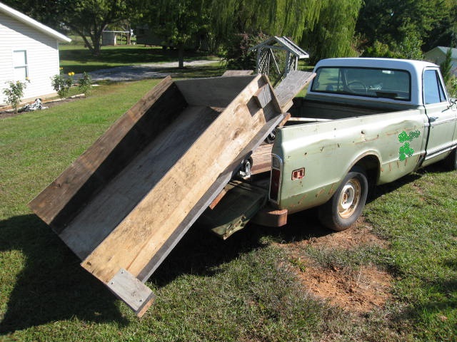

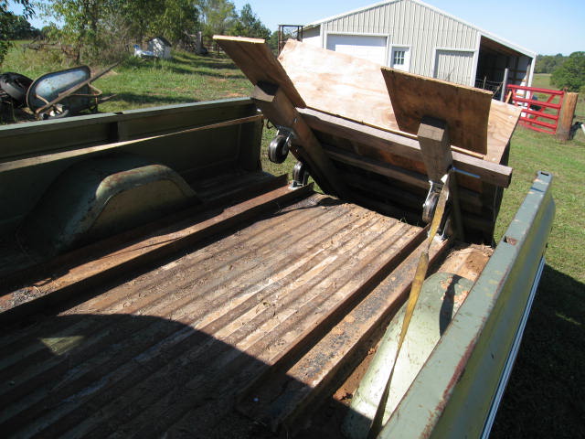

I built a rolling box in the back of an old pickup truck- perhaps you could do something similar on a bare trailer frame.. The frame needs to be pretty high for it to work- and you can't dump up a hill.
There are two pieces of channel iron bolted to the pickup bed that act as tracks for the front rollers and one piece of channel iron bolted to the passenger side beam that acts as a guide for the rear of the dump bed.
That old beat up truck is a 69 chevy. The proceedure to dump is as follows.
1. Drop the tailgate while on a level surface ahead of where you want to dump.
2. Shift into reverse and approach the spot where you want to dump the load.
3. Apply the brake firmly so that the bed has just enough momentum to roll out of the truck bed and then the back drops over center. The 2 straps catch the whole bed from rolling out onto the ground. I would guess that too quick of a stop would cause the straps to beak and the whole apparatus would come out of the truck.
4. To reset it- lift the back of the wooden bed (not too difficult- maybe 60 lbs) and roll it back into the truck. Then latch the tailgate and load it with dirt.

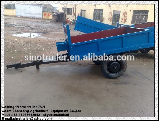

The first picture I posted is a dump trailer made for a two wheel walk behind tracter: Walking Self Tipping Dump Tractor Trailer Tractor Dump Trailers - Buy Walking Self Tipping Dump Tractor Trailer,Tipping Trailer,Two Wheel Trailer Product on Alibaba.com
I had thought about the 'digging' the rear of the trailer into the ground for tipping but you not really going to tip all your load.

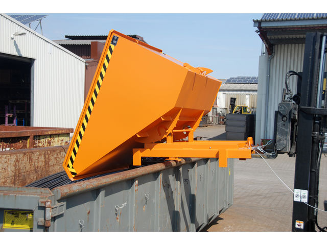

Or.... you could get yourself a Power Trac... :laughing:
But seriously, you can gain some ideas here, perhaps...
/ Tipping trailer suggestions. #39
So really there is no reason why you need to use a Power Trac. I don't see why it wouldn't work with any fel equipped with a way to quickly exchange the bucket. It's the best idea I've seen yet! Notice how the release for the tailgate just drags against the ground.
