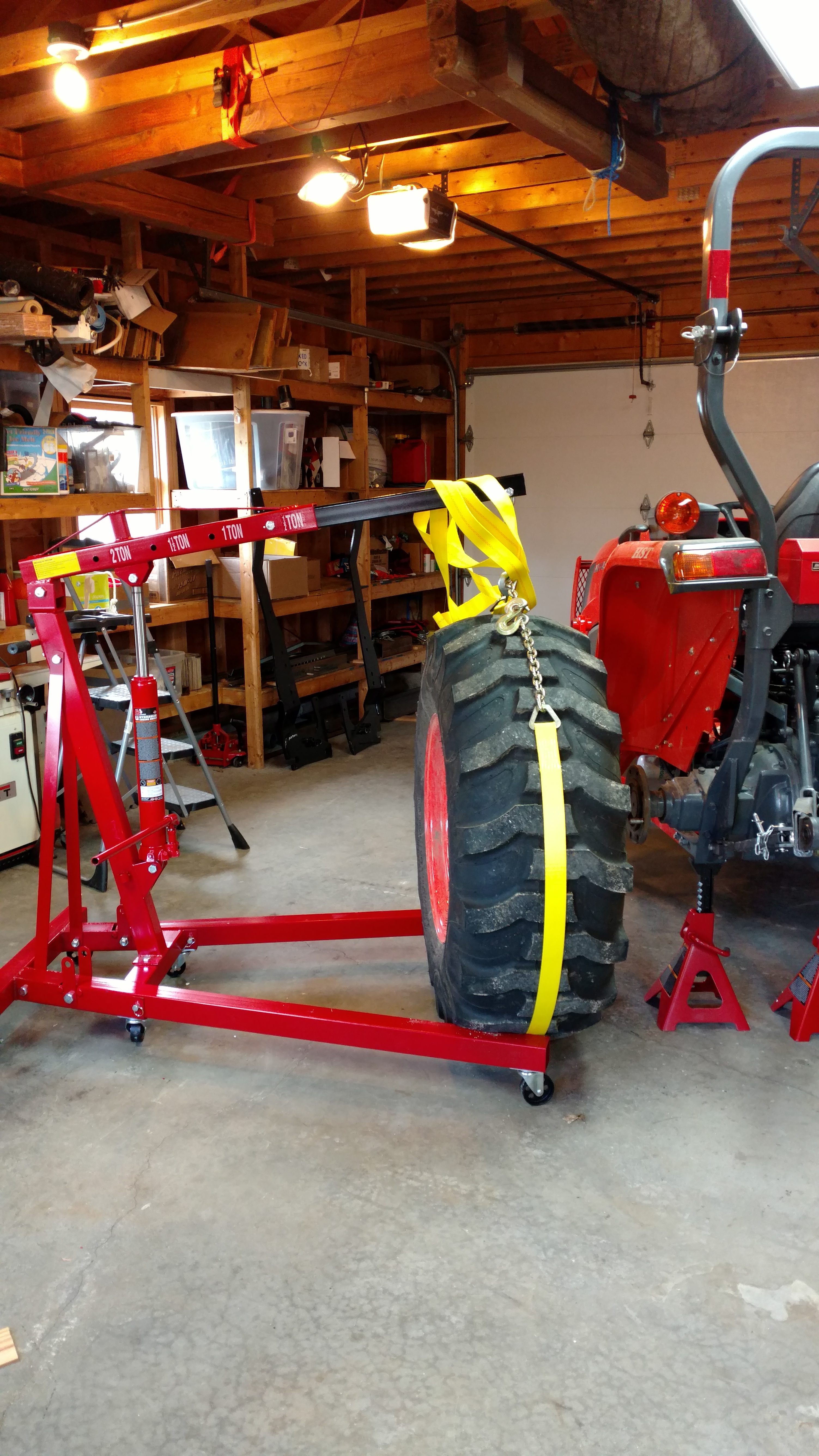

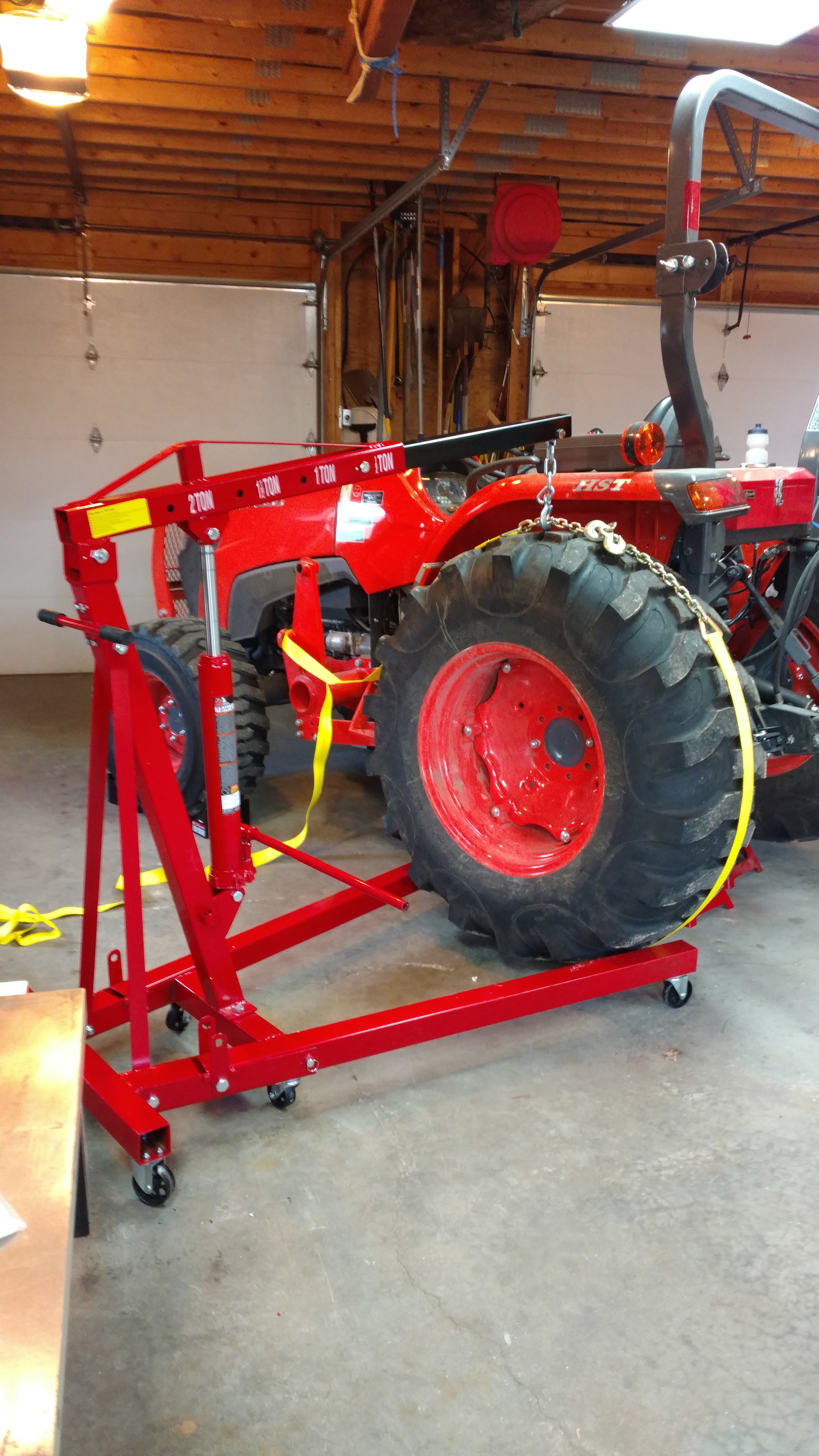

I remove my fenders ( 5 mins) then use an engine hoist and a rugged strap. Tighten the strap as tight as you dare so the crane does not move away from the tire itself. Remove lugs and let the tire settle on the frame of the engine hoist. I've had them off like 5 times, no issues. They are loaded 17.4-24L.

:thumbsup:
Thats my plan

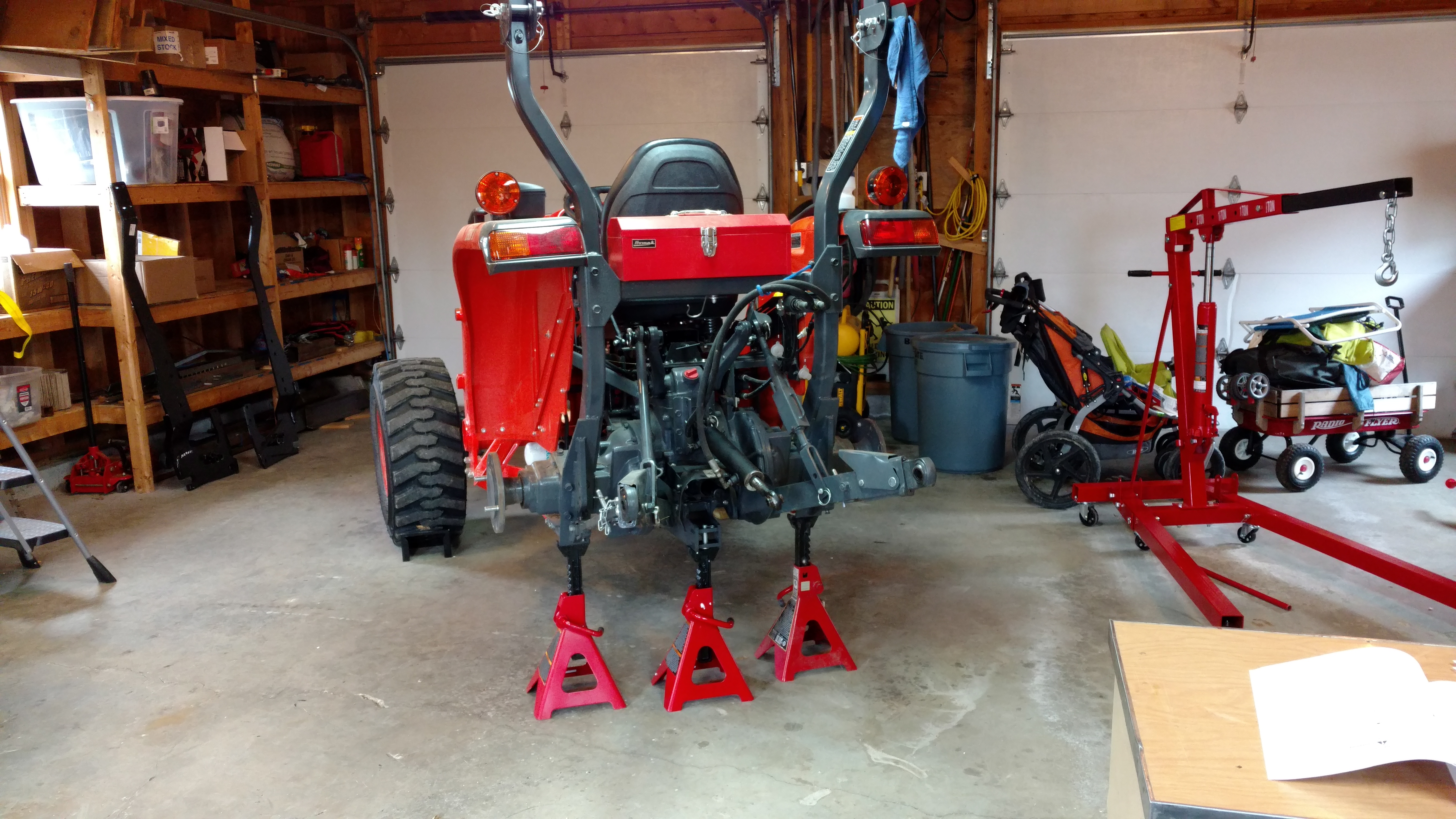

Had some free time today so I got the garage cleaned out and started on the tractor. I know getting them off is the easy part but it really was pretty easy and straight forward.
And yes I know 3 jack stands is overkill.
Hopefully, putting them back on is also anticlimactic.

You can't have too many jack stands. Good job!

According to my operator's manual you are only suposed to jack from the center (drawbar housing) after "securing the front axle so it can not turn).
Since there is no "front axle" that turns/pivots and I did not know how to fix both front wheels..... Hence three stands.
