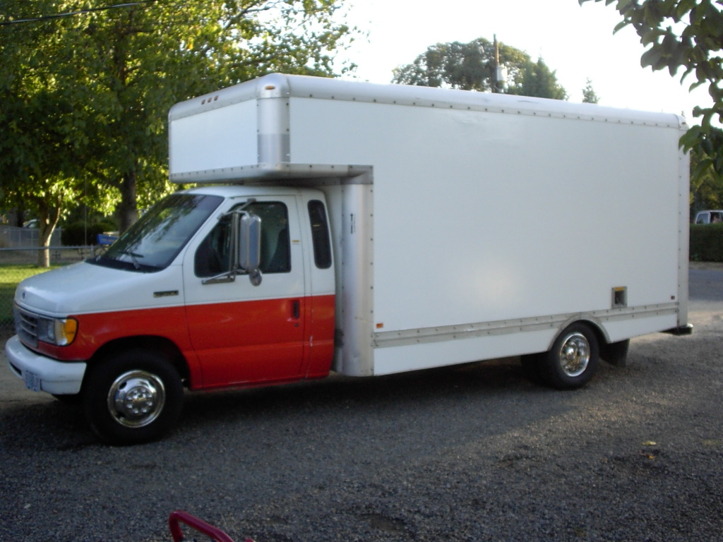

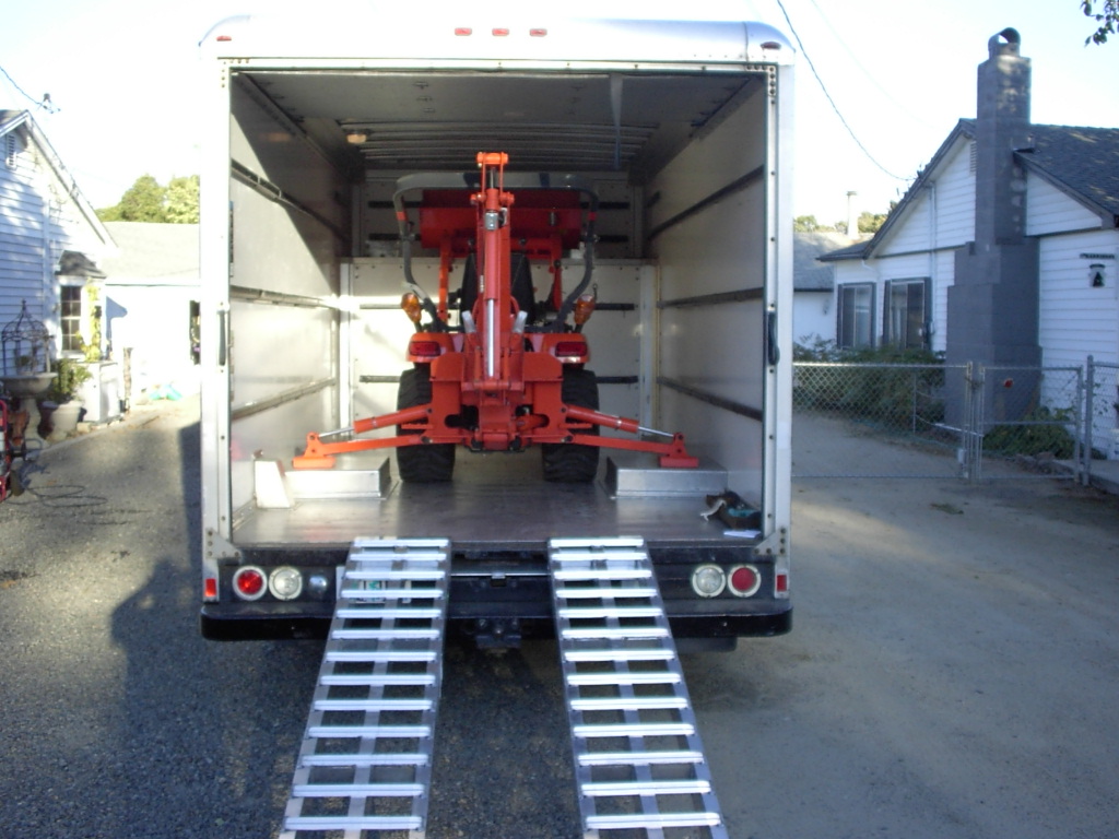

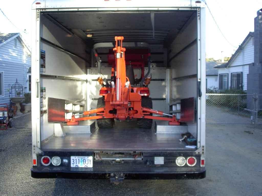

BX24Look at my new way to get around;) This little BX fits just right in my 14'+3'over top uhaul box van. I love this set up room for Box Scraper up front and tiller in back under backhoe and can use it to pickupand set it down ramps go over the top of tiller.

That is pretty trick, Be sure to mount some flush mount tie rings to to floor over the box frame. That will take the rear door right off if it gets moving around. Don't use the E track on the walls, It will destroy the cube
/ TINY TRACTOR SERVICE #5
What timber said. Tie that thing down before it rips it's way through the box....
/ TINY TRACTOR SERVICE #6
I would put some wood down for the out riggers to set on. They may vibrate and rub through the aluminum floor. Can you lower the back hoe's bucket for more stability.
