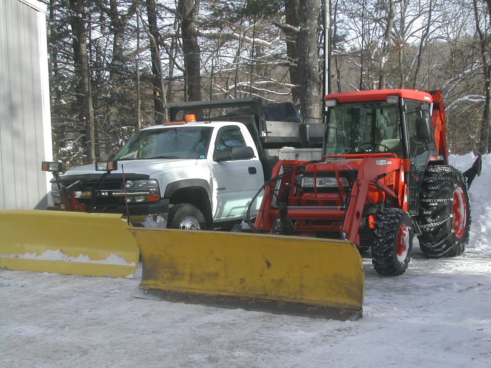

Won't your hydraulics dump far enough to match the new angle that the QA now rests in ?
Close but no match. Beside, every time the plate fell it landed on the hydraulic hoses. The plate is heavy and I figured it was just a matter of time until the hoses were damaged the way things were going.
   / Time to hook-up the snow plow UGH! #22
dolly the snowplow? if you can't square the tractor to the plow, square the plow to the dolly
I was thinking the same thing. Add maybe a bungie cord to keep the plate from tipping over.
But, that being said, I do also enjoy welding.
Good fix to the problem.

I suggust at some point replacing the link with a gas shock. They only push with about 20 lbs force so it would hold the plate up but not affect float. That way it saves hooking up the arm. On the other hand, if you need down force, you could leave your arm on for scraping.

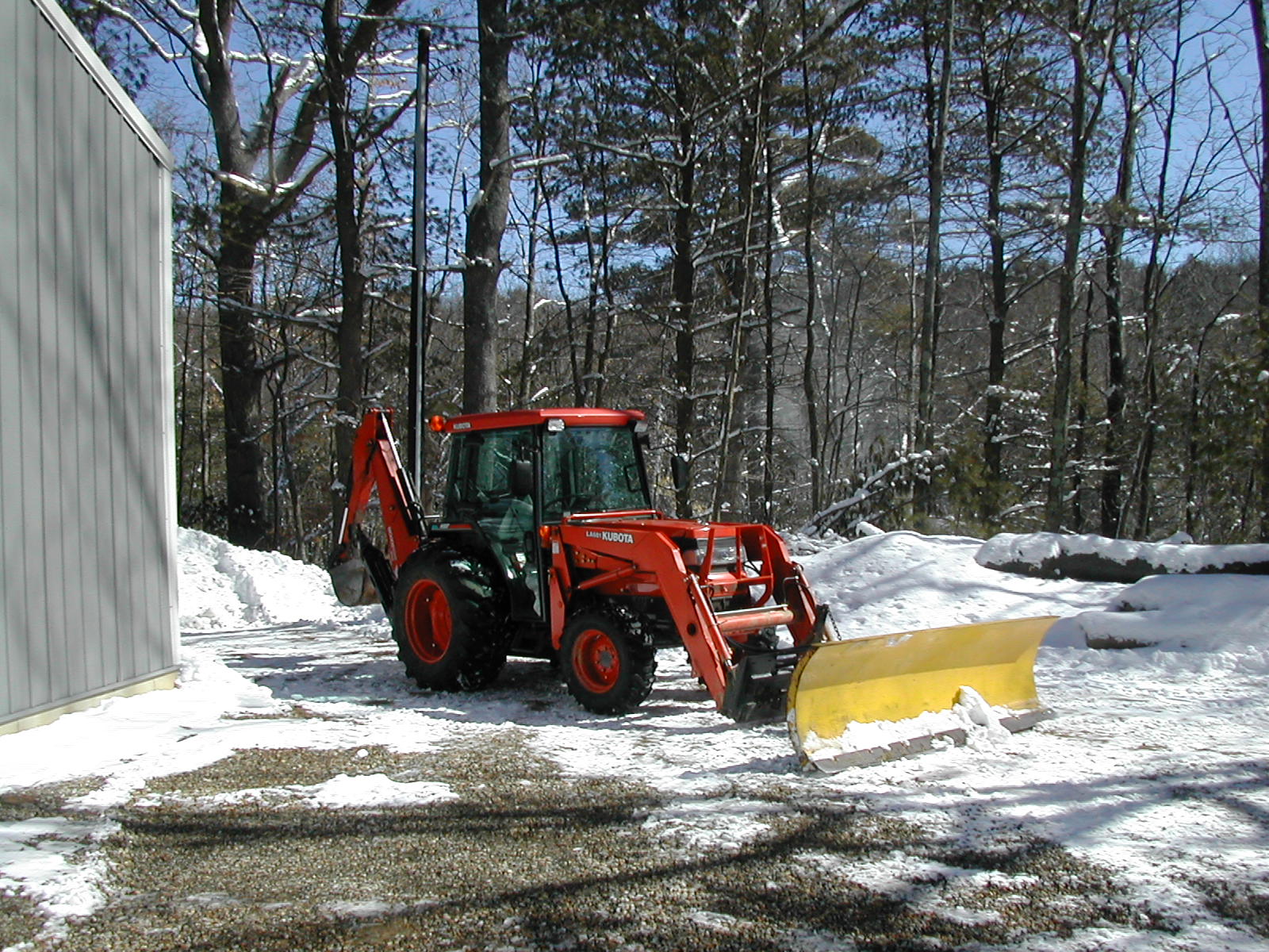

Good Afternoon Mike,
That plow arrangement came out very nice !
We have white out conditions here, your welcome to come try out your new setup up this way ! :rolleyes::)
Scott thanks for the compliment and the kind offer. However I think I'm just gonna sit here in Ohio and wait for the snow to come to me. :rolleyes:
