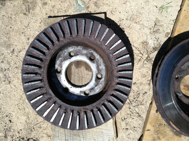

Rust seems to eat the rotors if you are in a state that uses salt/chemicals in the winter. I helped a buddy change his rotors last week because his truck sounded like a B-26 bomber flying over at 100 feet. The inside of the rotor was completely missing and the piston was out so far that it was cocked to the side.

That's the worst I have ever seen. Looks like he should have realized he had sticking calipers way beforehand.

The brakes had only been making noise for a few days and I think the inside of the rotor shattered and fell off while he was driving. The piston cocked sideways because it was almost all the way out and what was left of the pad (steel backer plate) wasn't grinding on the rotor vanes parallel.
