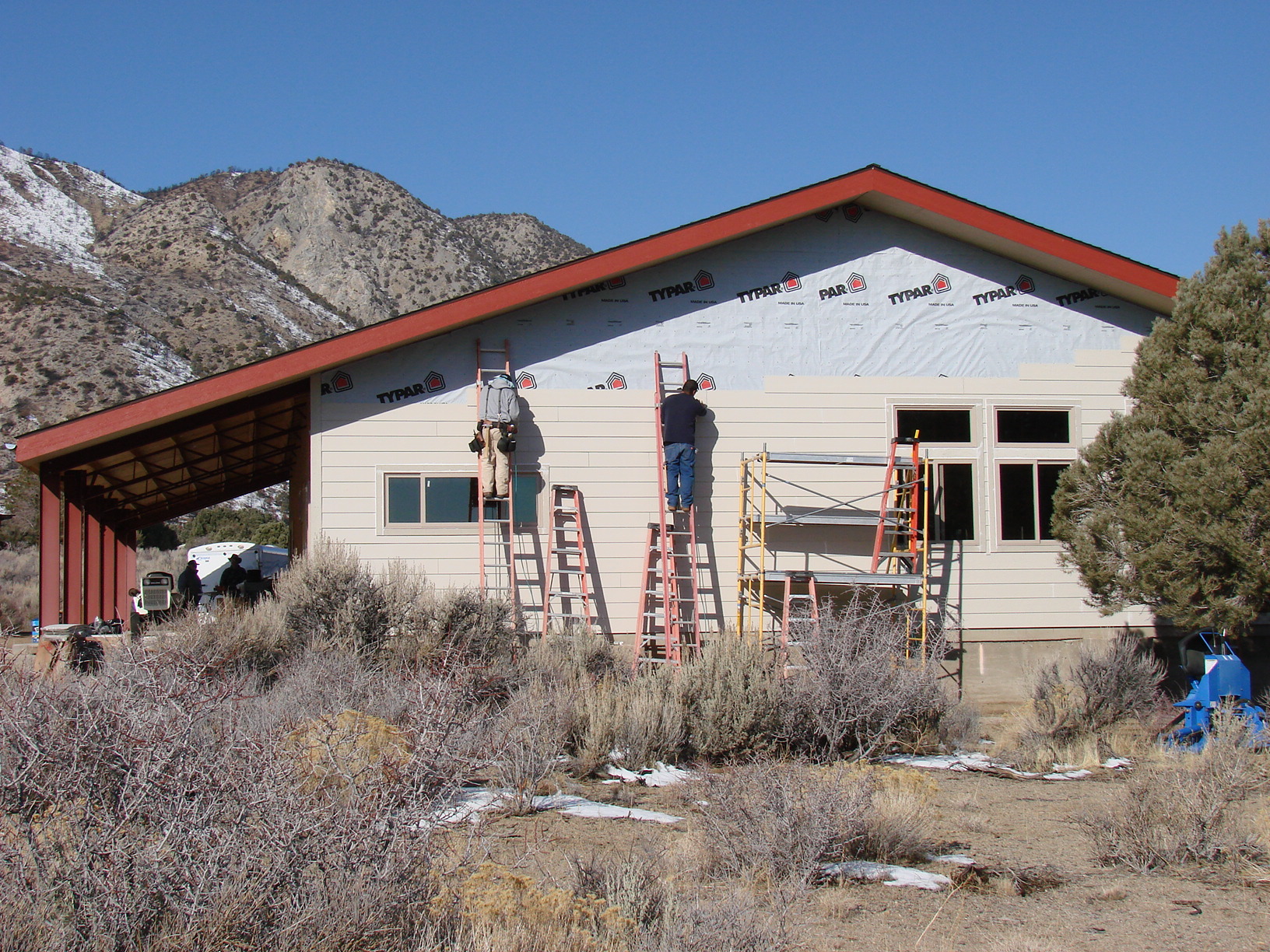

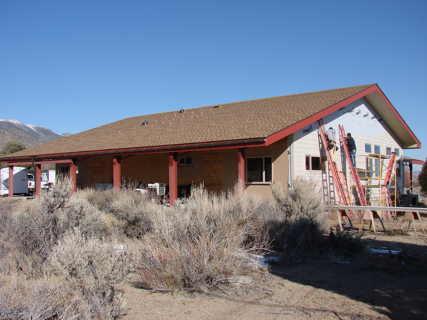

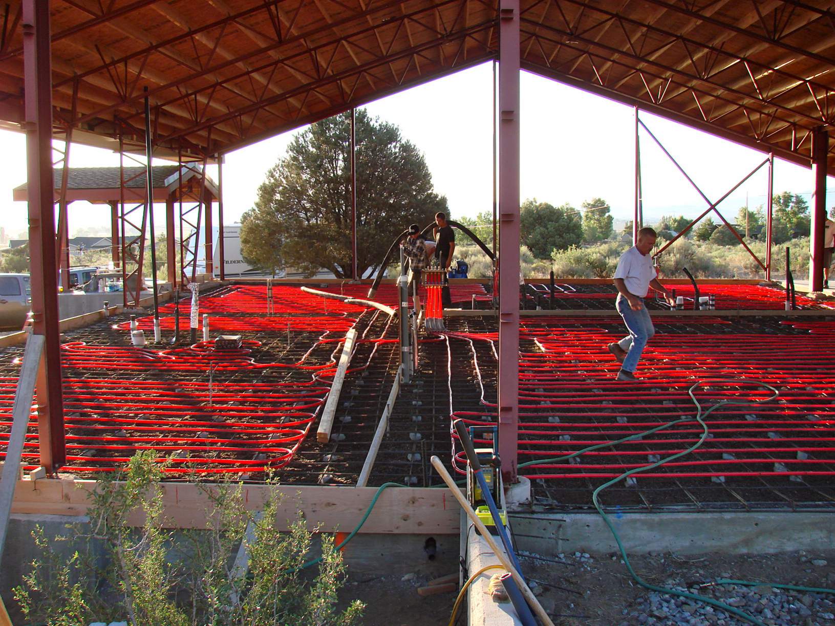

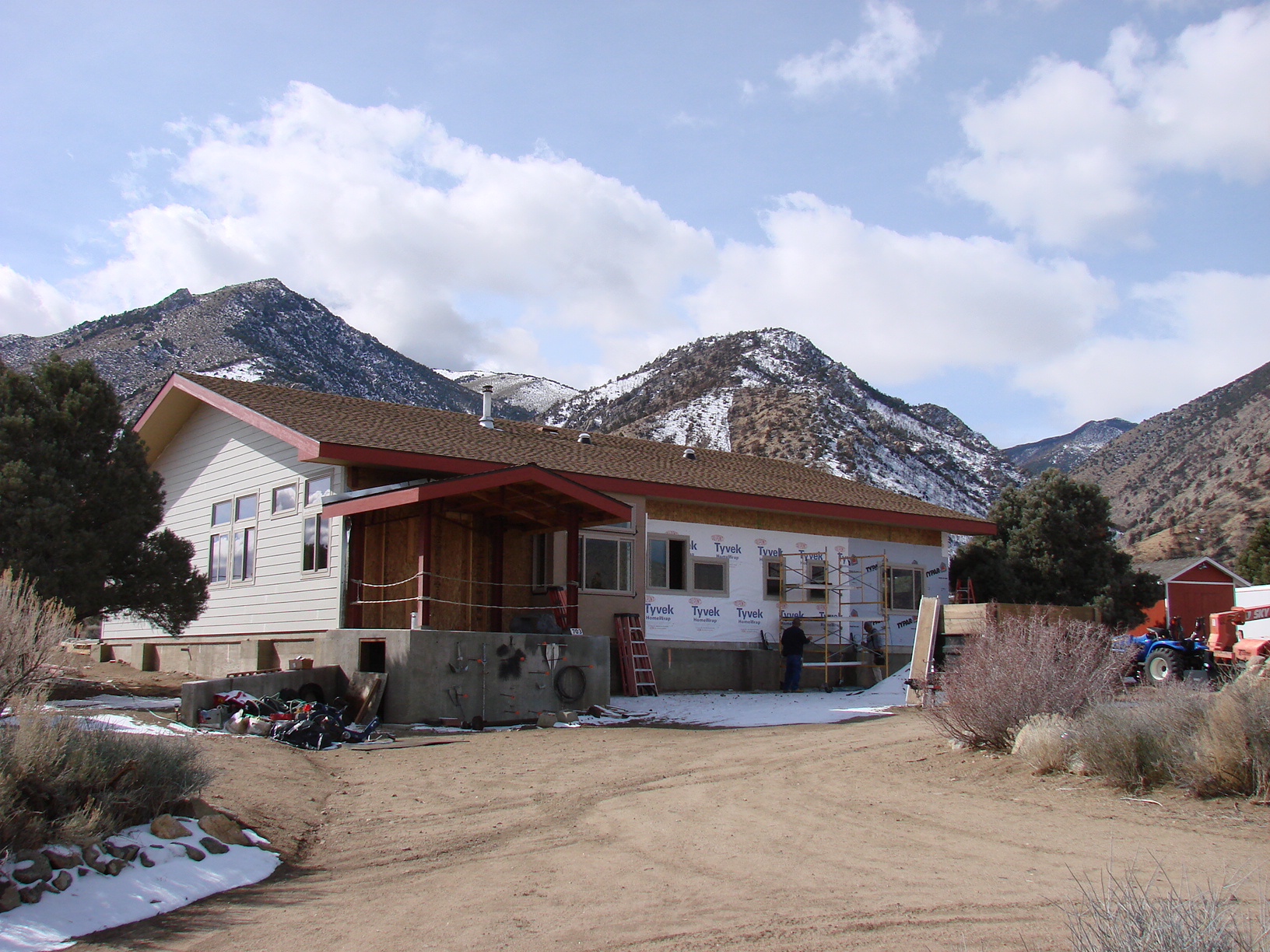

I really like steel construction.
Here are some pix of my project. I started with a 48 X 60 steel frame with a 12 foot extension to get 60 X 60. Then added a 14 X 14 roof section in front for an entry porch. I finished it out as a two bedroom, 2 1/2 bath home with a 700 sq ft back porch. The garage portion is about about 30 x 36.

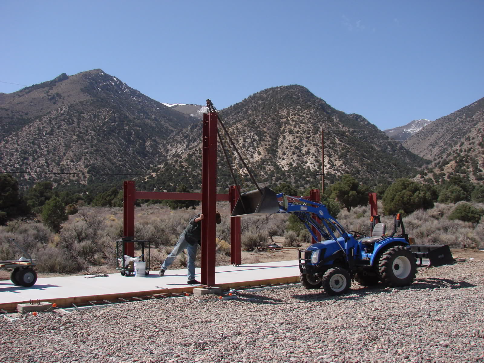

I bought a Skytrak to do the project. It's the perfect tool for setting the trusses in place, standing up the end walls and for doing the roof. I built a work platform for it and was able to take up the purlins and a couple of guys to set them, then the roof sheathing and the packs of shingles. Next will be the solar panels. The vertical posts were all set with my tractor and the rig in the previous set of pictures. It's just a simple A frame, set in the bucket and held with chains.

I went with rigid box bracing instead of diagonal wire bracing to allow windows and an unobstructed back porch. Then I sheeted the whole structure with 5/8" OSB and that made it far more rigid than the original design. The seismic and wind load design gets transformed when you sheet the roof and the walls, and add interior framing. What was once designed to be wires under tension and rigid horizontal box stiffeners, etc, with a little bit of
"spring" or "flex", becomes very solid with the 5/8' sheeting and the roof membrane of 7/8" OSB. The roof can't peel off starting with the eves because they are made of steel structures bolted to the maim posts. Extremely strong and won't sag over time.
The roof was originally designed to be metal directly on the purlins, but I put two layers of 7/16" OSB and then a composition roof. This allows a very tight structure and a way to insulate with R38. It also allowed the installation of bolted down solar brackets and foot traffic.

Raspy, I like that radiant floor heating you put in. That's not a bad idea for the winters here in VA where I could use an outdoor wood stove to heat the water...hmmmm
