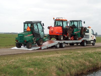

What you guys need is a folding trailer: it combines the advantages of deck-over and tiltbed.
Minor problem i see, is that you guys dont run air compressors for the brakes in this trailer class, so you'd have to install an electric over hydraulic pump to lift the rear end of the trailer to travel height. On the trailer in the picture, its done by air bellows, the same ones used for the axle suspension.
