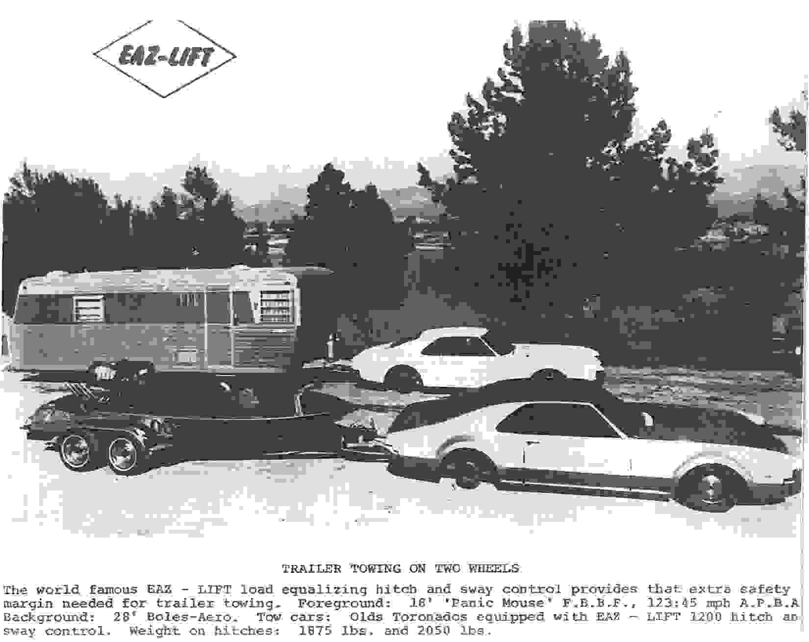

There are many ways one can try to explain that of which is not easy to explain. With my understanding of how a WD hitch and all explaination that I have seen, I can understand where they have come from. But I guess a picture is worth a thousand words, even if the picture in all reality shows what should not be done /forums/images/graemlins/blush.gif. I had found on CountryByNet where Bird has referenced this picture. I just happened to be working with a guy that had a copy of this today... Just after I saw this post.
Kurt

Yep, I'm a licensed engineer as well. Was into structural but now more site development type stuff.
I had forgotten about this thread. All kinds of excitement. I still recommend that you find the ratings of your equipment and follow them. On my factory equipped tow vehicle, a W/D hitch is required if over 500 lbs of tongue weight. Just the way it is, the load bearing style of hitch shown in your early posts is not WD so is not appropriate for pulling a 5000 lb or heavier trailer with my pickup. Most pickups are similarly equipped and all should have ratings posted on them somewhere.
Then there are all the bonus benefits of using WD including some safety improvements like positive front axle loading.
I think and hope we all agree that the truck/hitch/trailer combo should all work together as a system and no one part of it should be working beyond the listed ratings. If you ignore the ratings, well, you deserve what you get.
