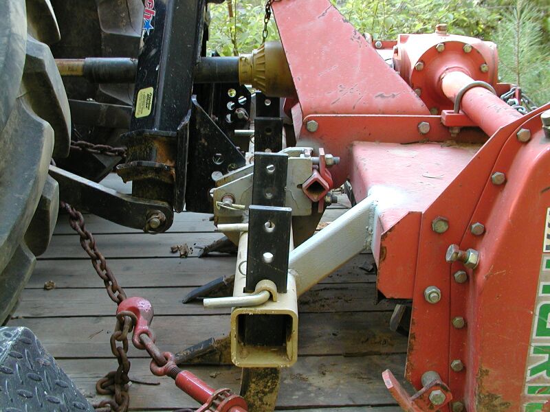

Mutt - I used to have problems from time to time in really hard stuff with the tiller wanting to walk on top, instead of digging in and really chewing it up. Perhaps a reverse-till machine would do better in that situation, but there are other issues, there, too.
With the scarifiers, it's the best of both worlds. I've never seen a situation yet where they were a disadvantage - sometimes I want them deeper than the tines, others about the same depth, but I've never wanted them up "out of the way".
They'll pull up big rocks, or even stop the tractor if they run into something really big - and I'd a lot rather find something like that with the scarifiers than the tiller (you haven't lived until you've had a 900-pound tiller hopping up in the air banging away on a huge rock like a flamenco dancer!).
But the biggest advantage of them is that they break whatever you're tilling up into "bite-size" pieces, so the tiller can make short work of them. One pass will usually till up most soils as well as two passes used to - a real time saver. I've had some real "flop" modifications, but this one has been a huge success.

How about a couple of shots of the enhancements you made (not on the tractor)?
What and where did you get the materials to build the rig?
I was wondering about the tiller wanting to "dig in" with the angle you have on the scarifiers. The previous post helps but I have trouble picturing how the scarifiers actual work.

The scarifier is a scarifier bar that can be purchased separately from Landpride. It comes with a three-point-hitch on the front of it and a three-point "receiver" on the back. It's made so you can hook it up to a tractor, then put a blade or rake or whatever on behind it. I couldn't use it that way, of course, because the PTO shaft had to go through. So, I cut all the three-point-hitch stuff off the top of it, which left me with just a scarifier bar. If I had it to do over again, I'd try to find an old beat-up box scraper and cut the scarifier bar out of that.
As to function, if the ground is pretty soft, it can have a tendency to pull the tiller down a bit, but this is easily controlled with the angle of the teeth via the top link (especially if you have "top and tilt"), and by raising the scarifiers a notch. I've really never seen it want to do that to any objectionable degree but once. And it was easy to overcome. If you had to, of course, you could raise the scarifiers all the way up, but I've never seen a reason to.
When you're pulling the scarifiers through really hard ground, there's a fair bit of pressure against the top link, of course, which tends to raise the tiller out of the ground unless the top link is adjusted to the right length (again, t-n-t helps a lot here), but the pressure against the top link is still less than it would be with a box scraper, because of the tiller's added weight.
Does this answer your questions about how the scarifiers work?

Terry - I'll work on the pictures, maybe tomorrow. Keep in mind, too, that, to get a scarifier bar the right length, you might want a box scraper a little wider than the tiller. Ideally, you want a tooth just about centered on the tines on each end, with the rest of them equally spaced between them. It's not super critical, but, ideally, you'd do it that way. As the saying goes, if you're going to go to the trouble to do it, you might as well do it right...

Dan L - That's one of the beauties of having the scarifiers on the tiller: The tiller is helping helping you push the scarifiers. Now, I doubt that the engine power, once converted to PTO power, transmitted through a shaft, then another gearbox and chain or gear drive, is going to be as efficient as applying that power to the wheels, but the limiting factor on most CUTs when pulling ground engaging implements is traction not horsepower. So using some of that horsepower that you really can't get to the ground anyway to turn a tiller that will push the scarifiers while the tractor is pulling them makes for an excellent combination. Plus, you save a lot of time by doing it in one pass. At least, that's been my experience. YMMV.

Re: Tillers w/scarifiers
Terry - Here's a pic of the scarifier mod to my tiller, as promised, though a lot later than promised...
