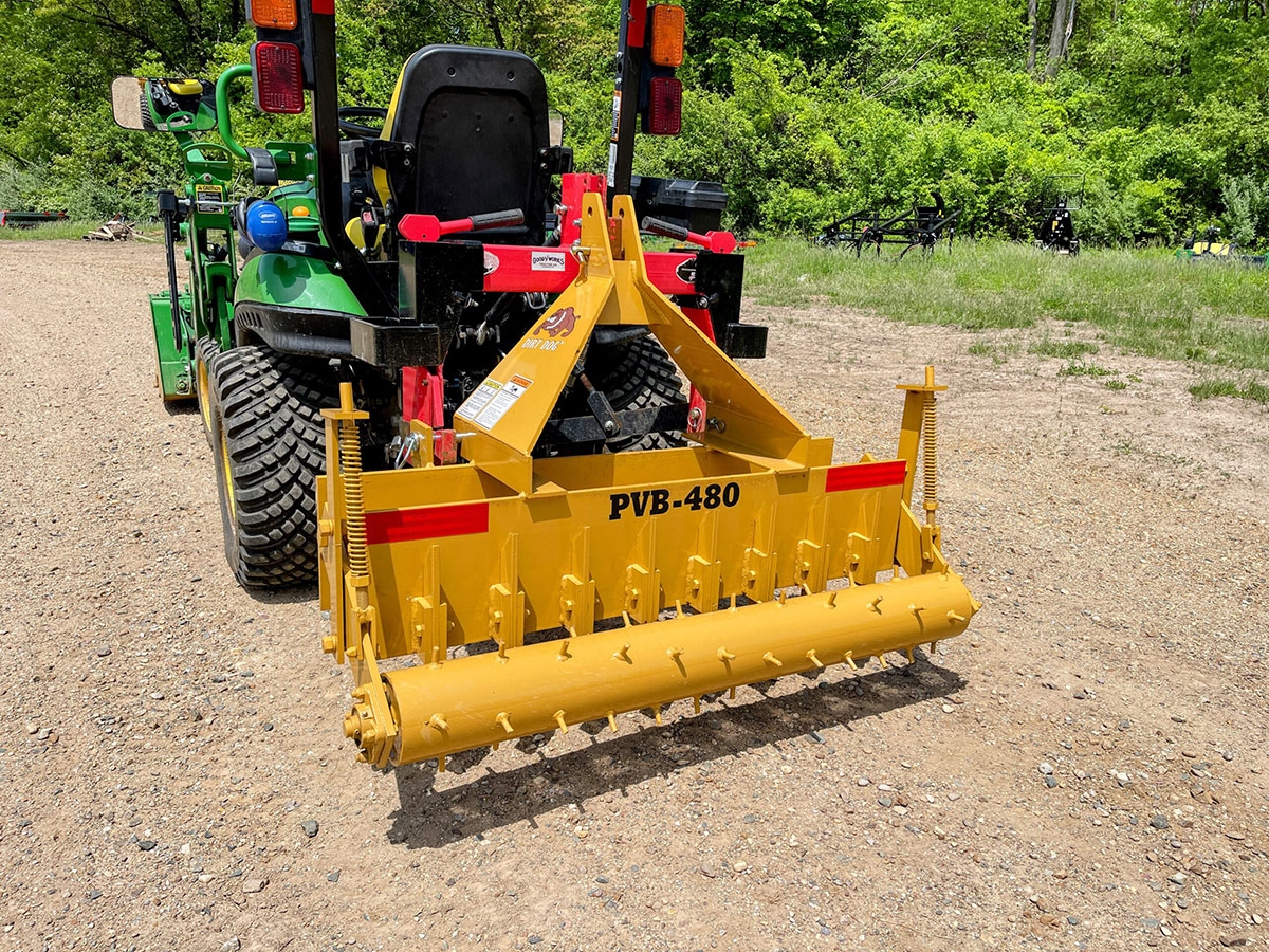

Revisiting this a year later..
In the last year I picked up a 6ft pulverizer… so my thought is to use it to soften up the dirt.. then till it.. that should be a good means to prep it for grass..
Thoughts?

If you keep an eye on the tines to insure they are rotating and the clutch to insure it isn't smoking I think you can do it. Especially since your tractor has the ability to set the PTO speed outside of engine RPM.

#18
What is a pulveriser???
I am in a different country and have found that US terms are frequently differnt to those in my country. ie US = disc harrow wtf???
To me discs and harrows are 2 completely different cultivation tools with 2 diffferent jobs.
This is a pulverizer

if you know you have more power than an implement will take... just take it easy when using the implement.
Even though when engaged your tractor will turn it full RPM and you can pull 5 mph just don't do it. Keep your speed down and be kind to the tiller and all will will be fine.
   / Tillers and PTO HP #20
RadarTech, I have never seen an impliment like that before.
