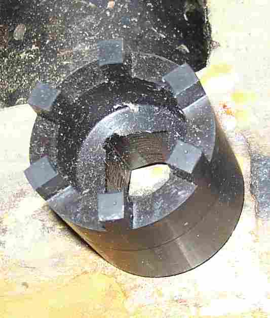

Bob, Just thinking real hard, I have come up with a tool you can make up in about 30 min. Take an impact socket the size of the nut and use a Dremel tool with a cutting disk, and carefully cut out corrosponding groves or notches in the impact socket, and you will have a socket very similar to PT's special socket. Use a half inch socket.

BobRip did you happen to ask them how much that socket was to buy your own ? You might be able to get one from an auto parts store. Hope you get the tiller going wothout too much trouble.
/ Tiller seal replacement #23
Toy, I looked on the Internet, and found a similar sockets for around $30.

Toy,
PT said they have the socket made special and they charge about $60. I also thought about making the socket. When I receive the socket I will decide if I want to attempt it. My luck the next time I need it it would be misplaced. PT's socket loan program is a good deal if you buy the bearing and seals from them.

The deposit on their socket was about $60 (if my memory is good, which it is not). They did not recommend that you buy it. It's up to you of course. I normally prefer to own and not rent, but in this case with only one tool that uses it, I did not think it was worth it.

I'm guessing the reason they have them made special is to get the maximum blade width [i.e. socket ID & OD]. Still a heavy socket [I think J.J. noted impact] might be thick enough.
I'd think it'd be real easy to make from round stock (probably make a male "nut head" instead of a female square for economy), but even without the broaching [for a square hole] operation, by the time you pay a machinist to heat treat it, PT's $60 probably isn't bad. And if they're available somewhere for $30 better yet.
