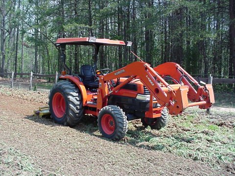

I tilled in the red clover cover crop on my garden today. 72" KK tiller and L 4330 HST @ .8 mph 1st pass after one pass with the disk pulled behind my Oliver 550. Having two tractors and the right implements sure make the work a lot easier and a whole lot of fun! I don't think you can go wrong with ether tiller you choose.
