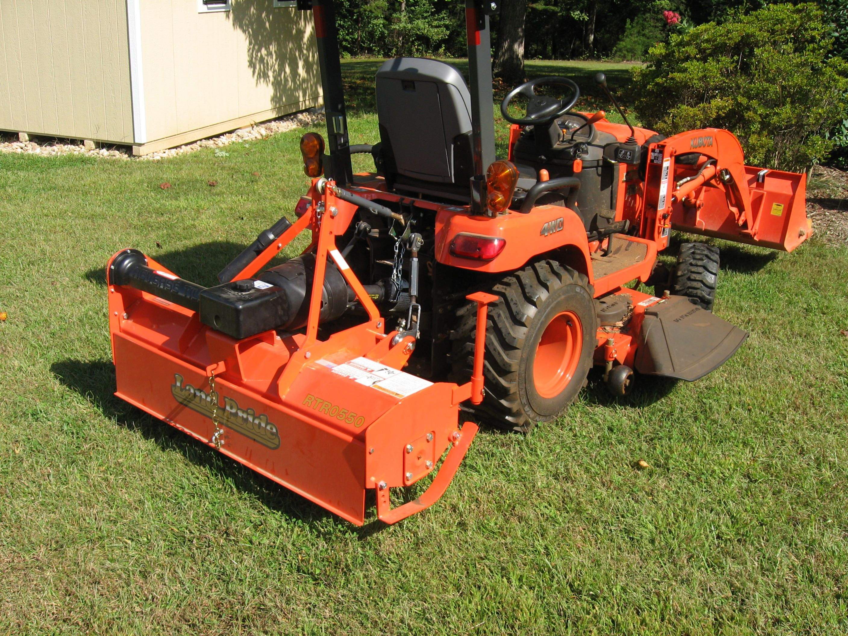

I ended up buying the Land Pride rtr0550 today. Deciding factor... it was orange!
Bought from the same dealer that sold me the BX2660 almost exactly one year ago; felt comfortable with the dealership.
Picture soon before first use.
Thanks for all the advice.

It works GREAT!
