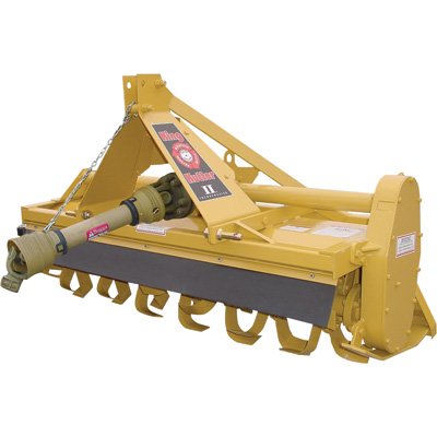

That seems to be a pretty light duty tiller in my opinion weighing in at only 525 pounds, featuring only 4 blades per flange and a chain drive. On the Bush Hog website, it says that a slip clutch is optional. I believe that a couple of the best tillers on the market for the money is the King Kutter II and the Phoenix T10-74" model. Both of these gear driven tillers feature 6 blades per flange, weigh over 700 pounds, come standard with a slip clutch, and are in the same price range as the Bush Hog you mentioned(brand new from the factory). Our tillers ship free to a business or supporting freight terminal within 1,000 miles of Newton, NC. If you're outside the free shipping zone, freight is generally very reasonable. Click on the links above to see the details, prices and product videos.

The ones on our website are forward rotating however they do make a reverse rotation tiller for about $150 more. Some people like reverse, some don't. Reverse rotation tillers are known to pulverize the soil very fine so it is a disadvantage in our red clay here in NC. If you till it too fine here, you have red concrete after it rains!! With a forward tine tiller, if you want your soil finely tilled, just lower the tailgate and go slower or make more passes. Here's a pic of the reverse rotation tiller:
