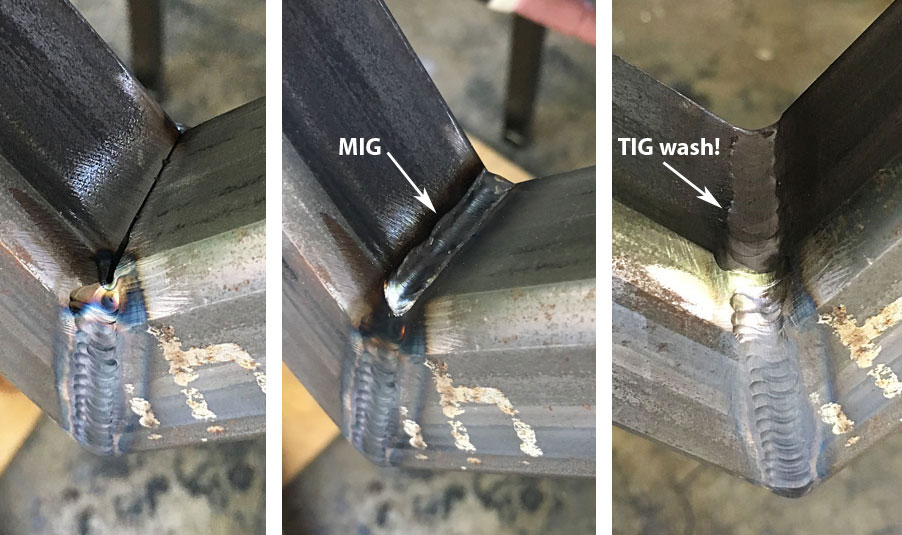

Well I can't believe I'm the first to do this, but maybe the first to post it?
This is probably illegal in 17 states (but common in Canada etc :D)
524895d1508130582-tig-washing-mig-welds-tigwash1-jpg
Since I'm no good at holding filler rod I welded this with the MIG
then whitewashed it with the TIG, & doesn't it look nice?
It's a stair railing.

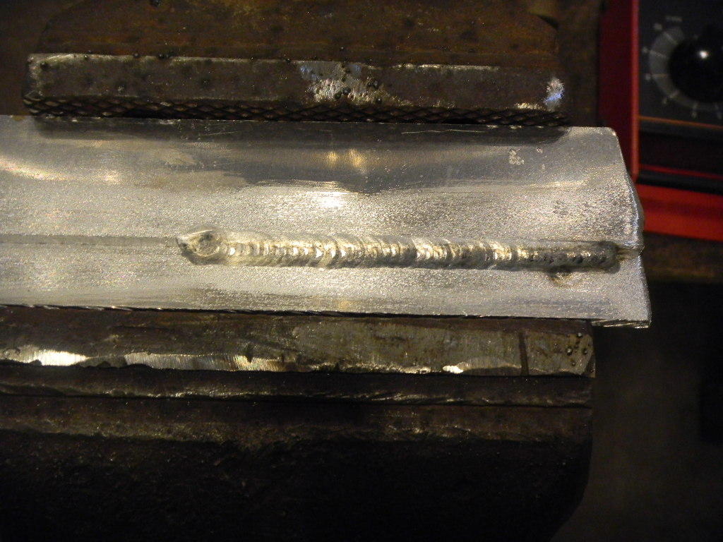

I've "fixed" other folk's aluminum welds this way.
Interesting.... I hadn't thought of doing it on Aluminum. So if I welded some Aluminum with my DC wire-feed, and lets just say a bead (just one, of course), is "unattractive" in a 'visible' location. Kind of like me when I go to into town. Can a DC TIG re-melt aluminum beads and pretty them up? I don't have an AC TIG (but I'd like one!)
/ TIG-washing MIG welds #6

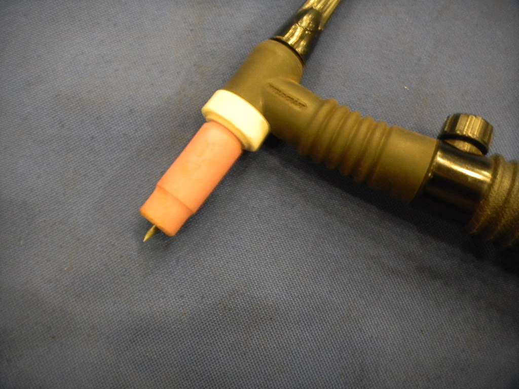

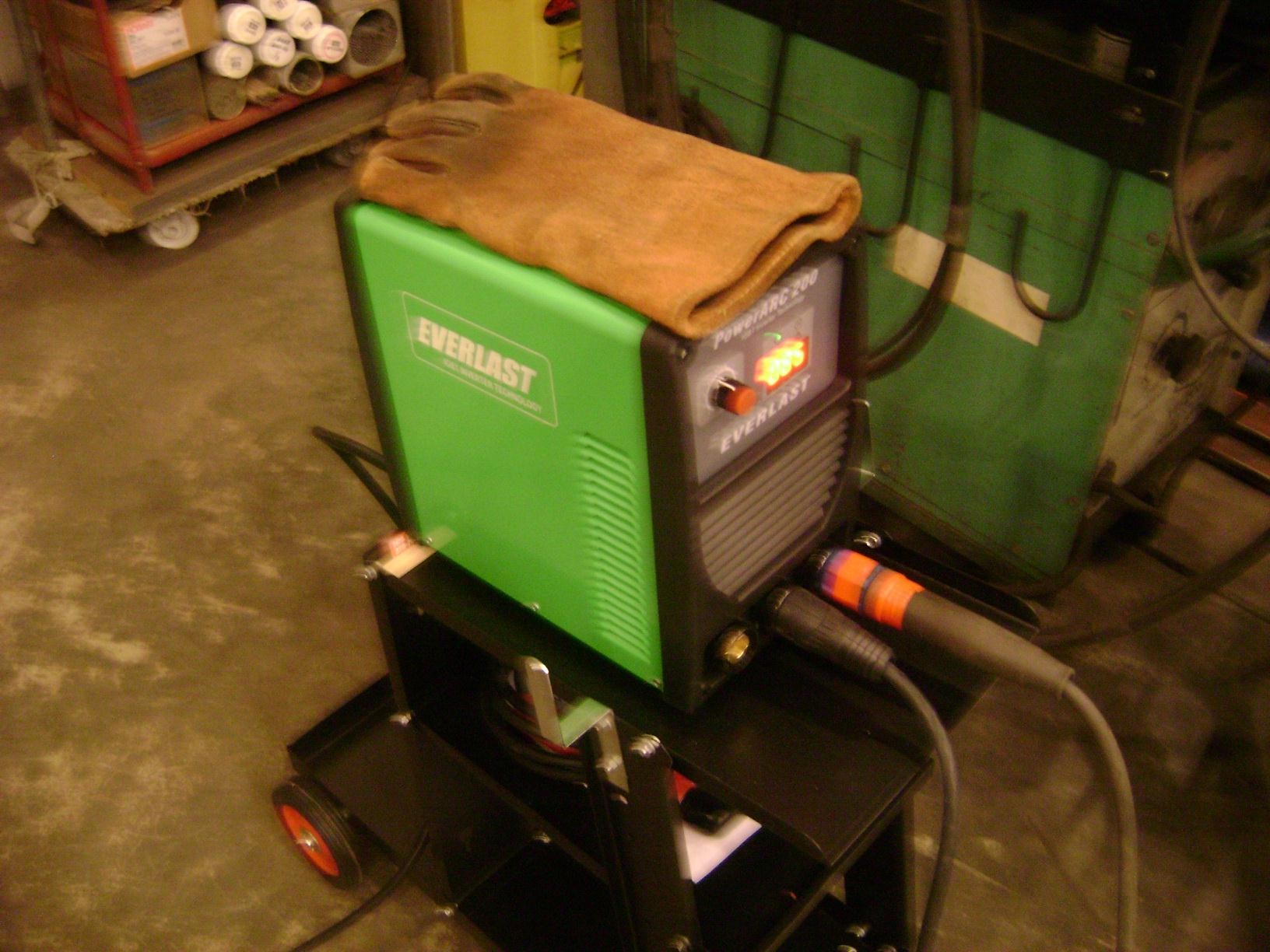

This aluminum weld was made with my Everlast PowerArc 200, DC / CC only welder. With an air cooled Tig rig.
If I can get my welds to look like that I'll be happy. Did you JUST get done with that?
What's it look like (if you pretended you didn't like the look of it) and went over it again with the DC TIG?
That is,,,,, if you don't mind furthering the education/debauchery in TIG-washing.....:eek:
/ TIG-washing MIG welds #8
That weld was done years ago. I gave the Everlast PowerArc 200 to a friend.

Yep, On a Larger scale this was known as "Toe Dressing" or Tig Dressing". Often a Large amp Tig setup or more commonly a Plasma Welder on a Robot or Track would fix multipass welds to smooth and eliminate voids and or porosity. Common in heavy mine equipment and shipyards. I used sell a lot of this stuff to those folks.

OK thanks for that background. It was so dang easy I couldn't believe I'd pioneered something in a field as old as welding.:thumbsup:
Wonder why you don't hear more about the method (treatment)? Seems to me like relieving porosity is good, and it might reduce stresses too. Is it one of those slippery-slope kinda things, that can fool an inspector (or armchair inspectors)? Where a trained eye can't miss it and then suspects you're hiding something?
/ TIG-washing MIG welds #13
The impurities, voids and porosity were normally found by X-ray. After enough X-ray's showed the issue, They started Toe Dressing all of the heavy multipass parts. It was all about liability for the big parts. They were going on ships and huge mine trucks. I wonder if they should have toe dressed the welds on the Titanic or Edmond Fitzgerald. :eek:

Never thought of the Rivets. Probably as good as anything we do today. The Toe dressing was often done with a 600 amp power supply and a 600 amp Plasma Welder torch. All Thermal Arc stuff. 6045 Power Supplies and 6A plasma welding set ups. My experience was at NAASCO Ship Yard in SanDiego and Norfolk VA. And Joy Global in Milwaukee. Seems for some reason that after 5-6 passes on 2"+ steel, You start to get voids and poor X-Ray quality welds. So they go over the last few passes and re-liquidate them to repair. Seems dumb but it's a real problem.. Loved selling them the equipment tough. So as Sodo posted, I too employed the same thing to my poor welds. I have even went over my Tig welds with a tig welder and no filler. No I'm not a great welder like most of you. I'm just a lowly sales guy that enjoys weld smoke.
