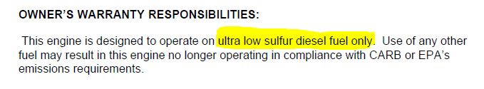

Use ULSD, run within 80% to rated rpm, dont idle around, should have no worries.
Tier 4 on a CUT is not bad because your running them hot enough doing most PTO tasks, like cutting the lawn.
Run it like a power tool and not like a museum piece and you will be fine.

Current understanding is to use road grade diesel and not off-road diesel to minimize regens.
This is supposed to more than double the time between regens - but still will have lots of regens to look forward to.

I use the road diesel and wait to fill up tanks after beginning of December and add a ounce of fuel treatment every tank.
My first re-gen was at 48.5 hrs in the middle of plowing snow. The only thing I noticed was more heat coming from the exhaust as it was melting the snow on my bucket which it did not do when not in re-gen.
This tractor gets such good fuel mileage, I'm not gonna sweat paying a little more knowing I know the diesel I get is the same as all the over the road guys are using and the T/A gets a ton of business.
