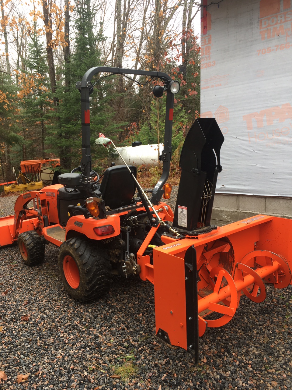

Yes I like mine, I bought a 54inch Blizzard for my SCUT two years ago. (I have a soft cab) I tried a rear blade and didn't like it for moving snow. The blower moves a lot of snow quickly and I have no more massive snow banks in my yard. Blower on one end and a loader and bucket on the other end is the way to move move IMO..

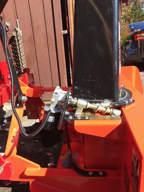

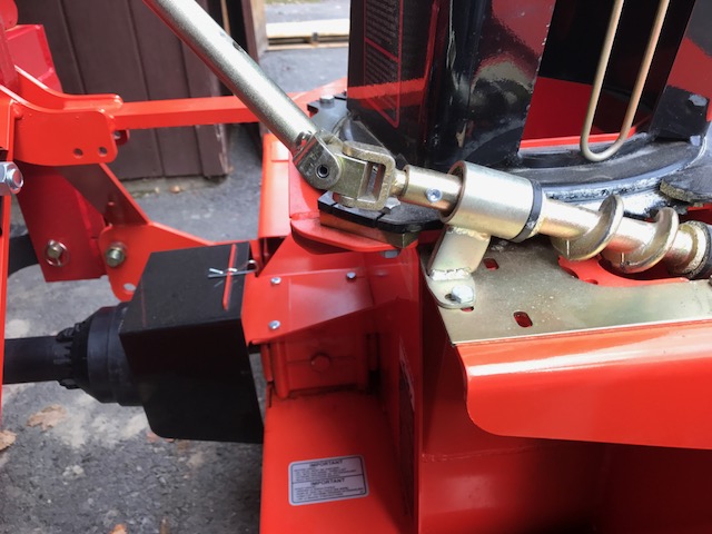

I fabricated a small electric motor to turn the chute, it's on a momentary switch, works great just have to keep grease on the gears and I use deicer before I use it so the motor doesn't strain..

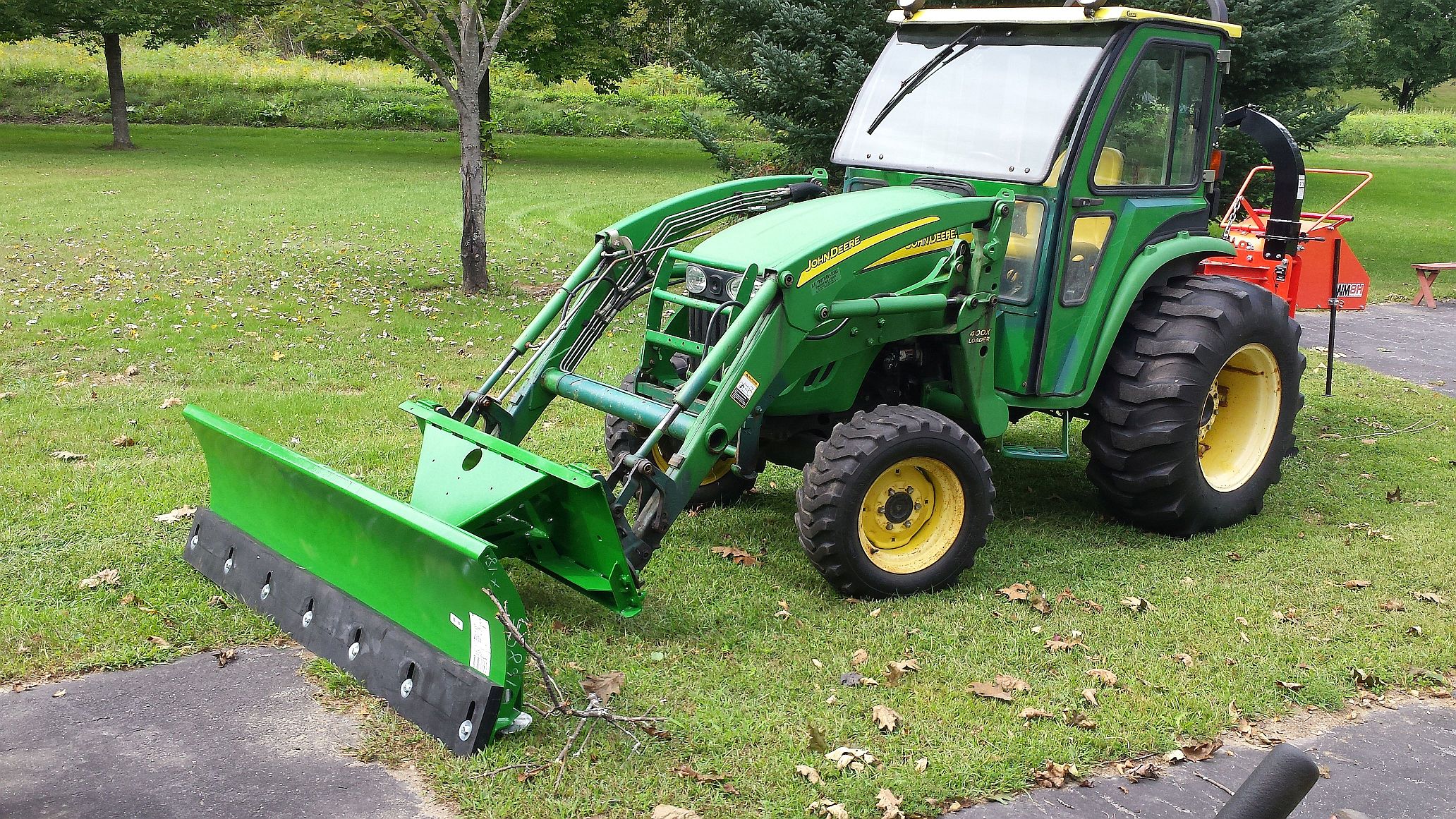

I like the way mine works, but without my soft cab and backup camera, it wouldn't be much fun. Since I built a front snow blade, I don't use it unless we get a foot or so of snow. The snowplow is much faster.
