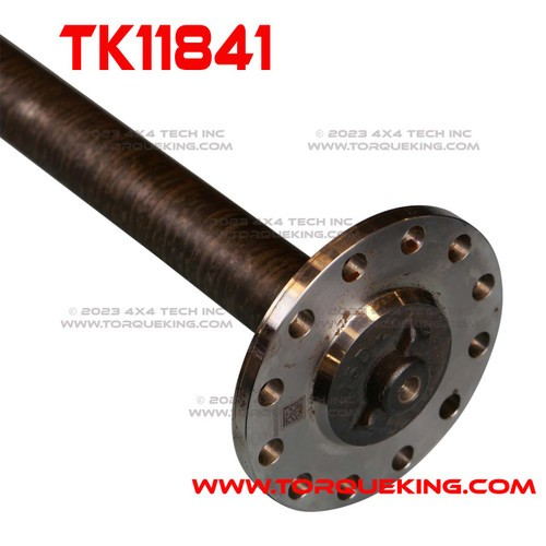

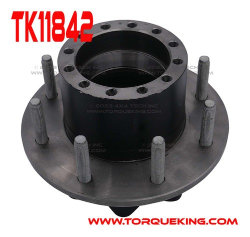

Gee, your pictures bear a marked resemblance to the rear member on my Ford F350 pickup truck I sold a few weeks ago.
   / Thoughts on towing this with what we currently have #35
OP...neighbor and their friends have big horse trailers like that. Neighbor had a F250 with the V10 gas and they had to put 2 extra leaf springs on each side to take the weight. The suspension was surly stiff but that trailer still shoved it down. They have since traded to a F350 SRW diesel and it is a huge upgrade. Some of there friends pull with trucks in the 650/6500 class too. Just say'un...a 2500 truck is a bit small for that trailer by what I have seen.
   / Thoughts on towing this with what we currently have #36

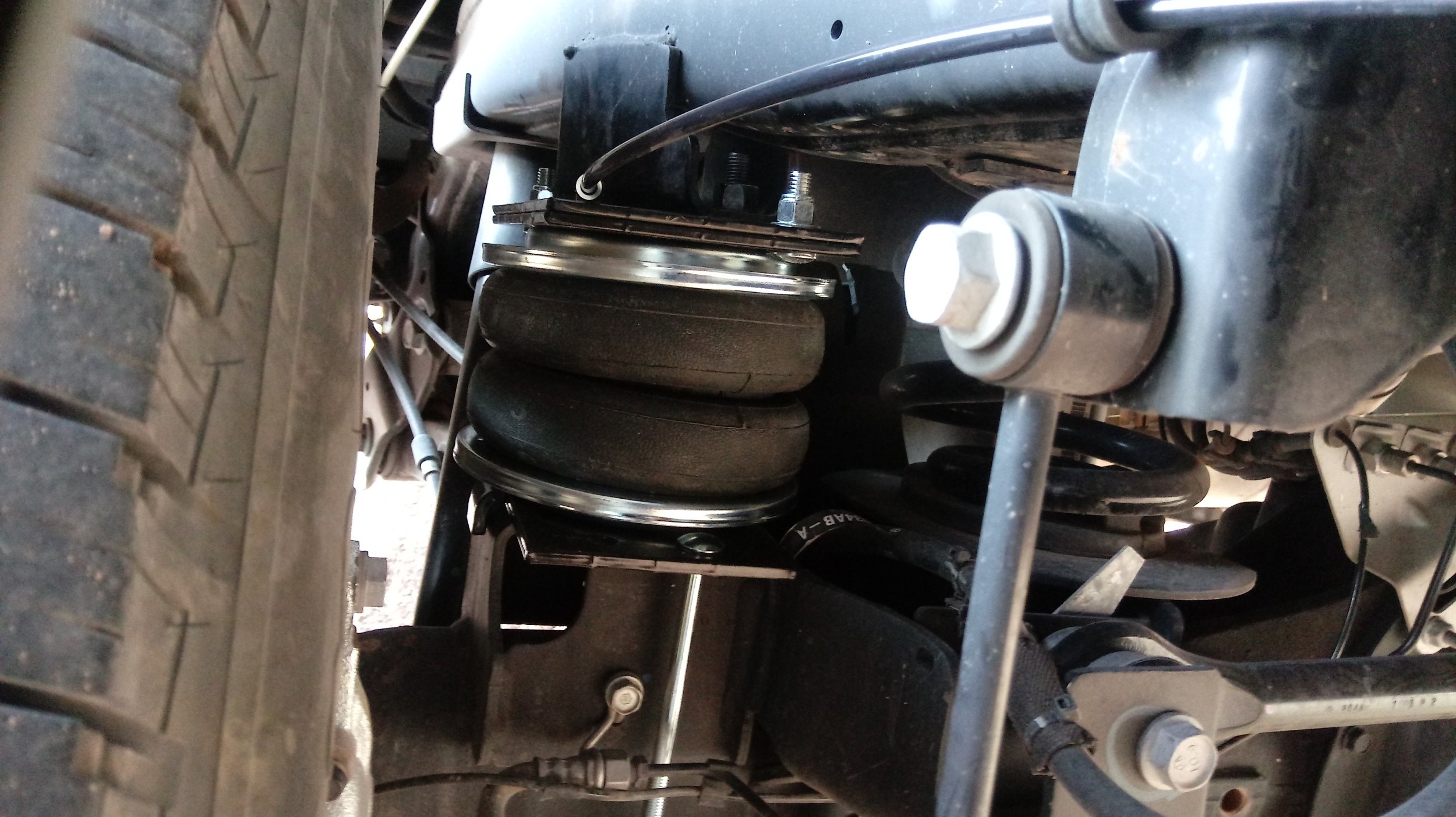

Not even close. Your '97 Ford used a little bitty Stirling axle. It might have had a 10k gvw, the same as my '21 Ram 2500. My front axle is rated 6k, match that with your Ford.
So inboard coils on the Ram 2500 and outboard air bags. Support on both sides of the frame. Shocks both mounted forward and right next to the hub, plus rear sway and track bar, don't get any better. 11.5" rear axle with 4.250' axle tubes v/s your 10.5" and 3.5" tubes, Lol
You better stay on the porch if you want to truck with me. My 2500 v/s your ex Ford-350.
