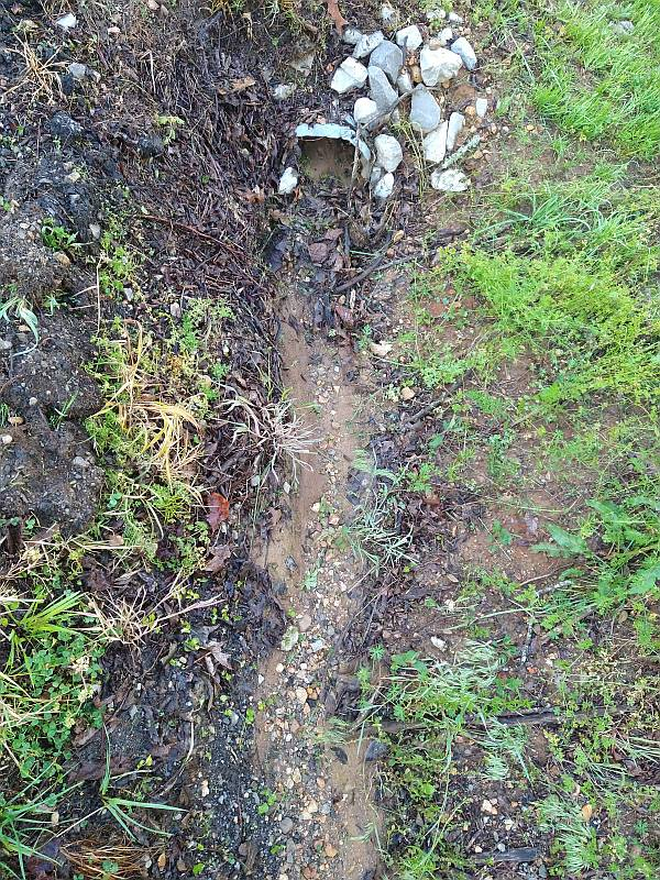

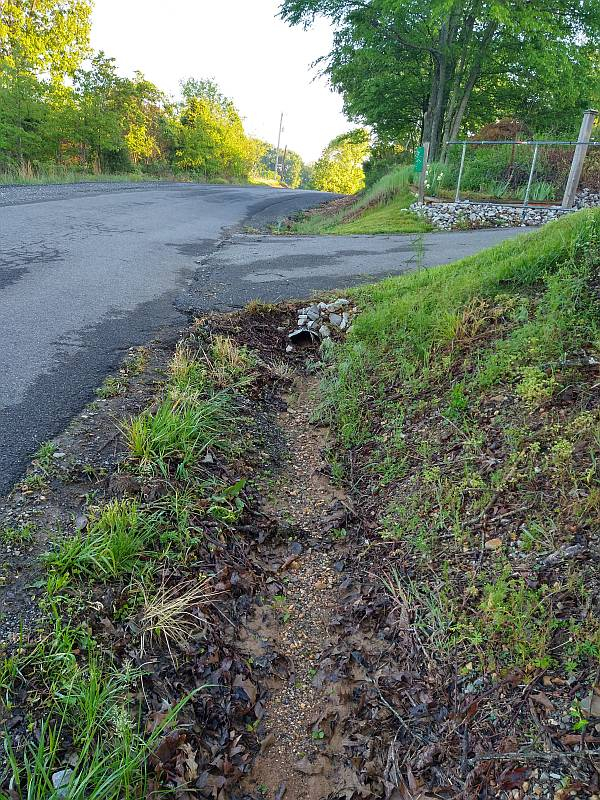

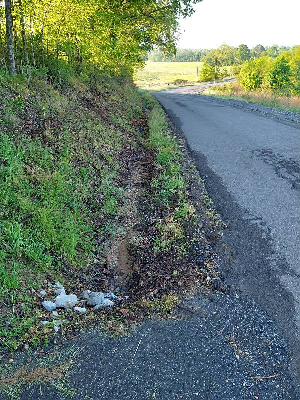

The drainage ditch along the road is getting clogged due to recent rains, leaves from last year and road work that disturbed a lot of dirt and rock. Yes, it's a county road and they should clear it and probably will ... eventually. Maybe in a another year or two or more. The 12" culvert under the driveway is about half filled, so I really don't want to wait for them to get around to it.
Due to the steep bank, I can't straddle the ditch to use the BH and get a straight pull. Obviously I can't be in the road very much.
Thought is to use the County Line 5' landscape rake and drive long the edge of the road pulling the spoils downhill. I'm thinking of removing all but the last 4 or 5 tines at the one end. That would let me settle that end into the ditch with the tineless part of the rake riding along or just above the pavement. I might even be able to swing the rake a bit to the one side. I'd have to make several passes. I have traffic cones I can set out on the crest of the hill and yellow blinkies on the ROPS, so caution to traffic will be OK.
Question is, will the rake and my little tractor be able to handle the side stress?

Thoughts on assuming responsibility for county work aside, it can be done.... just depends on how much time you have and how much material you want/need to move. I'm in the latter stages of the process of doing the exact same thing with my shop road (heavy clay in GA Ridge and Valley soils) using a BX2360 - no backhoe. It's been a slow learning process.
I've got a EA Attachments root rake and even with the swing arm and rake angle adjustment, the geometry of the up slope side of the ditch and existing ditch depth didn't really allow for the rake to get in to an effective position. YMMV (I have used the rake to pretty effectively put in swale ditches in other situations however)
What has worked, albeit slowly, is taking small bites of the up slope side of the ditch with the FEL bucket and slowly working my way down into actually removing material until I reach depth in the original ditch channel. The biggest concern, given the clay soil, is being nice to the tractor and hydraulics so as to not damage equipment. It's not ideal using a tractor bucket to ditch, but it can be done if you are careful. I did also ended up buying a toothbar to break up the soils and put less stress on the machine. That may or may not be necessary for you depending on the material you are needing to remove.
Logistically, it also takes a bit of planning, given that you'll likely have to take small bites at a time given your machine size - it looks comparable to a Bx. I've found piling those small bites at a spot further along the ditch until I have enough to run full bucket loads to the spoils site has been a huge time saver.
I'll try and post some pics of my progress later. Best luck!
** Edit - in answer to your question about side stresses using a landscape rake. It honestly depends on the soils involved and how careful you are in the process. Taking light passes with close attention to what's going on shouldn't be an issue. If you're going full power and the rake is wagging the tractor you may want to reevaluate your process. I wouldn't personally go through the effort of removing a bunch of tines.... it honestly sounds like a pain in the butt to remove and re-install most of them.

Looks like there is quite of a slope going down hill, I would clean by hand with a shovel the down hill side culvert as much as I can, like the inside of the the culvert and dig until you find the bottom of the culvert then dig the ditch @ a flat or -1% until reaching the original ground. Once water go through the culvert will eventually wash itself down. Keep in mind if you remove the grass on the side of the road you will induce erosion especially with a rake it will make the ditch flatter instead of a U shape. If a storm comes before it grows again and the county could make you responsible if they know you did it. ''just saying'' if they can do it they will, its can be a double edge sword with them.

Why not just tilt your box blade and drive down the ditch? Pull until the box is full, leave it, come back perpendicular with the front loader to scoop it up and take it away.
Why are you at all worried about being in the road if hours pass between cars coming by? I'm confused.
