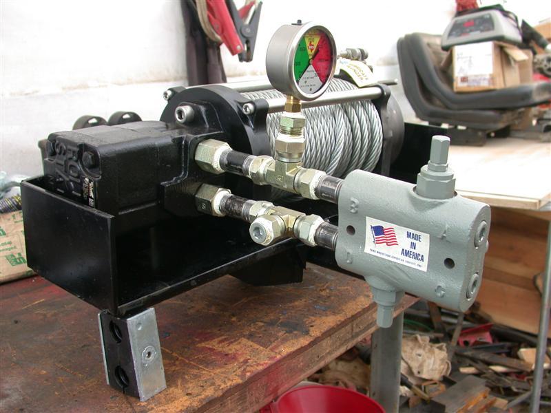

   / Thoughts on converting lawn tractor snow blower to PT422 #48
BobRip; said:
Would the PT relief valve provide this protection?
If you don't have to ever reverse the snow blower for a jam or something, then you can put a relief valve across the hyd motor. If you need to reverse, then put a double relief valve across the hyd motor. Then you have the motor pr etected both ways.

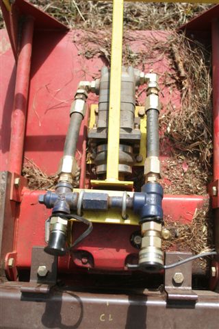

Quick update:
I have most of the conversion done. I still need to make one more bracket, and throw a coat of paint on the raw metal pieces. Luckily, I was able to shorten up the total length enough to have the chute direction lever reach far enough for the driver to operate. The tension sprocket used on the chain between the drive shaft and the auger was in pretty bad shape and barely moved. I was able to remove the seals, clean out the rust and repack some grease which seemed to fix it up. I think it might need servicing every year or so, or will have to be replaced with a better design.
I spun up the auger to test the coupler alignment and to make sure nothing flew off or failed catastrophically. So far so good, but the speed of the single stage auger is a bit scary looking at it from the front side. :eek: Total cost was $125.
I will hopefully have some pics posted soon. Thanks again for everyone's input.
