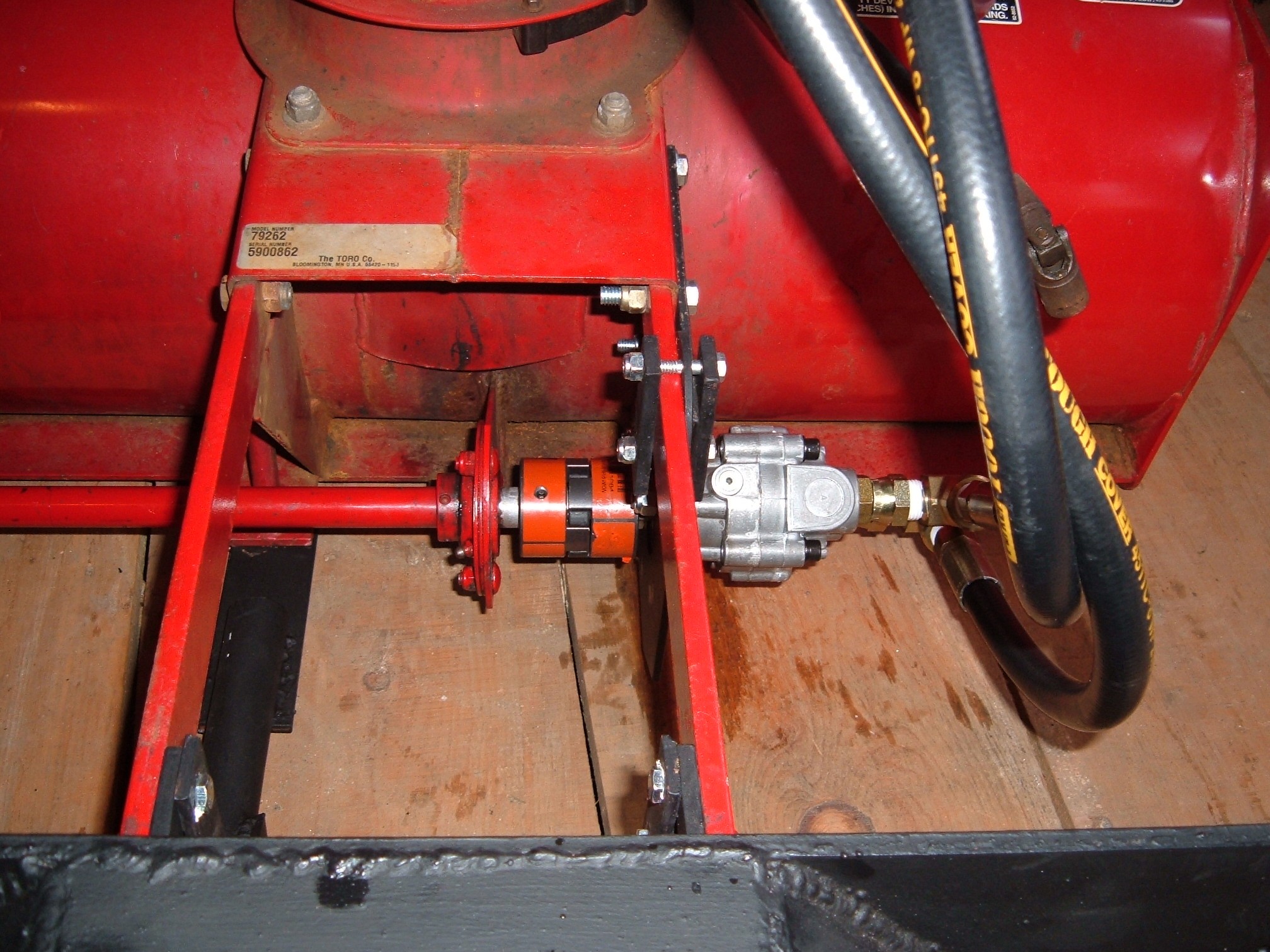

KMA, wanted to respond based my experience when I converted my snowblower. Your snowblower looks exact as mine. Here are my notes.
-Gresen Hydr motor: 0.58 = 3400 rpm (same as the finish mower)
-Gresen motor on PT PTO circuit: 9.88 Hp cont, 12.4 HP int.
-Pt snowblower with hydraulic motor turns at 1650 rpm. This equates to 5,024 fpm tip velocity of the single stage auger. This was the same as my toro-wheel horse set-up. My Toro-wheel horse threw the snow 50'
-Added a couple of pix, I went direct drive. I could have shortened it up by another 8" by mounting the quick attach right behind the motor, but did not want to ruin the re-converting back to the WH if needed (glad in the end)
Ultimately it was not enough power in deep, wet snow. I re-converted back to my 18 hp toro wheel horse (I was spoiled by the blowing capability of the WH, but wanted the traction of the PT). The bush hog 3.0 cu in motor would have plenty of torque, but not enough RPM. I don't believe it would throw the snow well and it would clog up the chute.
I wish you good luck. I don't get to the forum as much as I like, but will try to answer any questions you may have.

Looking at duane's pictures, if you wanted to go belt drive you could certainly put the motor above the shaft anywhere along the length I would think, and not increase the length at all.

I agree with coolconnection, as the HP you are developing with a 8 GPM hyd motor , at 3000psi, using the 85% efficiency rate, you only put about 13.6 HP into the snow blower, at a low torque.
Yeah, it looks like torque will be the issue with the hyd motor approach. Since I'm unsure of how well it will work, I'm trying to spend not much over $100 (inc. the snowblower). That way I won't be too disappointed. As I alluded to in an earlier post, the deep lighter snow is actually a bit of trouble for my ATV/plow. The snow falls away over top and on both sides of the blade, even though it is angled. I end up having to make multiple passes to clean it all up. If the PT snowblower works okay only in these situations, it will be time/money well spent.
