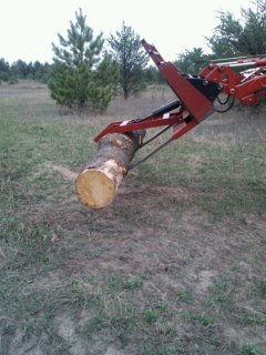

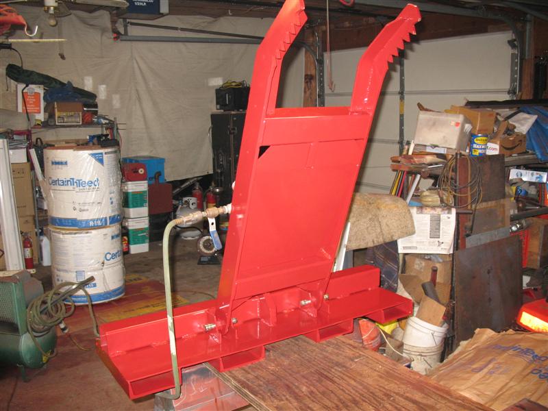

I fabricated my own fork carrier (used to be a iron worker/fabricator) and then bought 3 fork tines off ebay. By putting 3 tines it is much better at carrying small odd length stuff. I am now trying to design a grapple that will be adjustable to work on both the 48 inch fork carrier and my 60 inch bucket. There are some grapples made for forklifts such as: Tractor Fork And Forklift Mount Brush Grapple. I seem to recall a forklift grapple for around $600 but I don't recall where. Maybe with some searches you could find a budget priced grapple.

   / Thoughts on adding a grapple to pallet forks to move some brush piles? #7
Here is where I got the idea to make one.
Paumco Products; Fork Grapple, Pallet Fork Grapple
I made a small grapple that slides onto forks that has work well for building brush piles, not sure how it would work for tearing them apart.
I like it, like I said I was thinking about making one that would work on both the bucket and the forks but come to think of it, I'l probably never use it on the bucket. It looks like that is a one way ram, how do you work with that?
   / Thoughts on adding a grapple to pallet forks to move some brush piles? #8
The cylinder is a two way.
