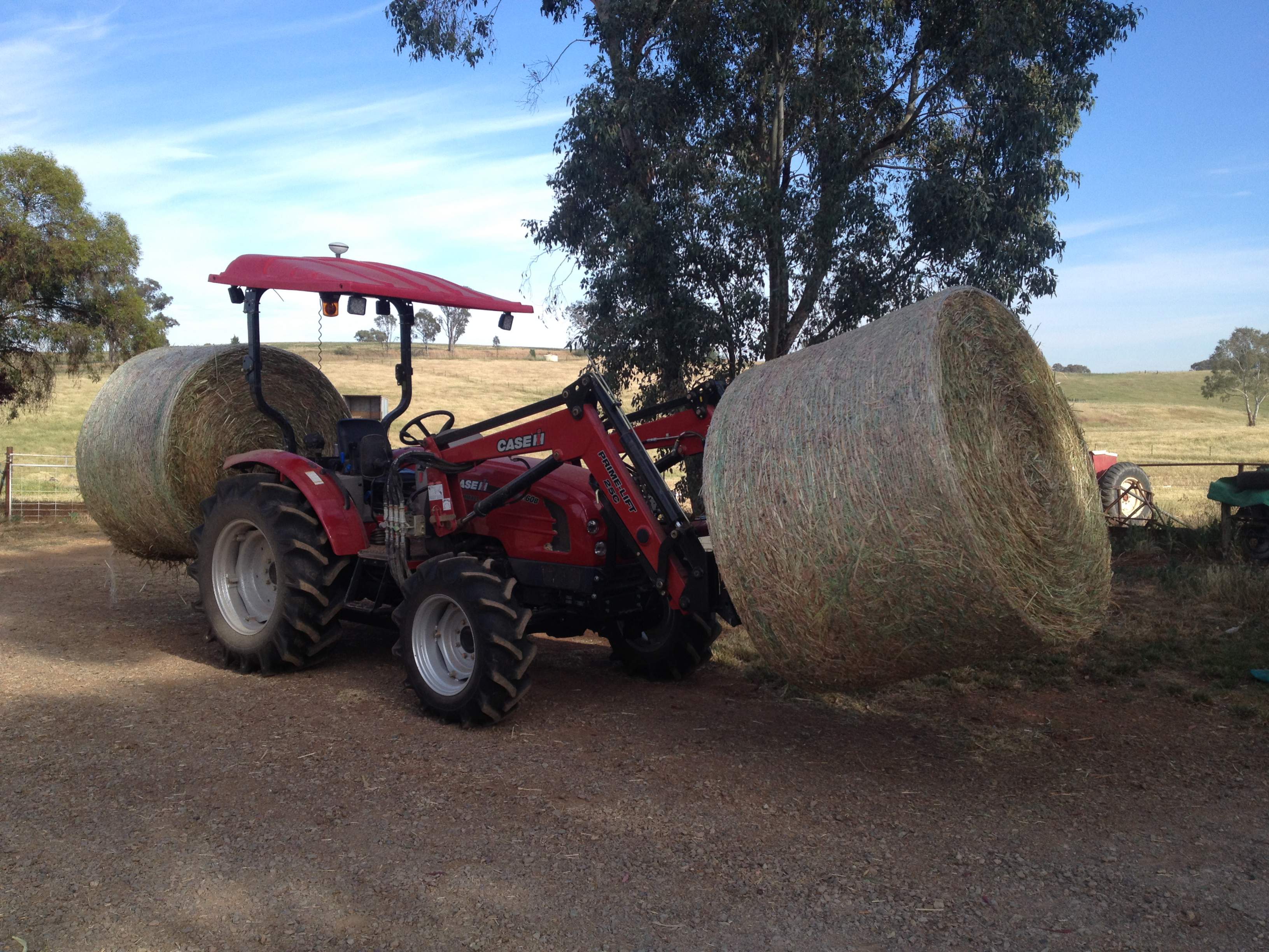

CASE IH FARMALL 60 B (Australian spec) The Little red Case has done a power of work since July, spraying, sowing,mowing, raking, baling, general farm stuff.
150 hours up, no dramas, 2 small issues, the right side power steer hose rubs on chassis rail, fixed with a sleeve of old radiator hose, and a clevis pin falling out of clutch pedal linkage, both fixed at home easily , The Case Farmall 60B (LS Mrtron) is solid and easy to live with, mowing is the toughest job (6 disk Krone AM234S) she drinks a bit of fuel, but, she is working hard, really happy with my tractor, only annoying thing is the clutch pedal is a bit close to body work, my big feet don't fit on pedal and sometimes don't get a smooth gear change.
Overall rating 9/10

Just clicked up 750 hours, and have not had any trouble, did break a bolt on left side of FEL mount from being stupid, and the front tyres have worn badly from traveling on bitumen roads,
so at 750 hours i changed ALL the oils and filters and adjusted the tappets which were on the loose side but that can be expected. The 60B has been an outstanding little utility tractor, am buying another with a cab this time to add to the fleet.
I get filters through the NH dealer now WIX didnt have a cross reference either.

I have 120 hours up on mine. I was using it all day today with a small square baler attached.
I read in one post where a fellow owner had a power steering hose chafe on the loader frame. I checked mine and sure enough the power steering hose on mine has started to chafe as well. I have manufactured a tool box for mine and welded it to the loader frame similar to how they mount toolboxes on those green colored tractors. I also made up quick hitch hay forks and I have welded various mounting points on the bucket so that I can easily attach a chain.
I also made a lever outside at the rear behind the cab that attaches to the 3PL control so that I can adjust the 3PL externally when changing implements.
One more thing I will do is wire in another light in the dash, or a warning chime for when the hand brake is on. The steering wheel obscures the red hand brake light on the dash.
One thing I see regularly with Front Wheel Assist tractors, and it relates to the wear that you mentioned on the front tyres of yours?
The front tyres (when engaged) must rotate at the same speed as the rears. So the fronts will always be scrubbing especially if they are engaged on hard surfaces. This also puts unnecessary strain on the drive line, and I suggest not having the fronts engaged unless absolutely necessary, and certainly never with the bucket loaded if you have a FEL.
The only time I have my fronts engaged is for engine braking or for pulling up hill. Otherwise the fronts are never in. The machine handles better with the fronts out and I find I get more power to the PTO. Anyway..............these are solely my thoughts and indicative of how I use my tractor.
