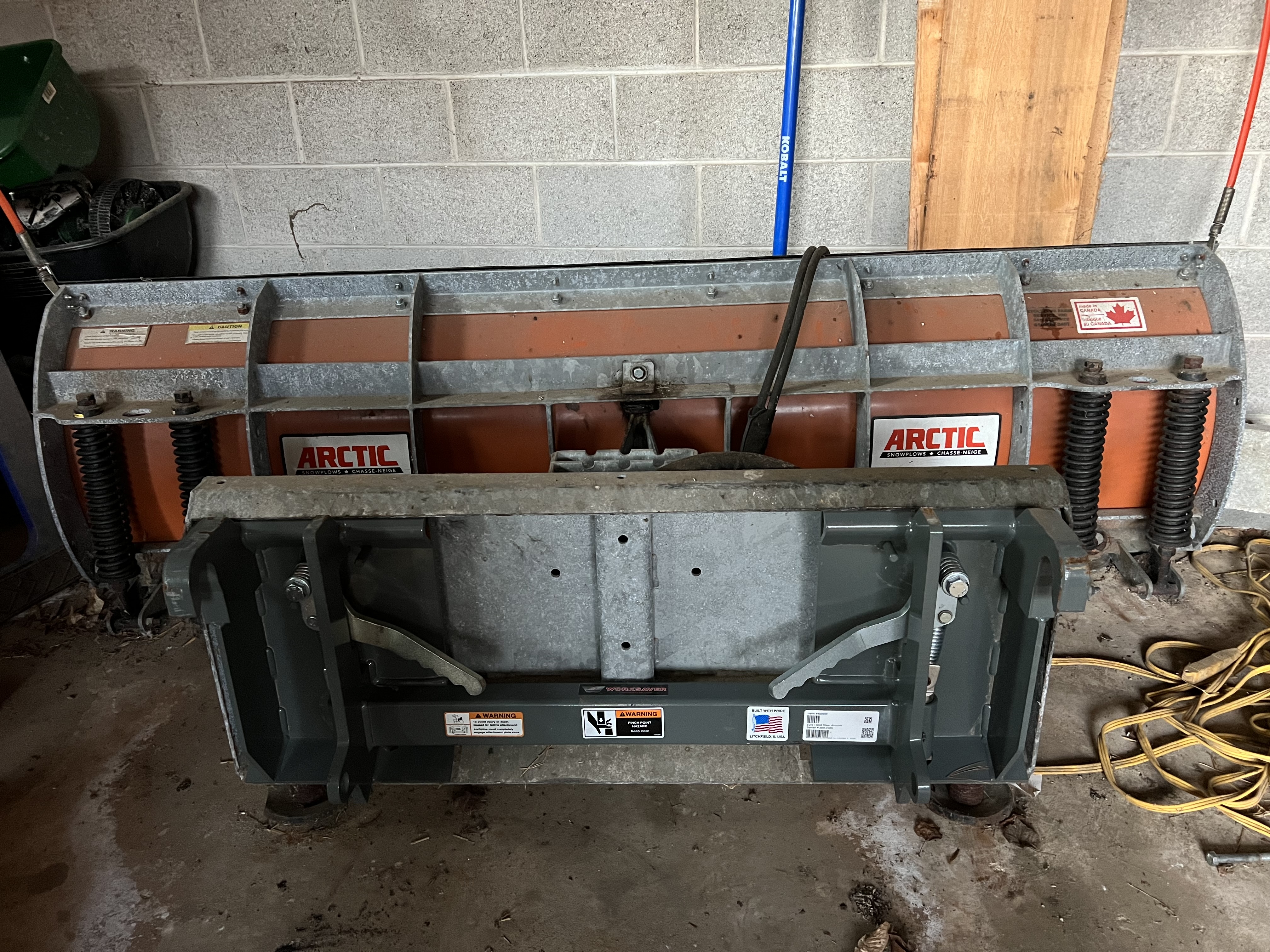

The Euro-Global quick hitch is much stronger, easier to use and much safer then the ssqa.
I agree, and like I said if I were starting from scratch that's what I would go with. But I have a number of existing implements that I want to use that are SSQA.

Why not an adapter instead of giving up on a tractor you want
Yep. I run an adapter, so I can use both types of attachment styles.
A high quality adapter will run you about $1,000.
Euro/Global is so much nicer that you’ll want all Euro/global attachments. Mine even has hydraulic hook up, so I can attach/detach from the seat of the tractor ;)

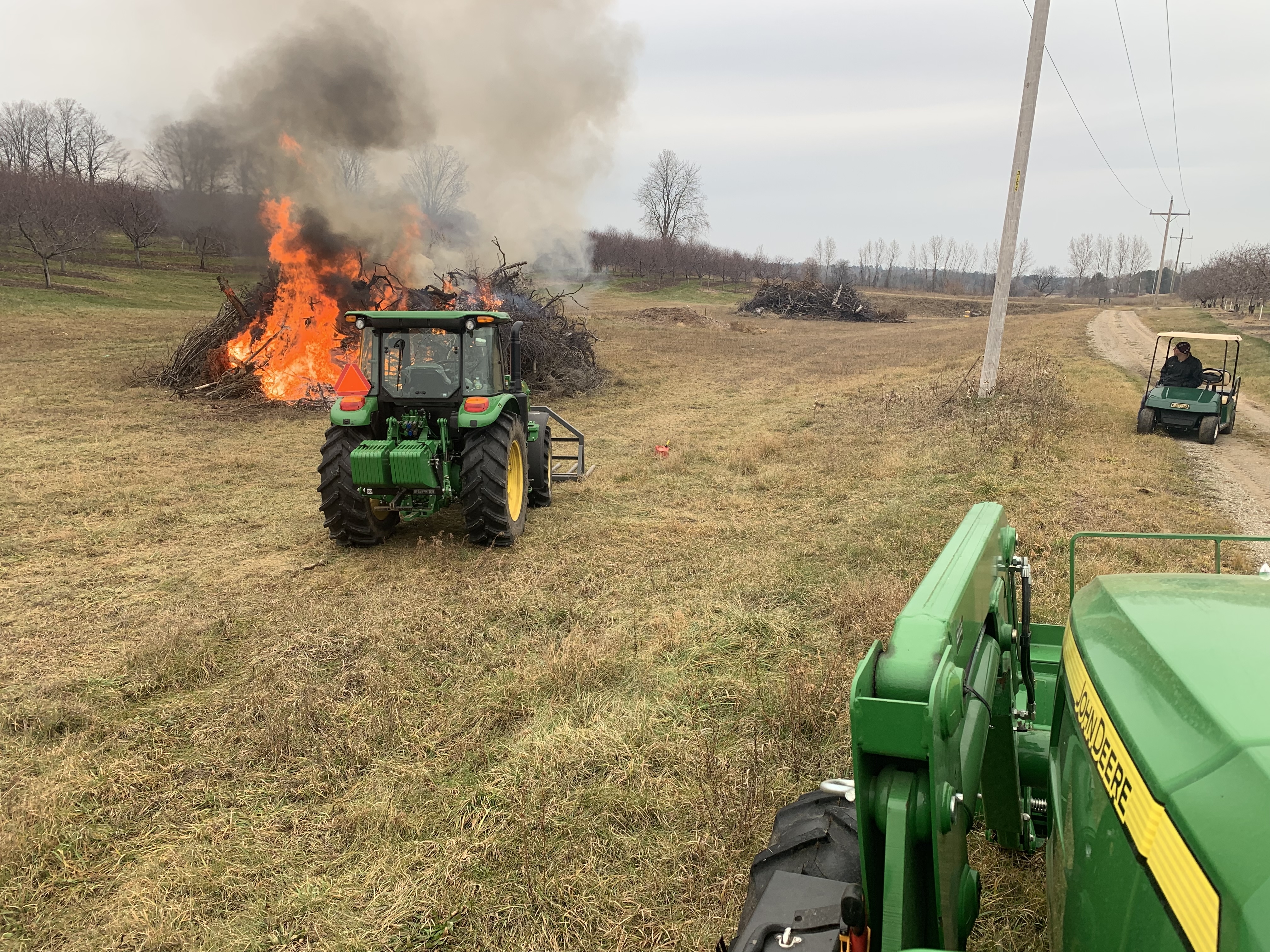

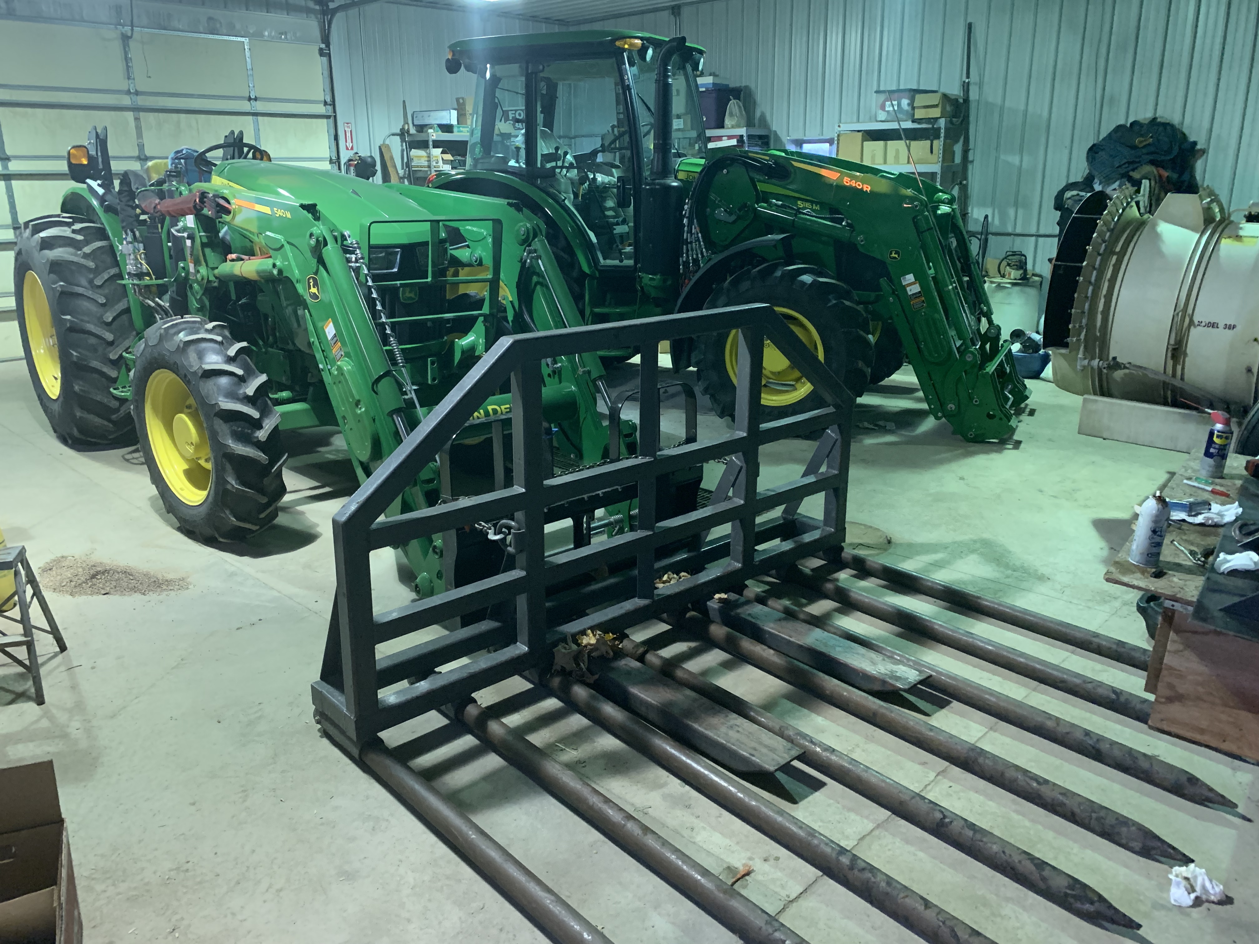

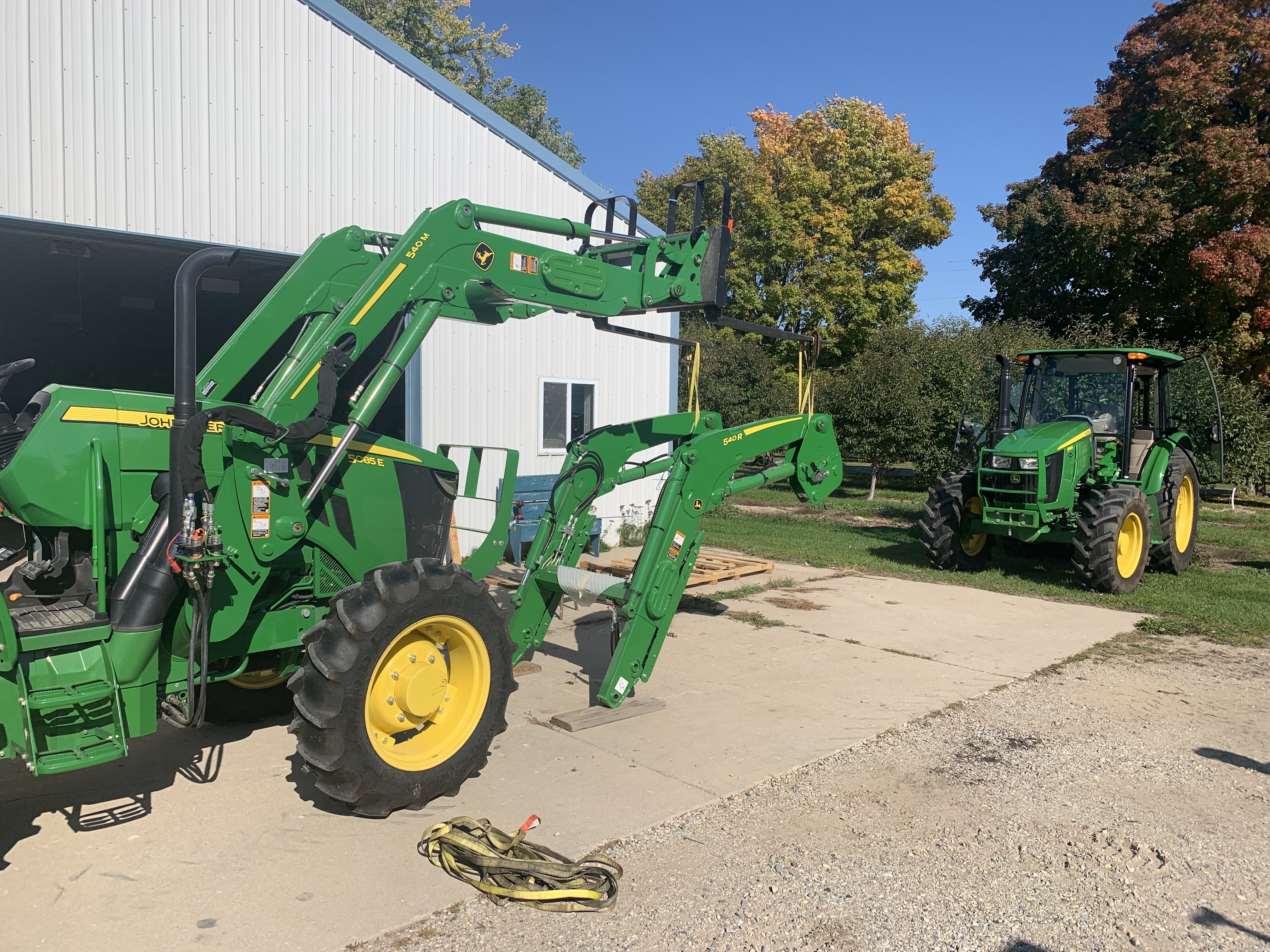

I bought a 5115M about 3 years ago, been a rock solid tractor, no issues. Completely agree with all the previous comments , the euro quick mount is the only way to go even if you had to replace your current attachments.
Another thing to consider is which loader to go with. I’ve got the 540m loader on my 5085E and went with the 540r loader on the 5115M . Both are rock solid and each has it’s slight advantages. I like the 540m for it’s longer reach , excellent for pushing burning brush piles together and keeping the rest of the tractor at distance away from hot coals. 540R advantage is its compactness, doesn’t stick out as far and aids in maneuverability. Bought the 540M separate from tractor and installed myself.
I think you’d definitely like the 5M , they may be a bit pricier but you get what you play for

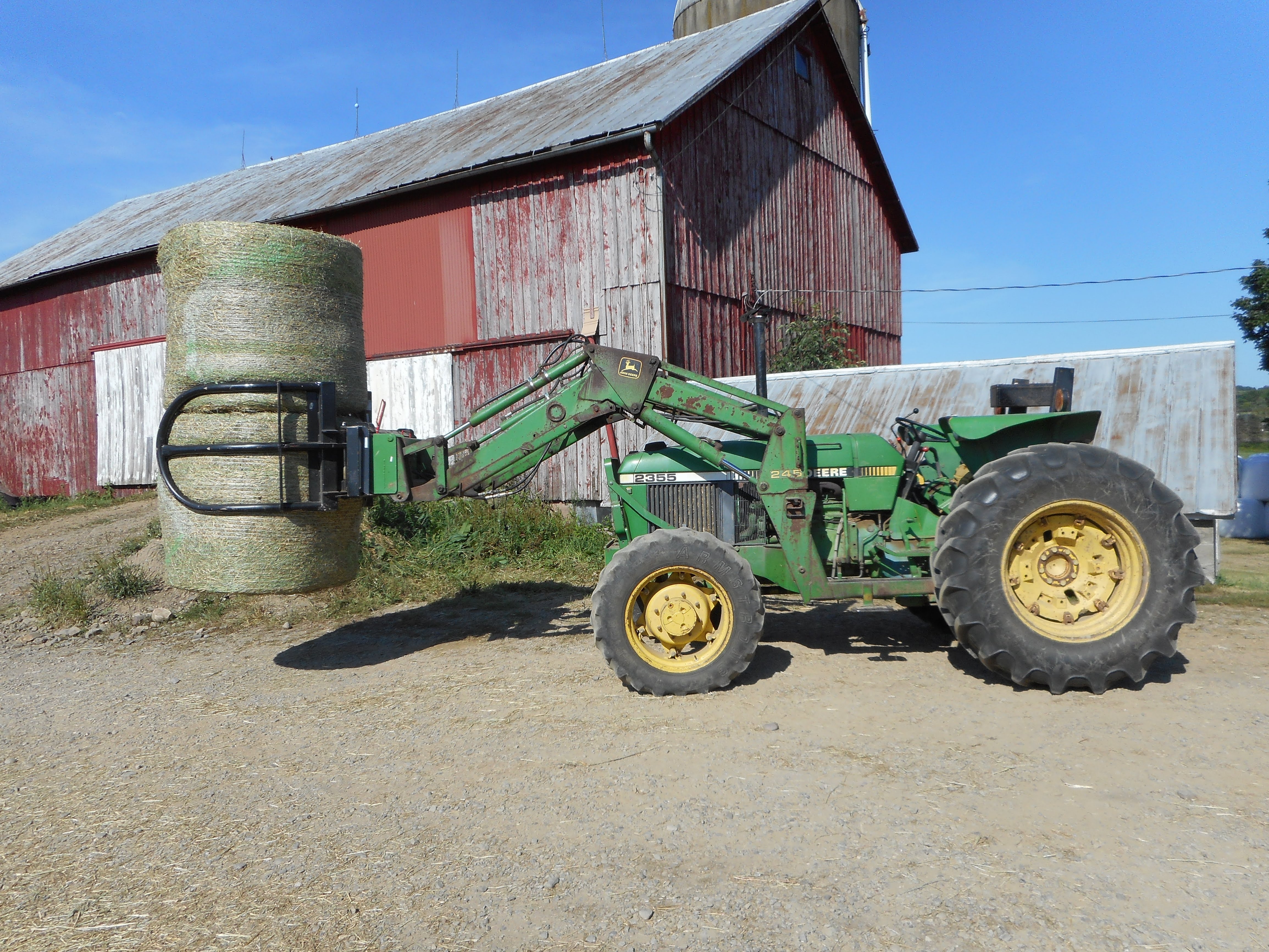

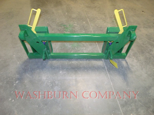

I have 2 adapters from this company. I have 2 different old Deere loaders and needed them so didn't have to modify all my attachments. I know everybody gets concerned about the "couple inches" but unless your going to be extremely abusive there is no issues. The one I use the most is 10 years and used daily and I doubt most people have something similar to the square bale grapple. You don't get much further out than this. It's a lot weight out there on the loader.
I don't have a good side angle of the grapple. I'm always driving.
