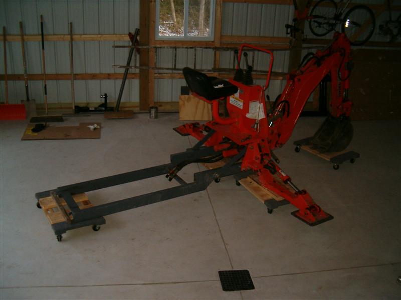

"The next day after I removed the PHD (the hanging rack works great, BTW)"
Do you have a picture of the "hanging rack" you can share with us?
   / Thoughts/Experience on FEL & BH Modularity
#13

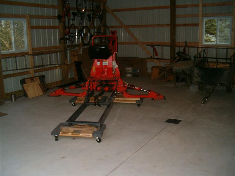

Not quite finished. I am going to put a keeper chain on one upright to hold the top-mount close to the frame, pivoting it in place and reducing the depth of its footprint when in storage. Also, I am going to install a block to keep the driveshaft in place on the dolly when moving it (it stays now, but want to keep it from falling off in transit), and maybe a small bin at the bottom for extra teeth, shear pins etc.
Its not pretty, but it is all on-hand materials, and was knocked out in a couple hours.

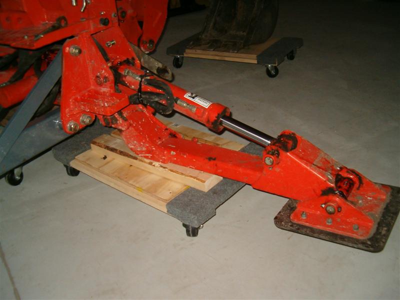

   / Thoughts/Experience on FEL & BH Modularity #14
I store my Kioti backhoe on furniture dolleys. When it comes to reinstall for the Spring it is much easier to move the backhoe into allignment with tractor than vice versa. I do the same to the snow blower in the Summer. For me, it was cheaper to buy the four casters on the furniture dolly than to buy the casters individually frpom the store bin at a store like Lowe's
