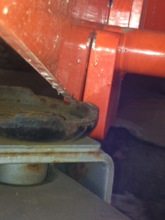

I just wanted to post that i finally had a chance today to loosen my subframe completely and tried several different things to see if the right side would set down completely in the saddle. I mounted the backhoe with the subframe loose and also used the backhoe with down pressure to raise the subframe. Each time i tighened it in any position, it was the same result. A gap still appears on the bottom right. Left pin pulls with ease like the ones on the front loader but the right one is stubborn. I use the stabilizers and then I find the happy spot. Once the pins pulls loose from the outside edge of the frame, it slides the rest of the way with ease. I think i may try to put just a little up pressure with a floor jack tomorrow at the pin area on the backhoe and see if that allows the pin to pull free without binding. If that works, I may fit the saddle on the side with some shim material to build up the difference. If it works, I'll post the result.

Is the lower backhoe pin bent or welded on crooked? One of mine looks straight, the other not so straight.

I didn't think to look at the backhoe itself. I'll check it tomorrow also. I'll take a tape measure and measure each side from pin to saddle and see if they are the same. Right side pin just pulls out so easy. I'll keep on working until I find a simple solution to make the right side pull just as easy. Lol. Im not sure where the pin is binding, top or bottom, or maybe on one side. I'll take a sharpie and color the end and tap it lightly and remove to see where i am binding. I did notice one thing. Where the backhoe has been removed several times now, i have a small spot on the right side that has rubbed the paint off. Other side has no rub marks.

photo[2].JPG I went over today to where I store my backhoe and I had thought about an idea to try and see if it would work. I put the backhoe down with pressure and the left pin pulled with no problem at all. The right one was binded tight. I got my floor jack and put under the backhoe where it sits in the saddle. I took the jack and added just enough pressure to the backhoe as if was bottomed out in the saddle. I checked the pin on the right side and it pulled with no problem at all. The problem is the subframe is off about 3/16's of an inch. I took a picture and sent it to the dealer to show that gap in the saddle and the pin to see if Kubota will do anything about it. I just bought it August 24th of 2012. I hope to get an answer sometime next week. I know that is just a minor issue that I can live with but at $30,000+, I just want it to right. I'll post what I find out ASAP.

On mine I've had to tap a hammer at first, though with age it got loose (I did have a tight fit originally even w/o the BH on). Now when taking it off I do find that the down pressure needed to remove the pins is different. The left one comes out easily and then I slowly ease the down pressure by raising the boom as I pull on the right one until the right one comes out. I suspect it's just due to the BH being slightly out of line or not level.
I do use a dolly that I built and described in the below thread. That helps a lot to line it up and I do not use the stabilizers at all to mount / dismount. You probably know this, but you want it supported entirely by the saddle when mounting / dismounting VS having weight on the stabilizers.
