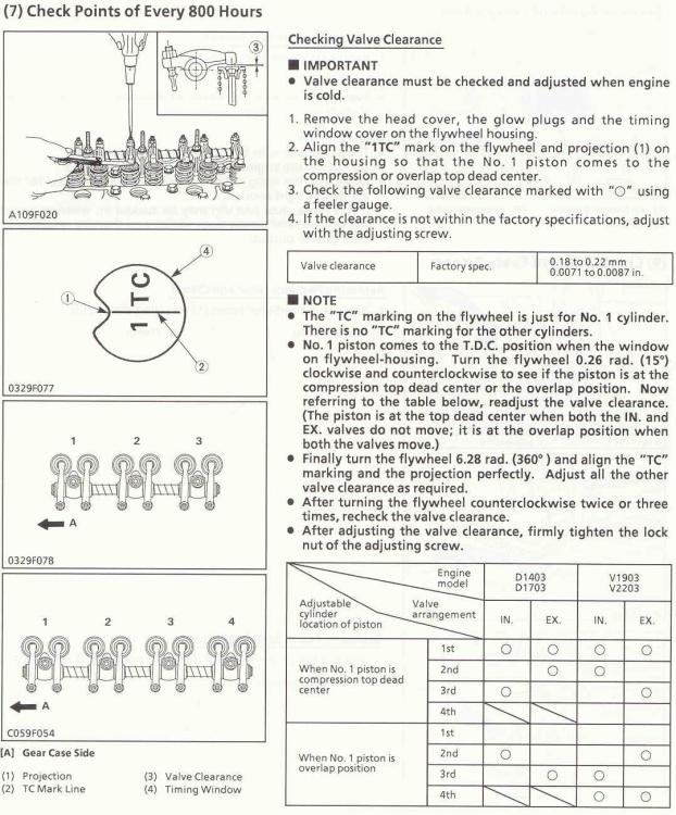

As to your valves, a call to your local Kubota dealer and a short chat with the shop foreman or mechanic should give you the info you will need. Valve adjustment is time consuming but very easy. This is the valve adjust page for my L4200. KennyV.

Thanks for the fact sheet- I agree that some info is better than none. I was concerned that the manual that was listed on e-bay would end up being next to useless as it covered so many different models. It is an " I & T" publication. It's under $25.00 so even if it's of little value, I'm not out much- much cheaper than a trip to the dealer for sure! Again, thanks for the help.
