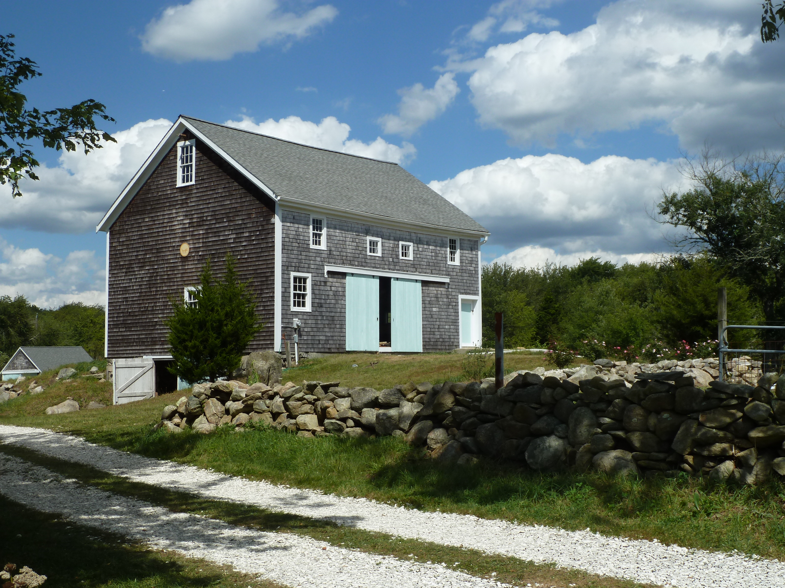

My place has been a farm since the 1680's, but the oldest buildings are from the mid-19th century. The most prominent building is the barn, which was built as a dairy barn. According to the tax records it was built in 1850. When I bought the property the barn was in pretty bad shape, I was worried that a big winter snowstorm would bring it down. Since then I've done a number of things to preserve and restore it, although I still have a ways to go.

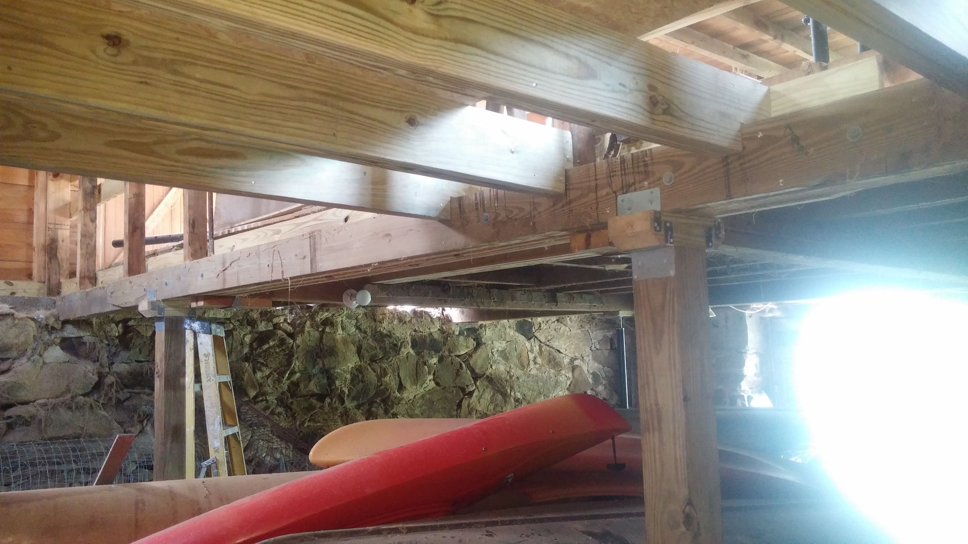

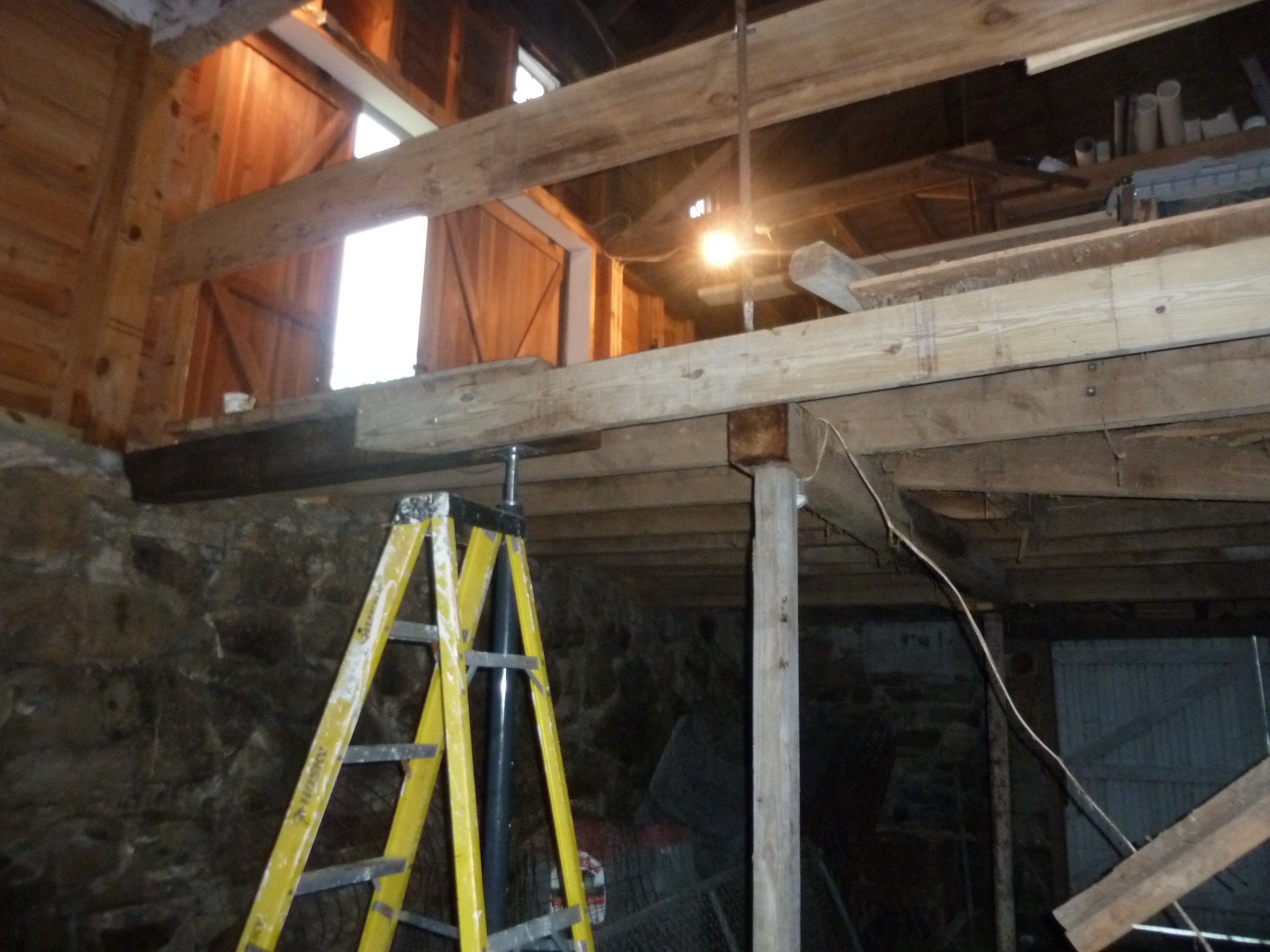

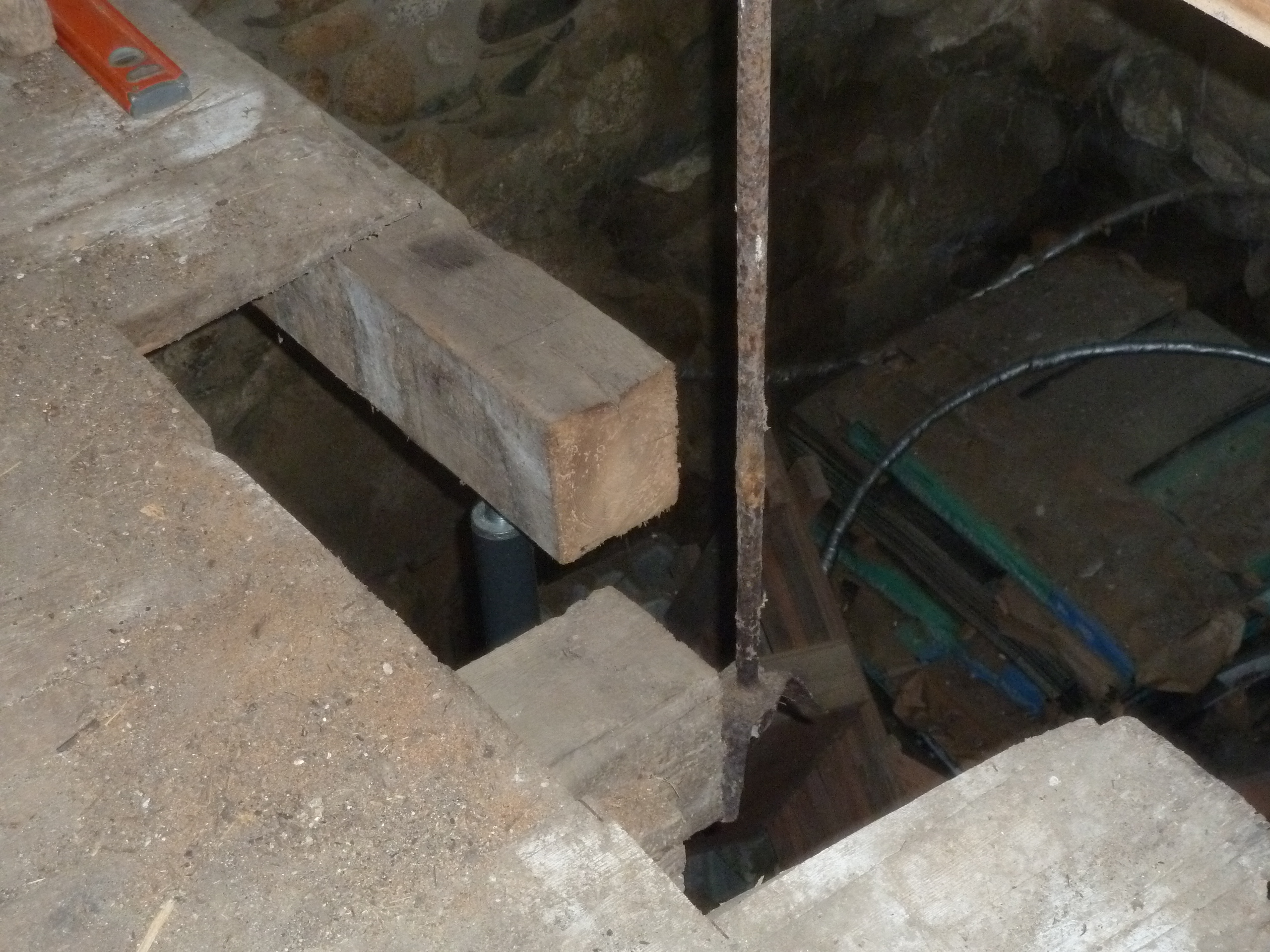

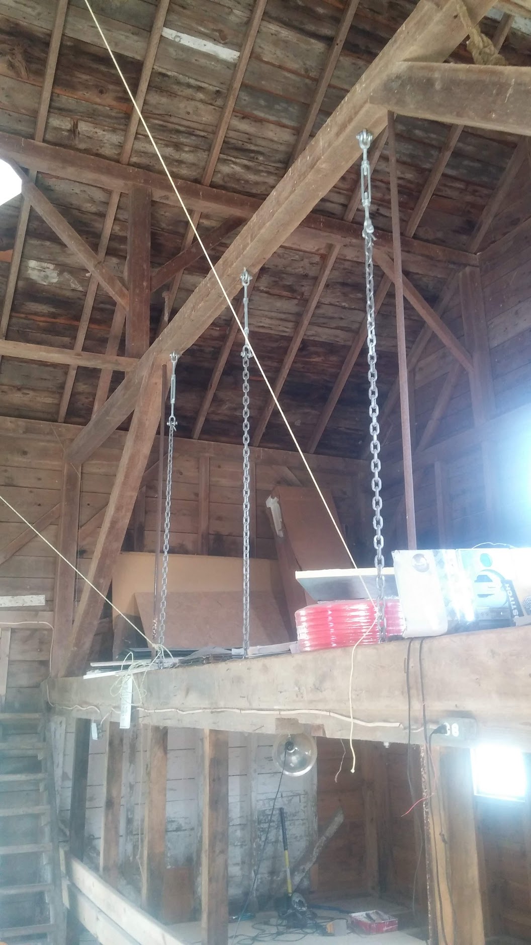

The barn is what's called a "suspension barn." I haven't been able to find out much about suspension barns other than they are rare. This website: Suspension Barn shows the construction of a suspension barn similar to mine, although there are some differences. My barn has three levels: a basement that is about 10' deep, a main floor, and a hay loft (or "hay mow" as they call it around here, rhymes with cow.) The reason it's called a suspension barn is that the main floor and the loft are suspended from the framing by wrought iron poles. In the original design the basement was completely open.
Like all old buildings around here it was built facing the sun, with the ridge going east-west. The basement floor is at the original grade with a wide door in the western wall. The stone foundation was built above ground, and then dirt was brought in to fill in the north and south sides up to the level of the main floor. There are big sliding doors on the north and south walls, and they used to drive wagons up the dirt ramp and through the barn. In the summer the lofts would be filled with hay this way.
