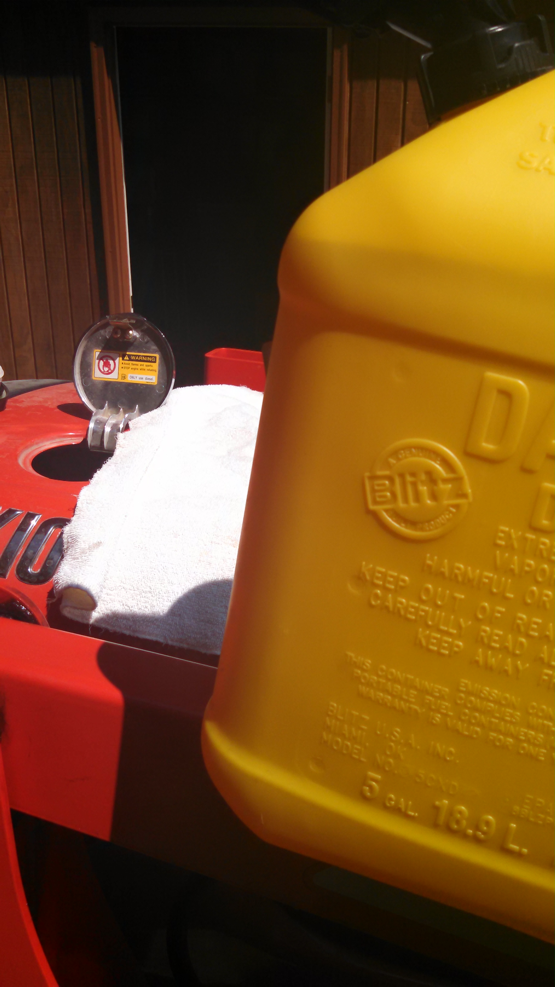

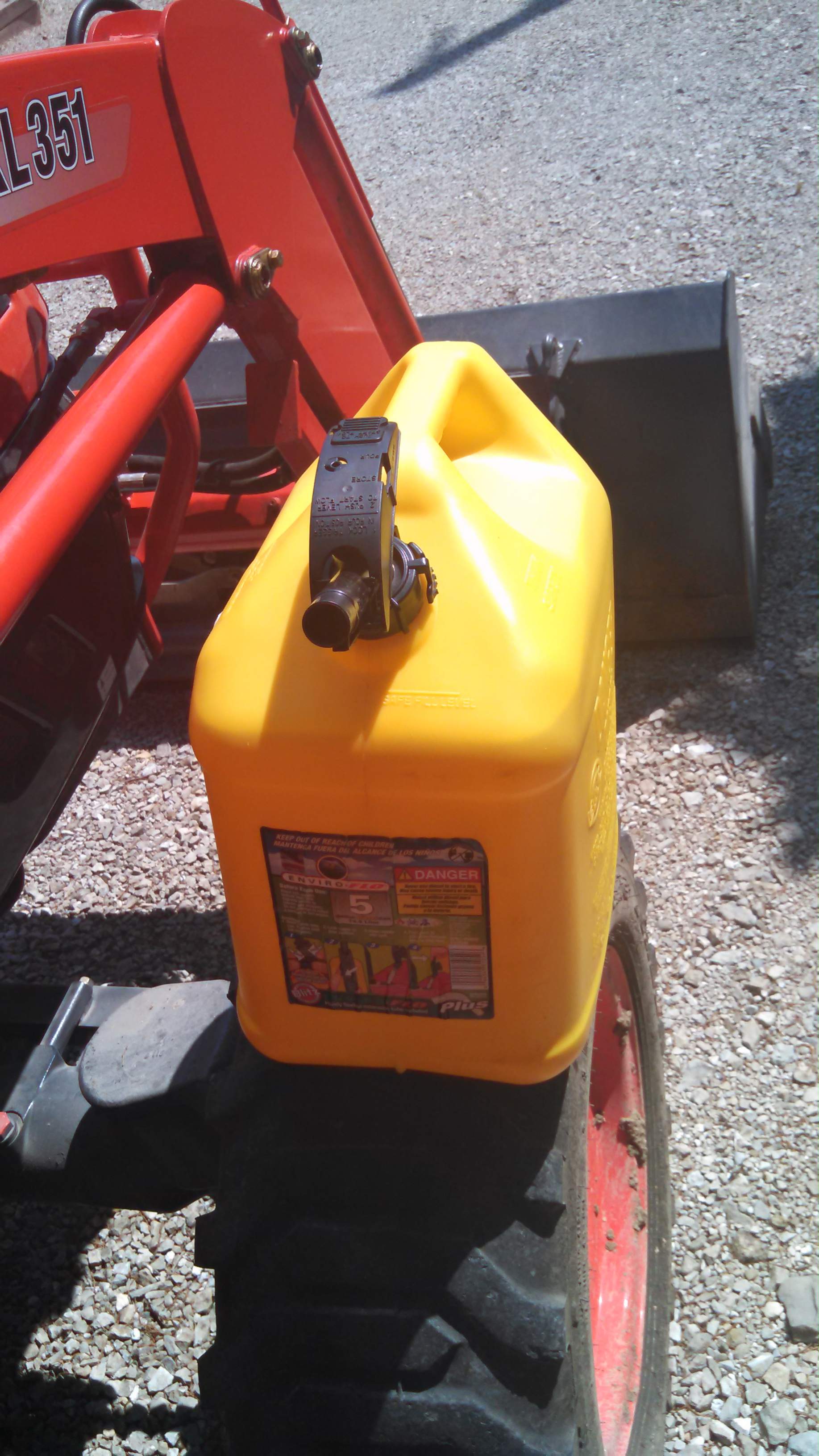

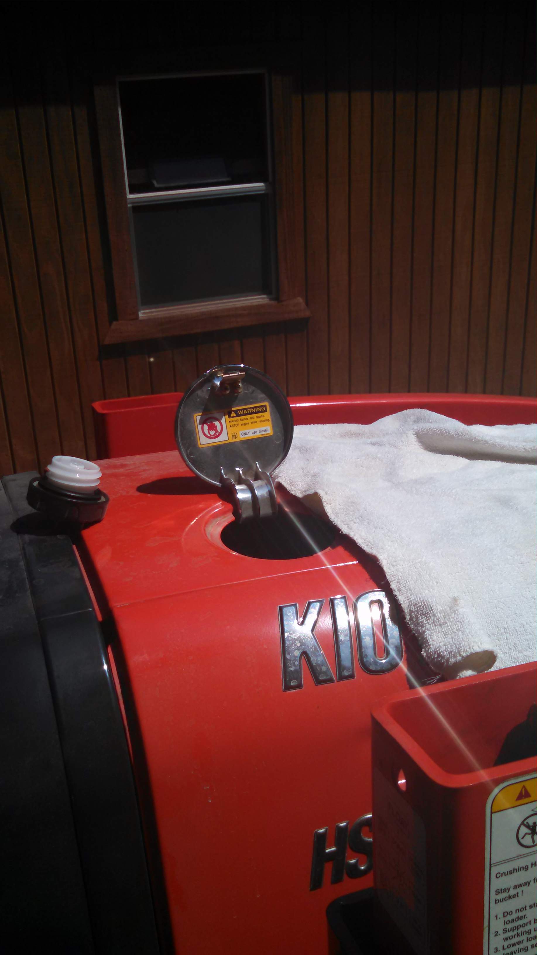

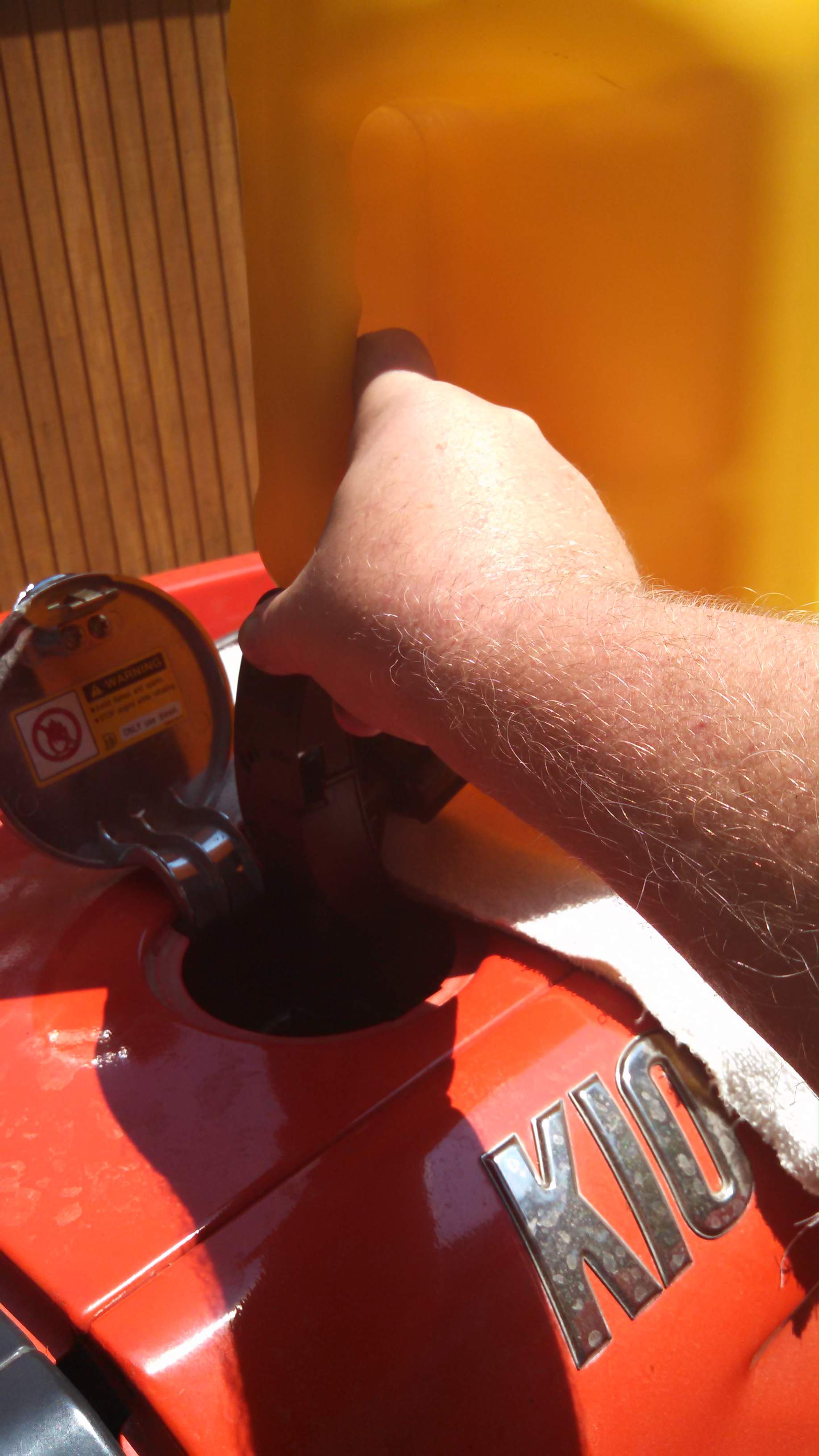

There have been many threads on fueling the tractor, and I thought I would just show how a 59 year old office worker fuels his tractor 5 gallons at a time.
I have the older Blitz 5 gallon diesel fuel cans with the 2nd generation lever control valve. I did yank out the safety lock "guts" of the valve as that is just stupid to have to push a slide lever then the main lever to start the fuel flow, and if you let up on the main lever the safety lock must be actuated again. So a pair of needle nose pliers and one good yank is all it takes.
Here is what I do, I lay a soft towel on the hood after blowing away any loose dust. and remove the fuel cap. then lift the can to the Right front tire, then lift again to balance on the loader arm, and then lift over and tilt the can to lay on its face on the towel on the hood with the spout sticking right in the fuel filler neck. Then just hold the fuel can lever down with your thumb and watch it gurgle in. There is no holding of a heavy can, just lifting for a couple of seconds, and the final lift is slight downward, and using two hands on both the top and rear handle of the jug, so it is pretty easy to do.
As I pointed out I am not very strong, or at least no where near the strength I had 30 years ago when I did more physical work. So I would think most anyone could do this. I hope this helps someone

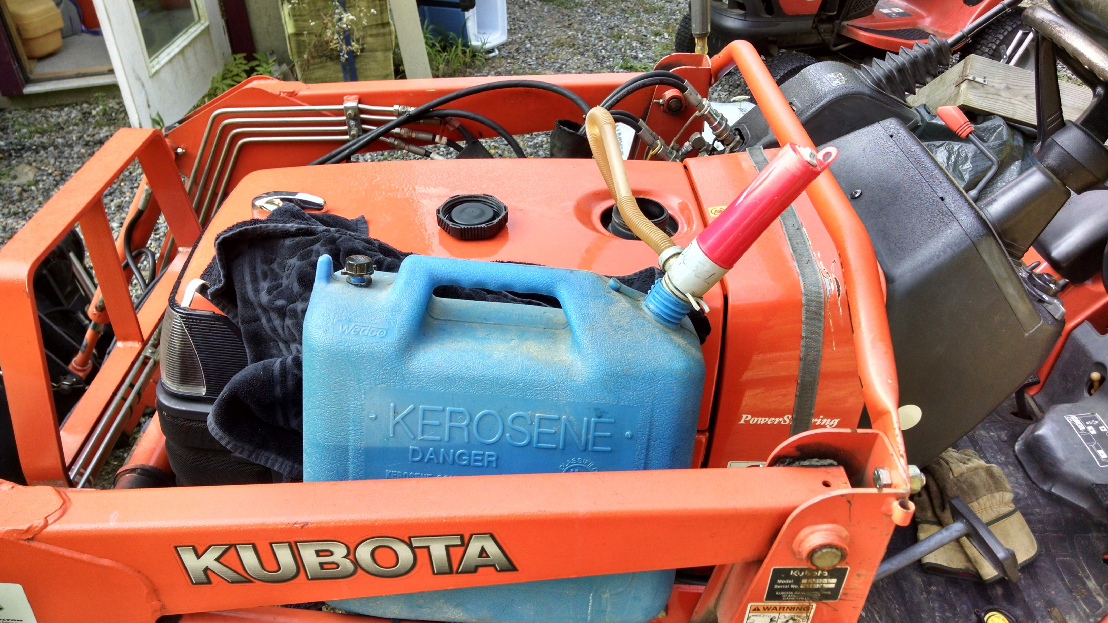

I picked up a couple of Jegs "utility jugs" that are actually vented with a 1.5" OD nozzle. Takes <30 seconds to drop in 5 gallons of fuel. :D

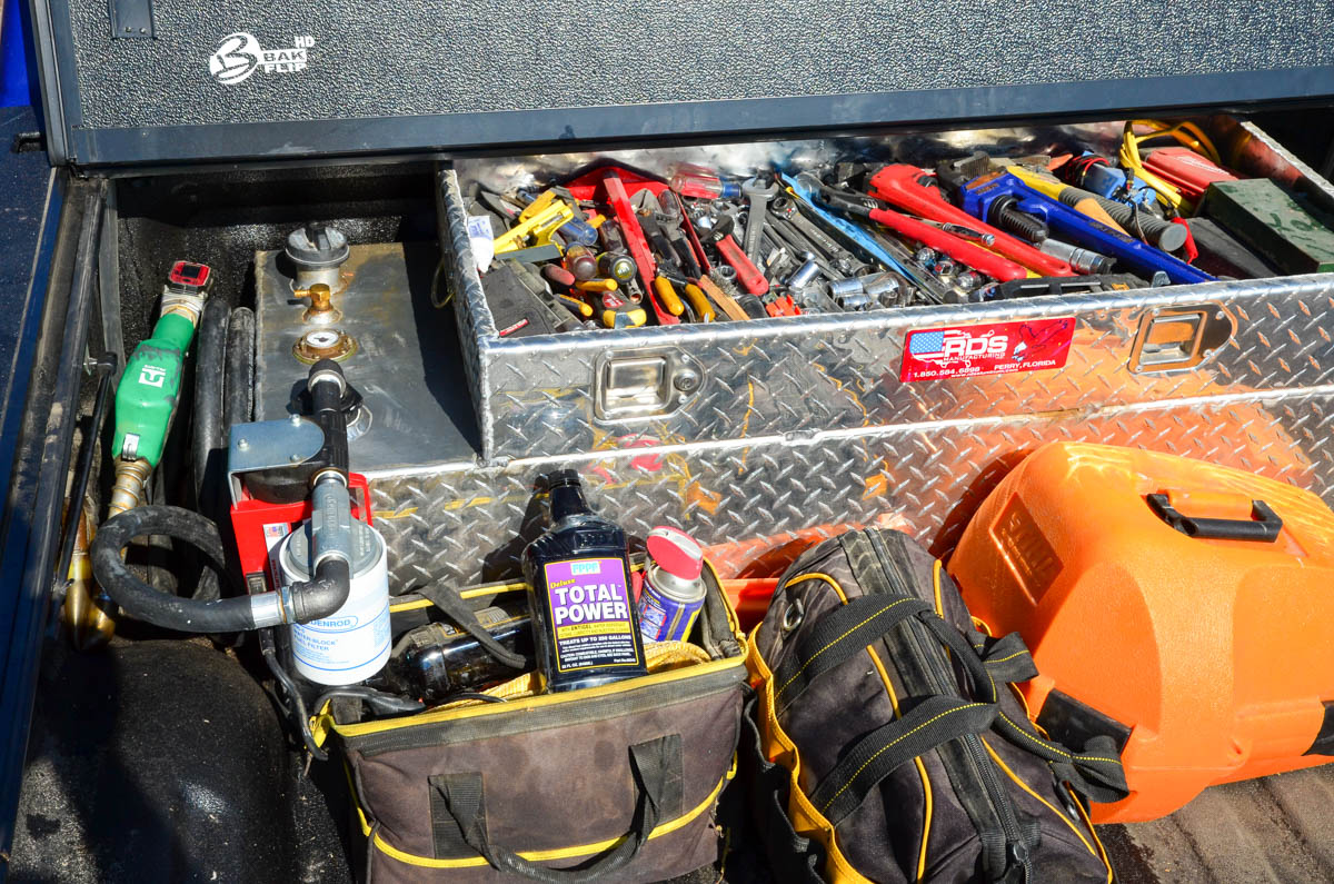

I went ahead and replaced the galvanized fittings on my transfer tank with black pipe to avoid the issue with diesel fuel contamination (thanks for the heads-up!).
The attached picture shows my setup. I keep this in the back of the truck and use it to fuel both truck and tractor. It is great to have in remote Colorado country where the nearest good truck stop may be 100 miles round trip away. The tank includes a 12v pump powered off the truck. I had to cut the top off my toolbox-tank combo (RDS) to get it to fit under the tonneau cover (Bak-Flip fold up). This setup works for towing with either a gooseneck or fifth-wheel hitch. The cover seals everything up nice and tidy when not towing.
I'm gonna replace my galvanized pipe with black pipe too. I need to replace my kinked up hose at the same time. I've already bought a new one.
We do indeed seem to have the exact same diesel tank / toolbox.

I just installed a sheet metal screw in the back side of the fuel can and popped the spring loaded insert out from the spout.
