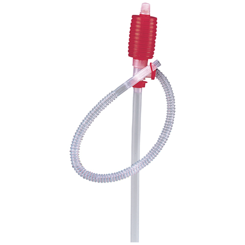

Next to my shed, I have a 5 foot stand (in the shade of cedar trees) that I lift the 5 gallon jugs on to. Then I throw a siphon hose over a branch and take a break on the tractor seat while it fills. Works for me as a poor boy way of doing things. Using some junk lumber and eight feet of 5/8 inch tubing, it didn't cost much. You gotta have some good lungs to get it going .:laughing: Yet those full jugs are a little heavy for me to get up to 5 feet.......as I'm only 5'3'' myself....guess I've got more brawn than brains.:eek:
Put your finger over the end of the siphon tube ald lower almost all the tube to below the level of fuel inthe tank. Slowly pull out tube to fuel tank and release finger. Fuel should flow. There are othe ways of doing this and not having to use your finger.
   / This is how I fuel the tractor #14
Thanks, Egon....will have to try that if, for no other reason, to prove that it works.

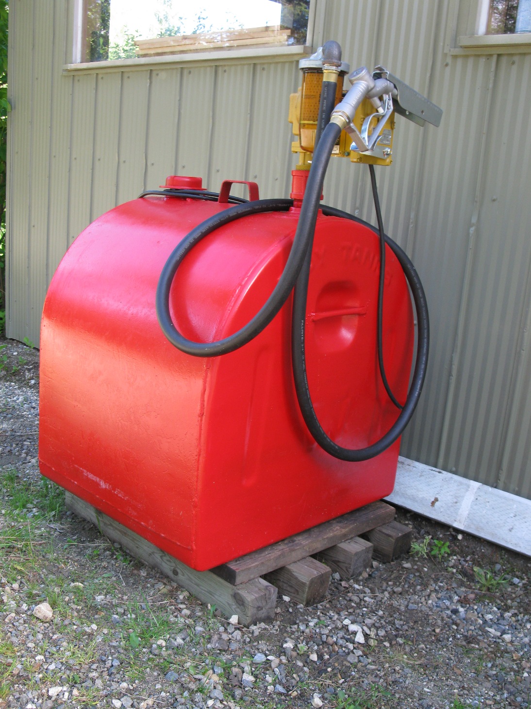

I use a similar tank and pump system, Gary, but with a booster pack similar to this:
Motomaster Eliminator 800A Powerbox | Canadian Tire
The booster pack is handy for trips to the back country and for lighting and small appliances during power outages.
I think my tank is 70 imperial gallons(318 liters):
I fill it two or three times per year. It is easy to transport in the truck.
A booster pack is what I was using till the battery quit taking a charge. It wasn't as big as the one you linked but the same principle. It doesn't take much juice to run the pump to fill a 10 gallon tank but one of my tractors now hold 26 gallons so it takes about twice as long. Still these little pumps can run a long time on a super small battery. I tore mine apart when it quit taking a charge and turned it into a battery minder.
