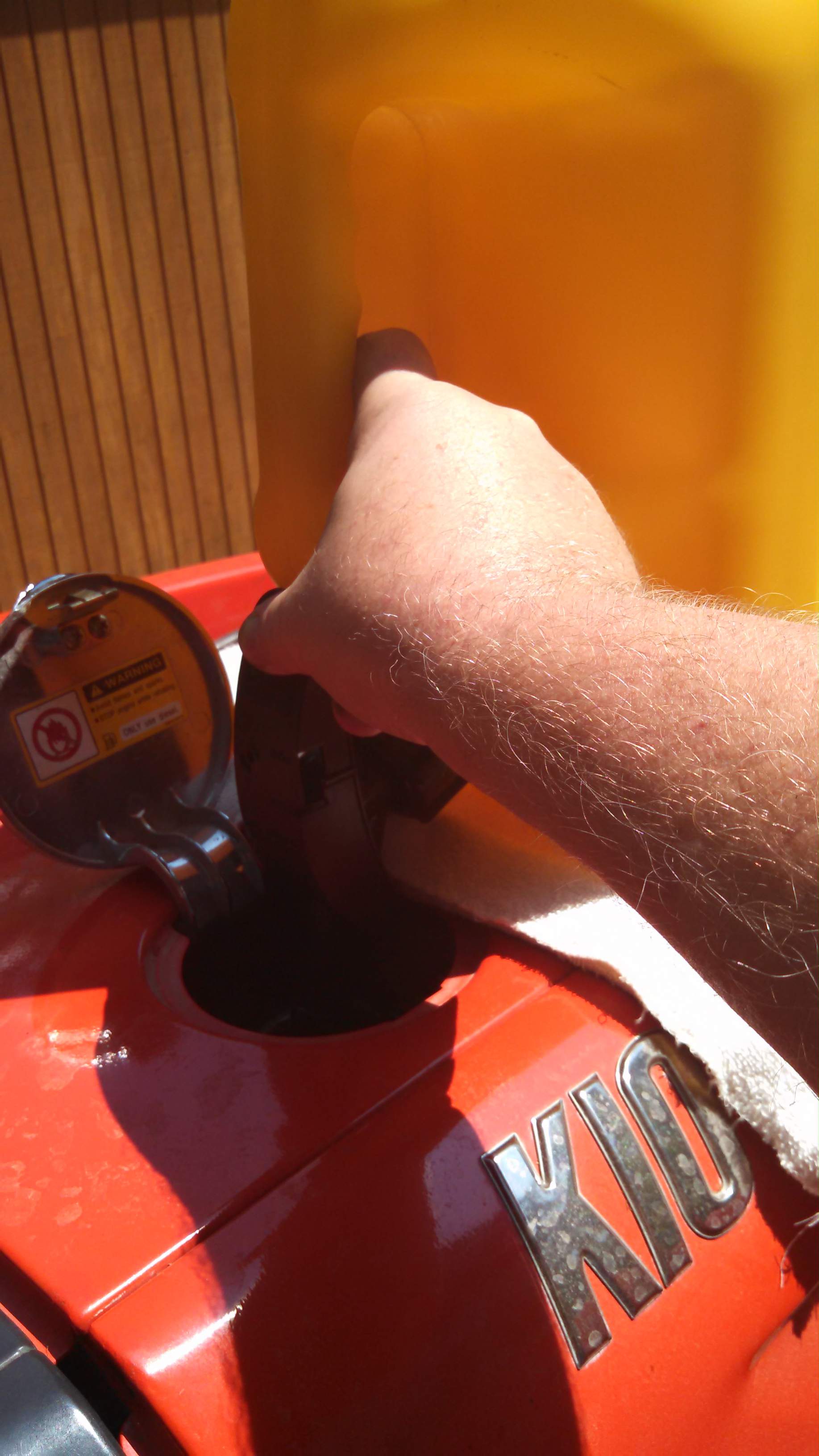

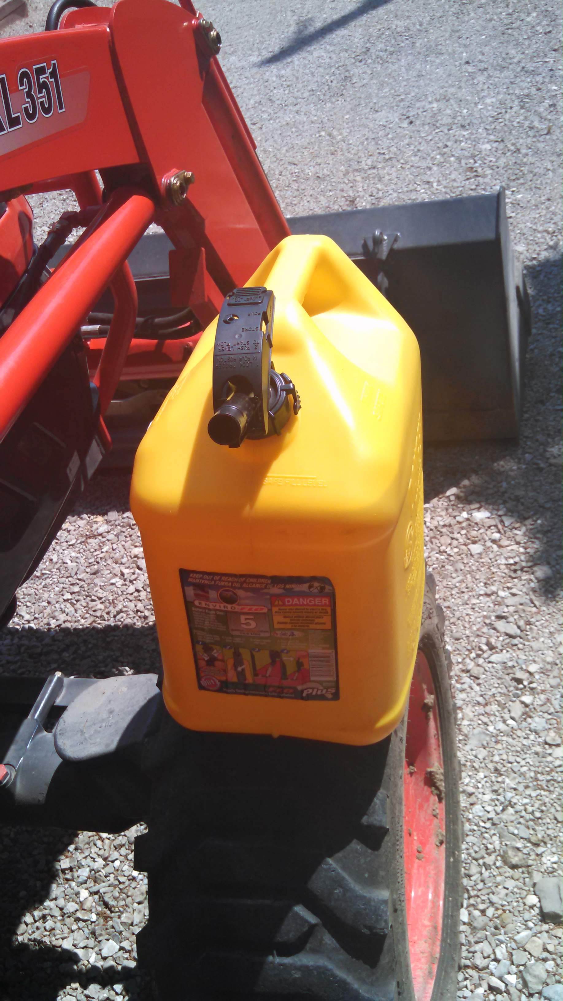

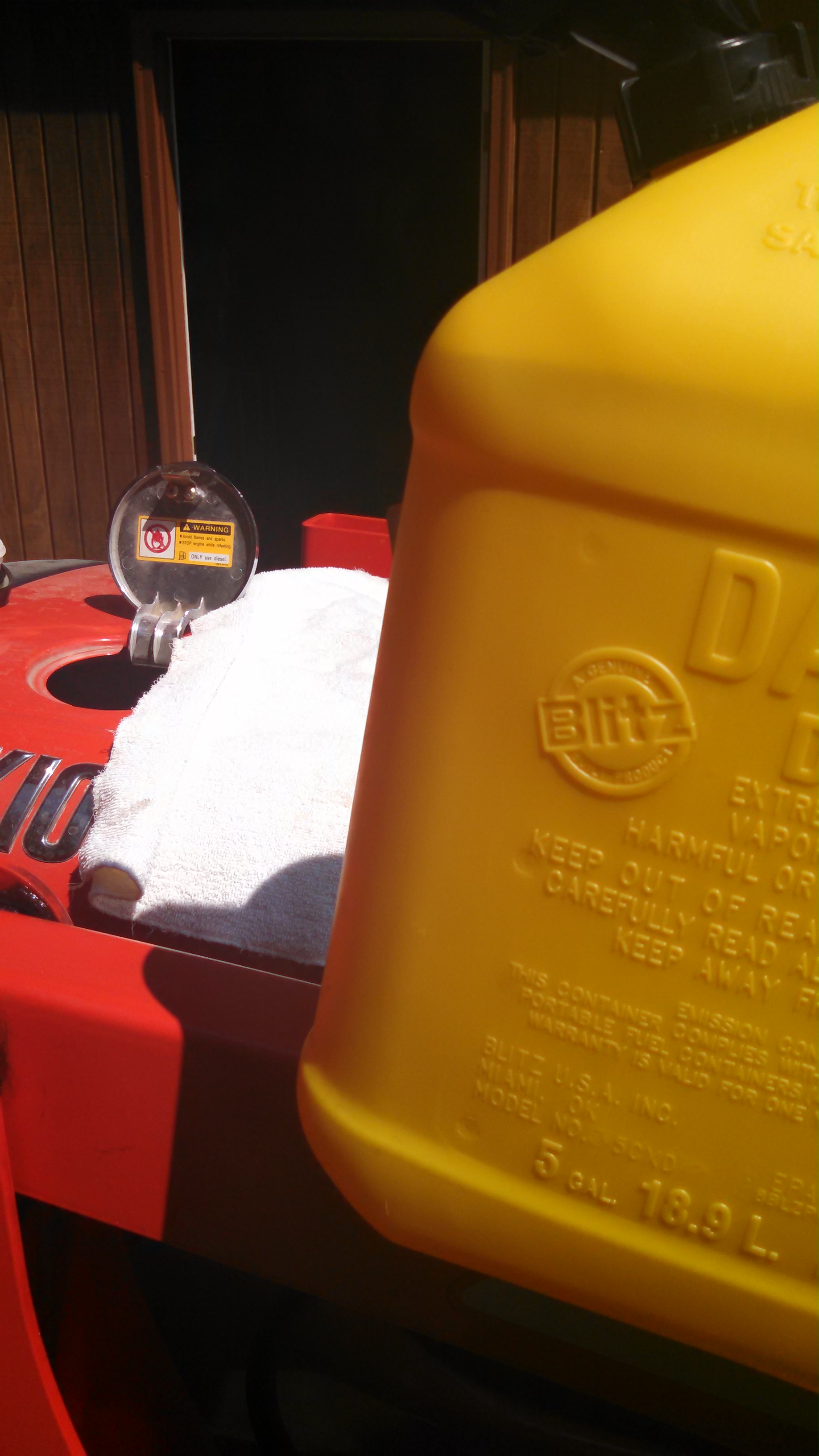

There have been many threads on fueling the tractor, and I thought I would just show how a 59 year old office worker fuels his tractor 5 gallons at a time.
I have the older Blitz 5 gallon diesel fuel cans with the 2nd generation lever control valve. I did yank out the safety lock "guts" of the valve as that is just stupid to have to push a slide lever then the main lever to start the fuel flow, and if you let up on the main lever the safety lock must be actuated again. So a pair of needle nose pliers and one good yank is all it takes.
Here is what I do, I lay a soft towel on the hood after blowing away any loose dust. and remove the fuel cap. then lift the can to the Right front tire, then lift again to balance on the loader arm, and then lift over and tilt the can to lay on its face on the towel on the hood with the spout sticking right in the fuel filler neck. Then just hold the fuel can lever down with your thumb and watch it gurgle in. There is no holding of a heavy can, just lifting for a couple of seconds, and the final lift is slight downward, and using two hands on both the top and rear handle of the jug, so it is pretty easy to do.
As I pointed out I am not very strong, or at least no where near the strength I had 30 years ago when I did more physical work. So I would think most anyone could do this. I hope this helps someone

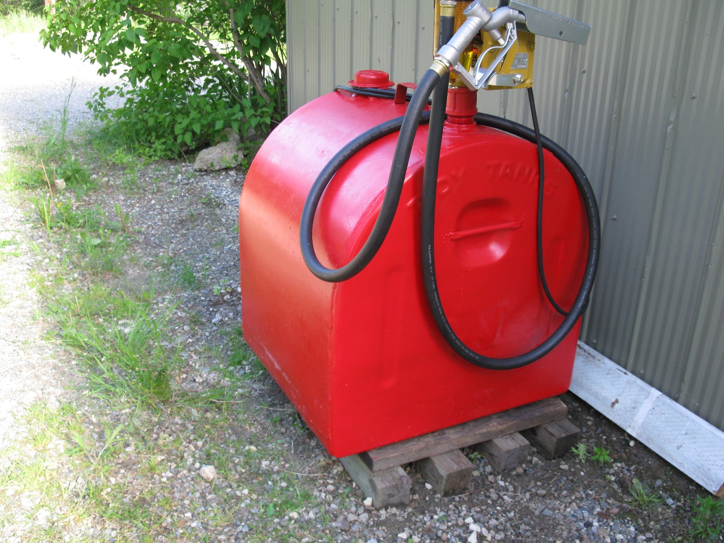

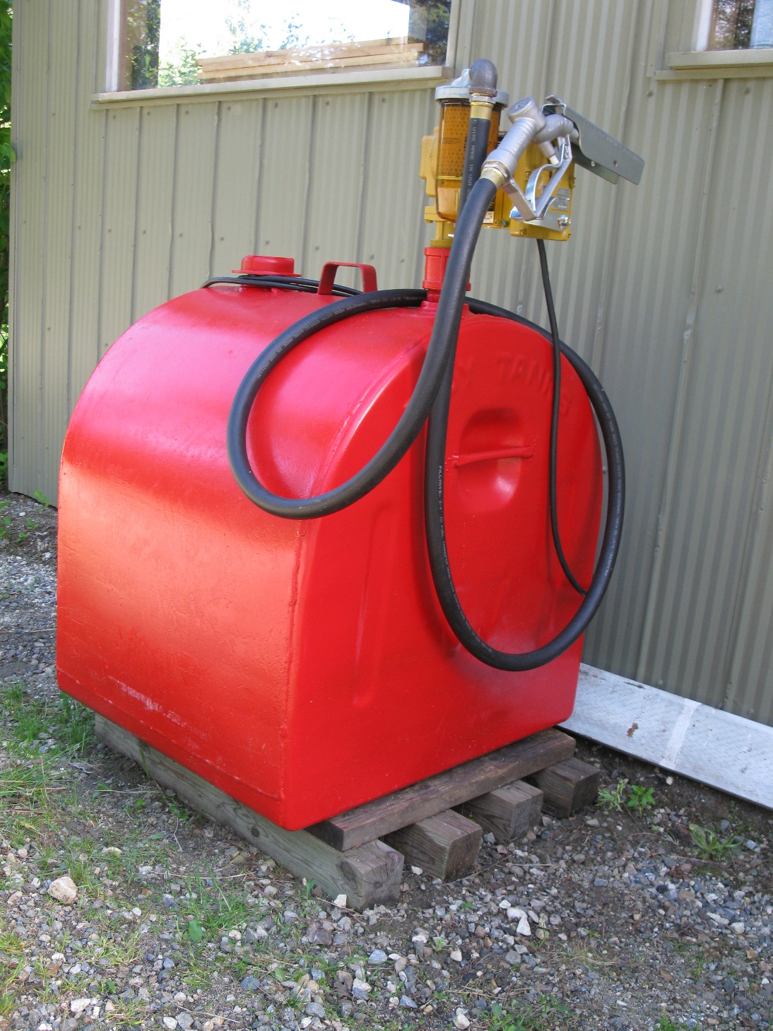

I use a similar tank and pump system, Gary, but with a booster pack similar to this:
Motomaster Eliminator 800A Powerbox | Canadian Tire
The booster pack is handy for trips to the back country and for lighting and small appliances during power outages.
I think my tank is 70 imperial gallons(318 liters):
I fill it two or three times per year. It is easy to transport in the truck.
