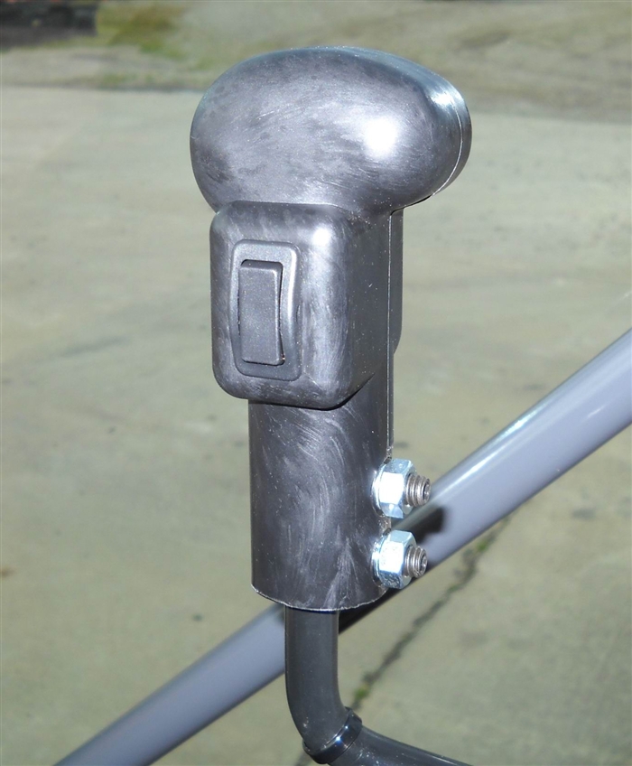

I'm buying a new tractor (TYM T354HST) and the dealer will add a third function remote for me to power a grapple. I assume the hydraulics part is fairly standard, but the loader joystick that's replaced seems to vary in quality and ergonomics. Do any of you have any recommendations on what to use and what to avoid? Pictures would be most helpful.

/ Third function remotes: requesting pics of controls
#15
Yes, in my opinion. I'm sure the quality is fine, but I don't like the look of the plastic, the rough edge on the bottom and the two large bolts on the side holding it to the joystick.
/ Third function remotes: requesting pics of controls #16
I have WR Long 3rd Function kits on two tractors. The control handle look great and works great! Anything but cheap? The handle is black, not gray as it looks in WRL picture. The bolts are of no consequence, keeps control handle firmly attached.
Cosmetics of the handle are a silly issue, it's how well the 3rd function works. The WRL rocker switch is well placed to operate with your thumb while operating FEL with same hand. I wouldn't have bought a 2nd one if first one didn't work well!
