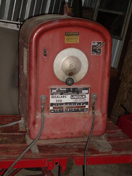

   / Thinking about welders #14
I picked this idealark last weekend for $200 with 50ft of lead and ground. It's a 1958 with the switch in upper right to change from DC+, DC- or AC. After running a few beads with DC+ and 6011, I dought I'll be using AC much at all. The only negitive is it's 3 times bigger than my tombstone AC.

Cleatus, with the price of copper as high as it is, you would pay 200 bucks or more for just the cables...... I think you got a great deal... those old welders last for ever.

I just bought 120 feet of #2 welding cable for my AC/DC tombstone. A local welding supply chain (James Supply) had the wire for $0.25 cents a foot less than Atwoods. I extended the 9 ft original ground cable and the 15 ft HOT lead. I am using Tweeco (SP?) connectors so I can use half +/- of the hot lead and insert the other half if I need it to reach a job. I have mounted the tombstone on a small 4x8 deck size trailer and although it is maneuverable it still requires longer leads as it is not as maneuverable as the tombstone on wheels was.
Terrific price performance ratio on Grand dads old welder. I second the opinion regarding adding a rectifier to it to get DC. A full wave bridge is the style of rectifier you need. You should be able to DIY for a decent price. Do not skimp on aluminum for mounting the diodes and do use a fan for forced air cooling. You don't have to buy special finned heatsinks as extruded aluminum angle will work fine but it has to be pretty heavy wall to work right. If you use thin material the fan can cool the aluminum at a distance from the diodes while the diodes are way too hot and failing from overheat. Alternator diodes are mass produced so are a good choice. They press in.
There are lots of guys on TBN with electronics backgrounds who could advise you. I have worked on a portable battery operated welder project in the past and built the prototype electronics including the rectifiers.
