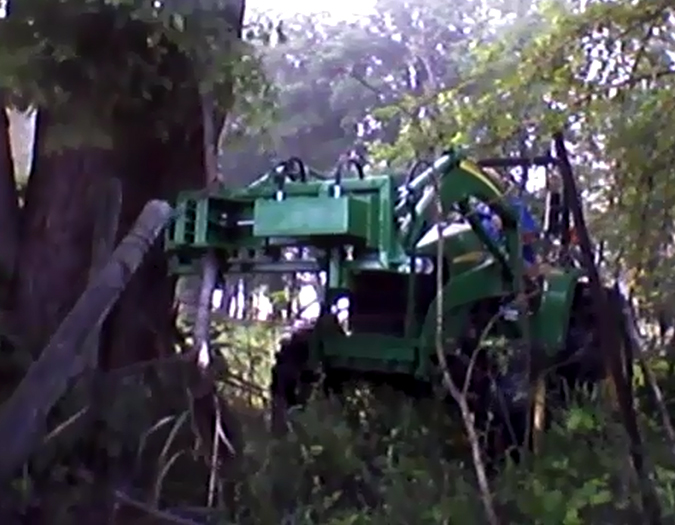

also would not drive a tractor straight through a mess like that and try to run a cutter behind. Whoever advised that is lacking in experience or has access to free repairs when something breaks.
Really!I have a medium duty mower but wouldn't try to cut 1-1/2-2" stuff with it.I have about 700 hours brush-hogging driving forward,havn't broke yet.You have to use a little common sense,I hand cut the big stuff.You can't back into brush with a rear pto driven bush-hog.If you are real serious ,armor up your underside (your tractors).
/ Thinking about buying a new tractor #13
I have driven over more stuff with rough cut mower than wanted to but do so carefully and have never had an issue. Would I drive over a 2 inch tree, no. But there is simple solution your current Massey should handle, get a four foot rotary "ditch mower" such as a Hardee or a flair mower that extends past the tractor rear wheel. Some of those will easy handle a 2 to 3 inch tree depending on the type of tree and your speed. (Not oak trees.) Might can find good used but watch for they can be abused but here many smaller ones parked as they have gone to bigger tractors and bigger cutters for side work. Hardee is built I think, in Loris SC address, which is about 15 miles from Myrtle Beach. They do not sell direct. I am not talking about a boom mower, they cost a good bit more. Just do a search on ditch bank or such cutters.
