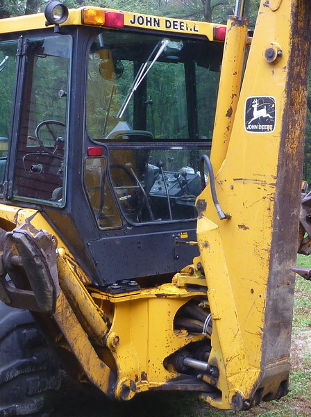

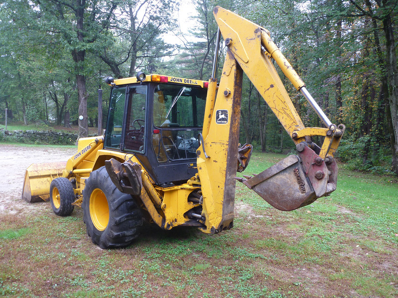

In my quest to make my backhoe more useful, I'm thinking about adding a thumb to it.
I added a grapple to my tractor and it was the best thing I've ever done! I can only imagine I'll get a similar feeling with the backhoe. The backhoe in question is an older John Deere 410B, not sure of the year, maybe a 1985, it has a bit over 4,000hrs on it and I'm sure it has a lot of life left in it, as long as I keep using it and don't let it sit and go unused! The more useful it is of course, the more I'll use it :thumbsup:
A quick little rundown on my idea. I work away from home and we have a lot of scrap steel where I work. I can pretty much build the thing with steel that we would otherwise throw away to the scrap bin, plus we have tools at work that I can use that aren't available to me at home. I've checked with my supervisor to make sure it's okay to do this, and he's given me the okay.
The problem is, I have to ship it home! I estimate it will weigh around 250 lbs by the time I'm done with it. So my plan is to design the thumb using Sketchup, then break it into individual pieces in the drawing, and cut/fit all the pieces, but not weld them. Once I get it home, I will weld it all together.
Not sure if this is going to work or not, but I'm gonna give it a shot (pending one more "okay" from work to use the scrap materials).
I've been looking online at pics and came up with a general sketch of what I'd like, as well as size. I'll post the Sketchup drawing once I get a little more 'finished' with it.
The more I mess with the Sketchup drawing, the more I think about making the thumb hydraulic. I'm curious if someone could give me a very quick and basic rundown on the differences of adding a selector valve to a closed center system, vs an open center system? I've become semi familiar with adding hydraulics to my tractor, (link in my sig) and I feel I could pretty easily do it to the backhoe to, if it isn't much different. I'm not sure about the cost yet though, that will have to be figured once I figure out what the heck I even need :laughing:
Here are a couple pics of the backhoe I will (hopefully) have a thumb for someday. This may be a long drawn out process, and in fact there is a good chance it won't happen at all, but I figure if I post up on here, I'll have more pressure to get it done :laughing:

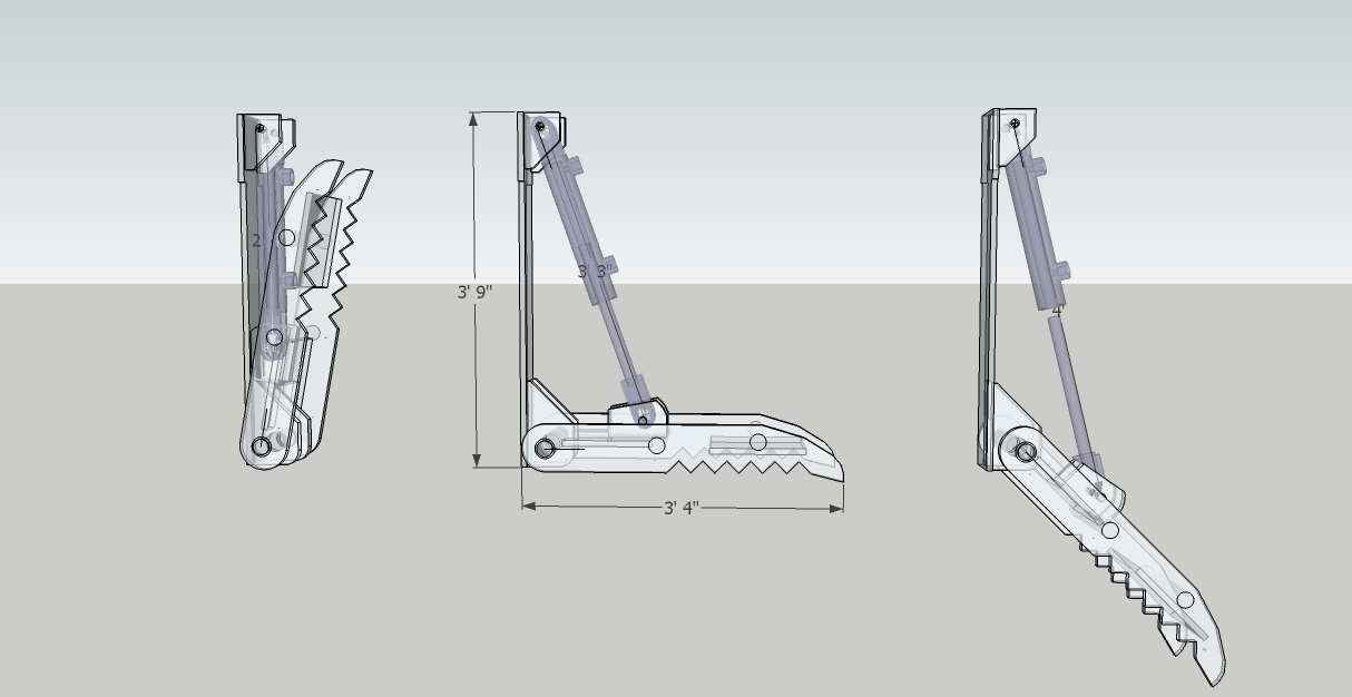

I am waiting for a measurement from my father as I do need the inside width of the dipperstick. For now, I am making the main mounting plate 5" wide, or at least that is what it is in my model. The top, is slightly wider at 6", only to accomodate the larger size of the crosstube on the hydraulic cylinder I would go with.
I am building it with all the specs for a hydraulic setup, then, I will modify it to be a manual thumb by simply adding one more bracket a bit lower on the mounting plate, plus of course some sort of stiff arm to hold the thumb at the proper angle. The reason for this is so if I decide to make it hydraulic, it will simply be a matter of buying a hydraulic cylinder and pinning it in...well, minus all that plumbing of course :laughing:
Here is what I have so far.
The cylinder I'm planning for is 3" bore with 1 3/4" rod diameter. Fully retracted it is 28" and extended of course is 48". This will give me a full range of motion through 135 degrees.
Here is one cylinder that I found that met my specs....
https://www.surpluscenter.com/item.asp?item=9-7712-20&catname=hydraulic
All steel is 3/4" thick.

I got the new measurements for the backhoe that I needed. The distance from the inside of the dipperstick, to the tip of the bucket teeth (with bucket at 90 degrees out) is 36".
The distance from the bottom of the dipperstick, to the top of the dipperstick, is 57 1/2". This is the face of the dipperstick that I will mount the thumb plate to.
The width of the inside of the dipperstick, is 5" at the bottom, and tapering out to 7" at the top.
I know these numbers don't seem to mean much now, but the will as the build gets going. I am mostly writing them down here so I don't lose/forget what they are later. :laughing:
