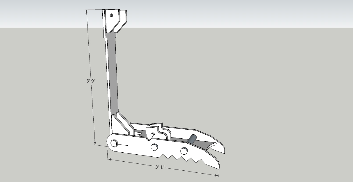

Here is a drawing of the final plan I'm using.
The back mounting plate (that I will weld to the dipperstick) is 3/4" thick, and 45" long. I chose 45" because I can cut it in half, and still fit it into the largest flat rate shipping box they offer, which is 24" long.
The thumb portion itself is now 37" long. This will also work well (geometrically) with the cylinder I will be using. It will allow a full range of motion through 135 degrees.

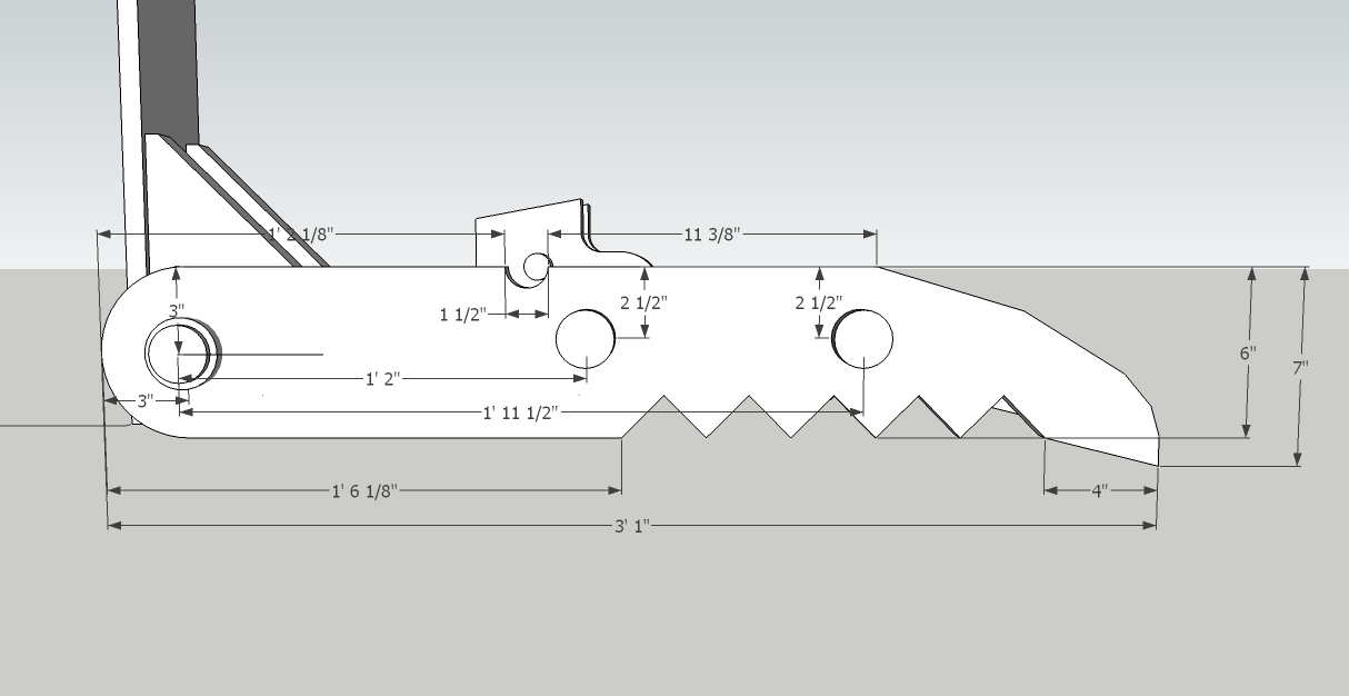

I got started on the thumb the other night. I started off cutting the main side plates. I used 3/4" steel, and laid out the dimensions using my sketchup drawings and measurements. I'm by no means a pro at using cutting torches but I'm certainly getting better :laughing:
Sorry no pics yet.
Here is a drawing that I used to lay out my side plates. I was able to get both side plates cut, and the main pin hole cut out. I still need to cut out the two support pin holes, for the support pins I will be using solid 2" round steel, 13 1/2" long, this way the support pins will stick out about 3/4" on both sides of the side plates, allowing me to weld the pins to both the inside, and outside, surfaces of the side plates.

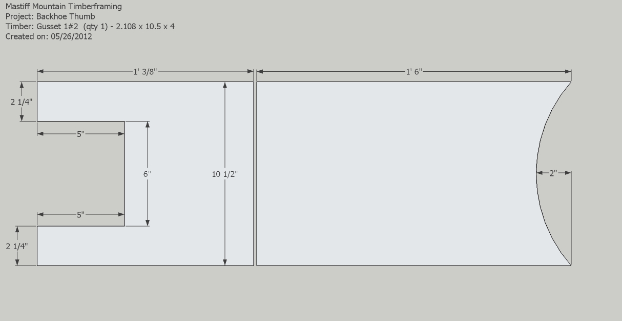

I cut out one of the two 'gussets' as I call them (don't know what they should be called but their in my first pic) I still need to cut out the larger gusset. (The one on the right in the first pic)

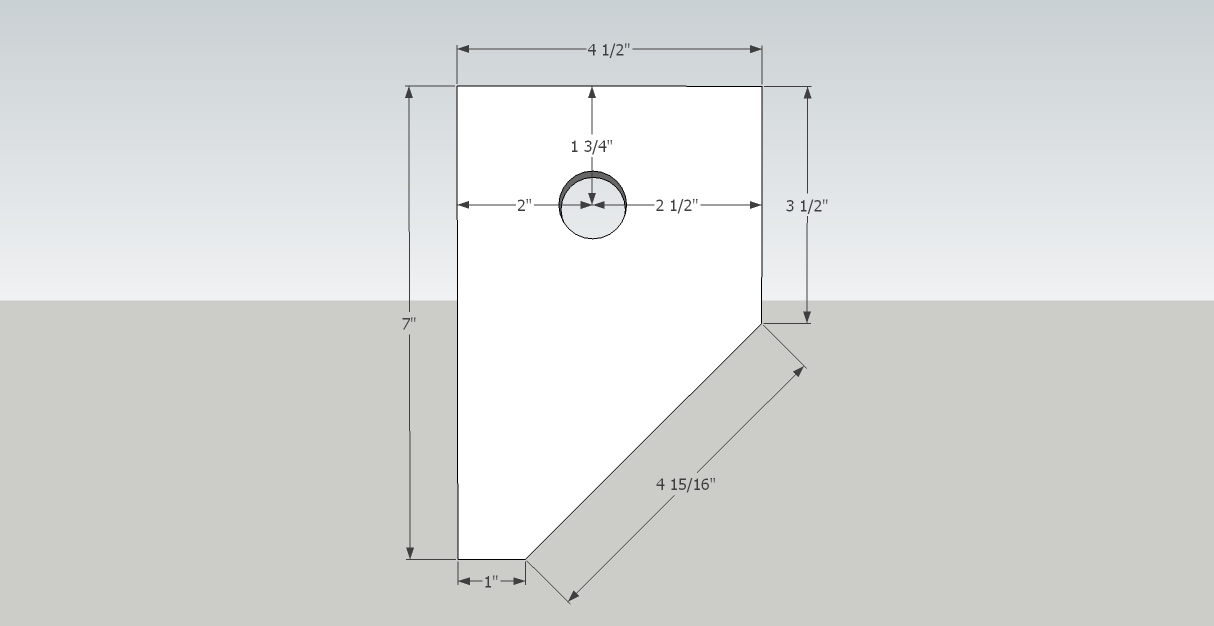

After that, I started on the brackets. I cut out the 2 brackets that will be used for the top mounting position of the hydraulic cylinder, as they seemed the easiest to make. Again, I used the sketchup drawings and dimensions to lay these out, and cut them with the torches. The only step left in these brackets is to drill out the hole for the 1" diameter pin that will be used to secure the cylinder.
This is where I stand as of now. Hopefully tonight I'll get some more work done if I'm not too tired. So far I have 3 hrs in the first night, and 2 and half last night.

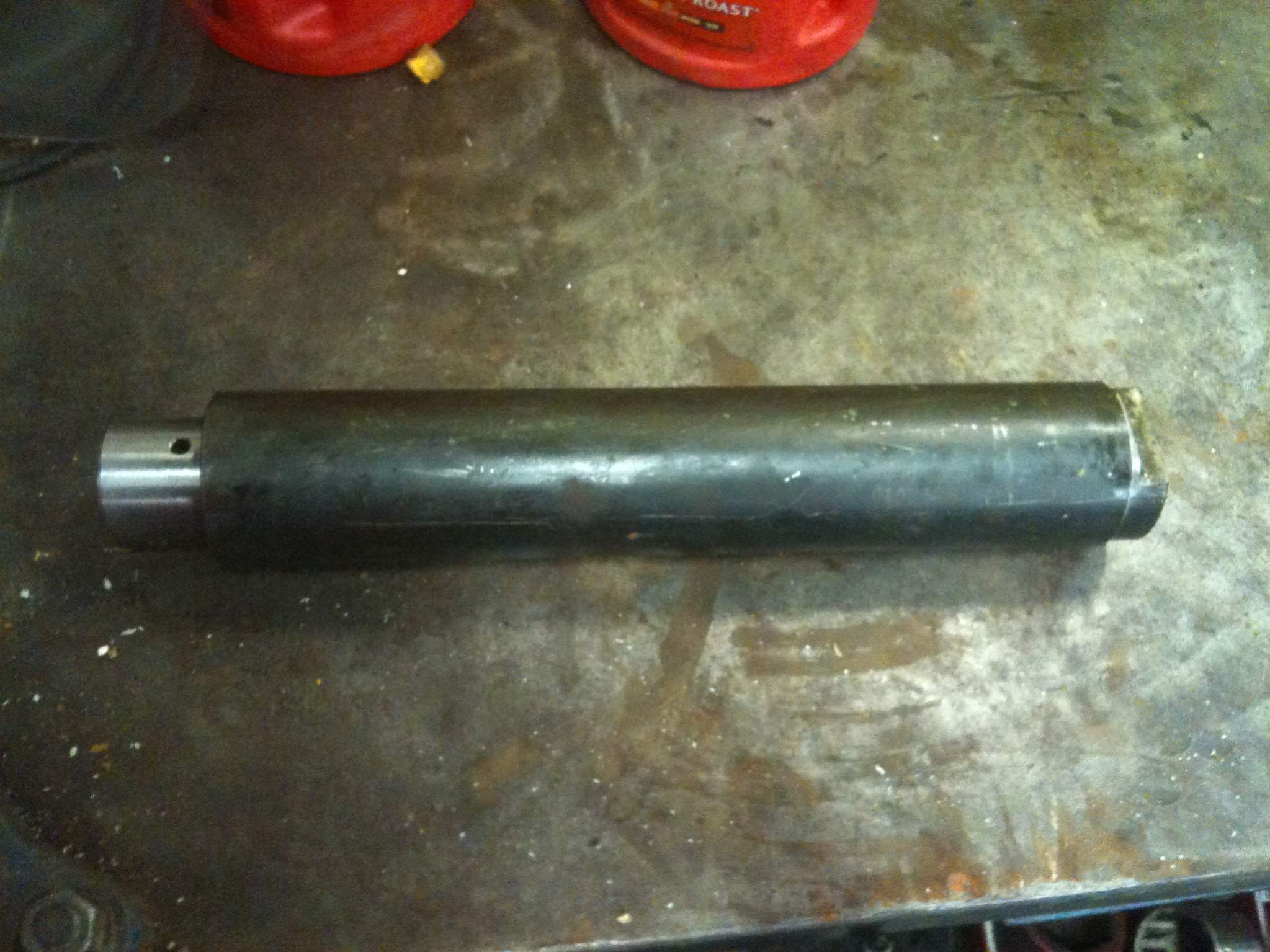

Over the last few nights I got pretty much all the steel cut that I will need. I cut out the 2 3/4" inch holes for the main pivot pin with the torches, and tonight I will try to grind them down a bit to make the pin fit a little better, they're a little ugly right now from my lack of expertise in torch cutting!

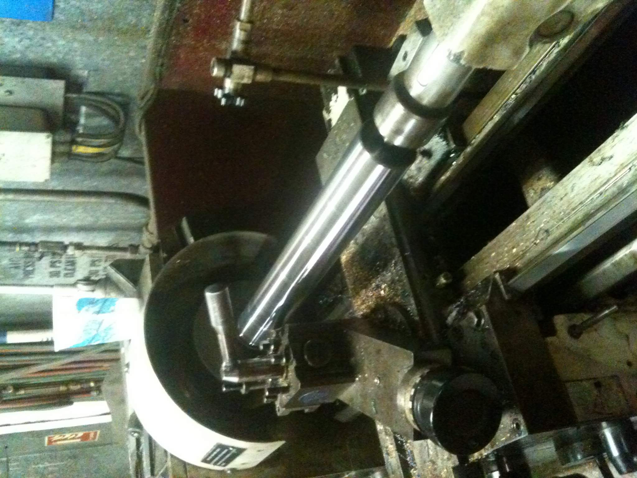

For the main pin, I'm using a 2 3/4" OD piece of thick wall hardened steel pipe. I was able to scrounge up an old pin that was replaced in some heavy equipment, it measured 15" long and a little over 2" diameter, which was too large for the inside diameter of the steel pipe that it will be going through, so a friend of mine put it on the lathe last night and turned it down to fit with about 30 thousands of an inch of clearance, just enough for grease to squeeze through (the pin has a zerc fitting on the end and grease holes throughout)
It's one of the few pictures I managed to get on my phone so I'll post a pic of the pin, and then a pic of the pin inside the hardened steel pipe that will become it's home. :D
The only steel I have left to cut, is the main gusset that will fit between the two thumb sides, connecting them together to give them strength. Aside from that, the remainder of my work will be grinding everything to the right fit, and grinding some bevels on the ends of the steel so I can get good penetration in the welds.
