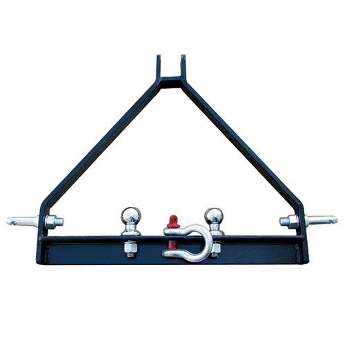

I need to haul wood. I am hope there is a trailer that will somehow bolt to the tractor.
You need this type of adaptor for the Three Point Hitch.
VENDERS: TRAILER HITCH TRACTOR DRAWBAR THREE POINT KUBOTA handi | eBay
You need one sized for the Kubota BX tractor. It should fit yours.
You need a 20" (+/-) width, NOT 28".
