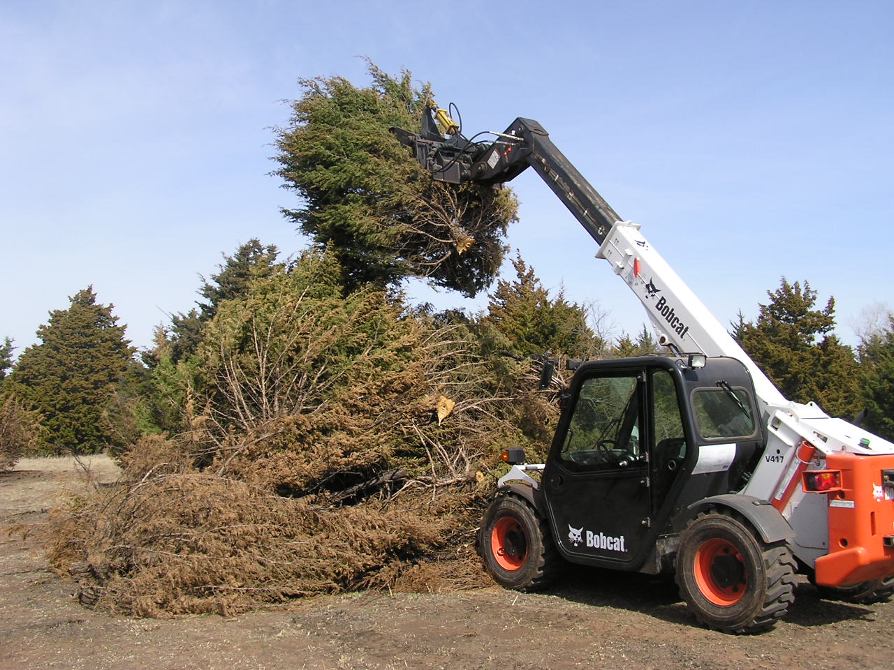

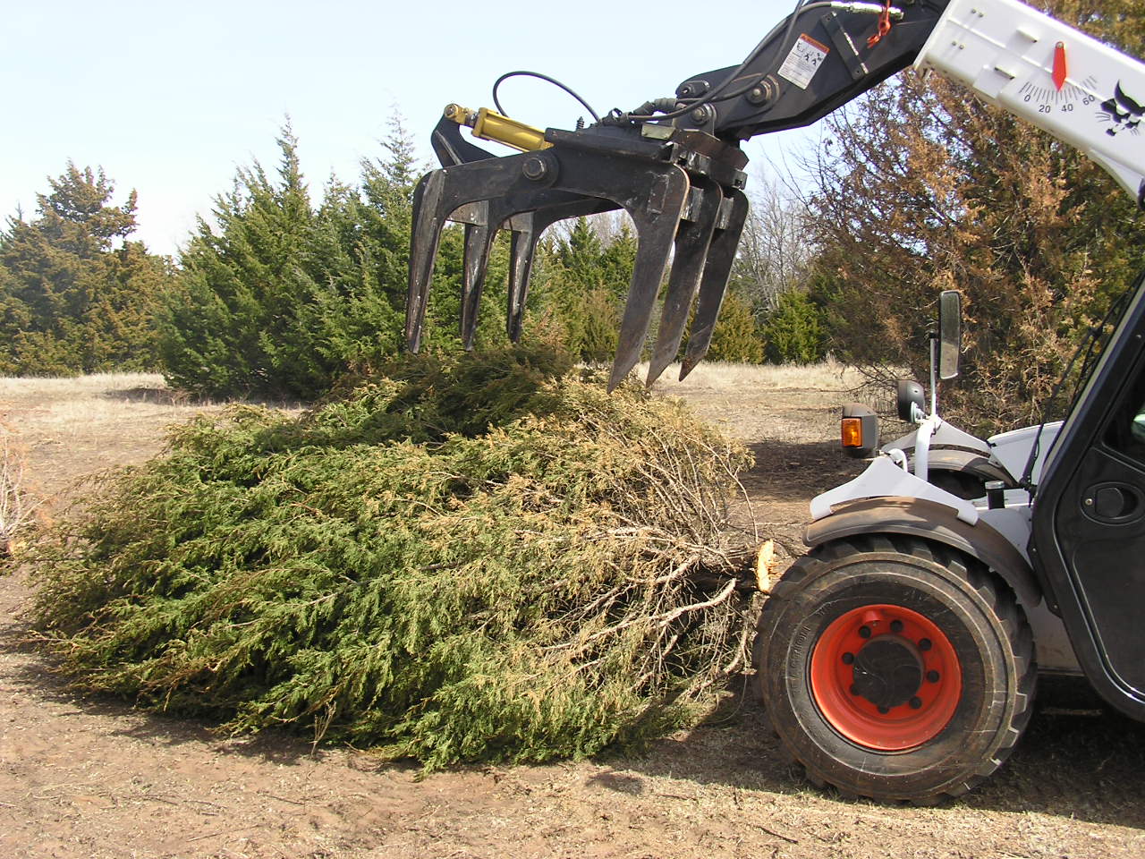

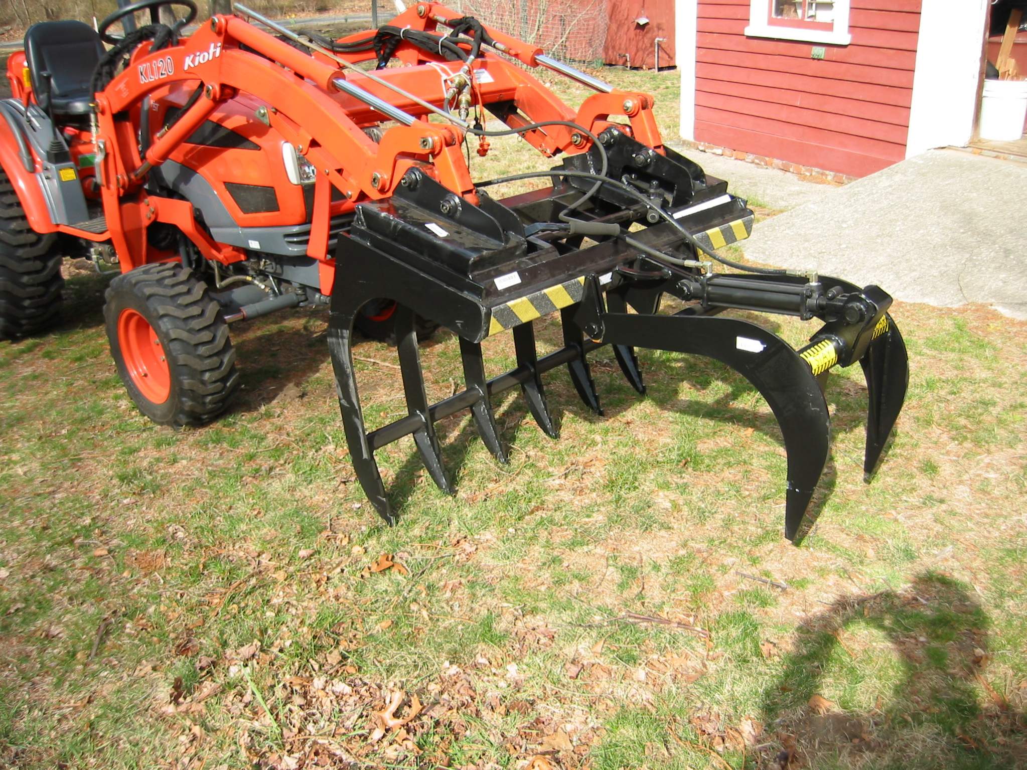

I bought the small grapple for picking up sheared cedar trees. It has no bracing between the three tines, so it will penetrate the tree no matter what angle the trunk is at.
Then we moved 3 years ago and now I need to pick up brush, so I got the big grapple with a 51" opening.
For a small tractor, 30" would be the minimum, but 40" or more would the best. :thumbsup:

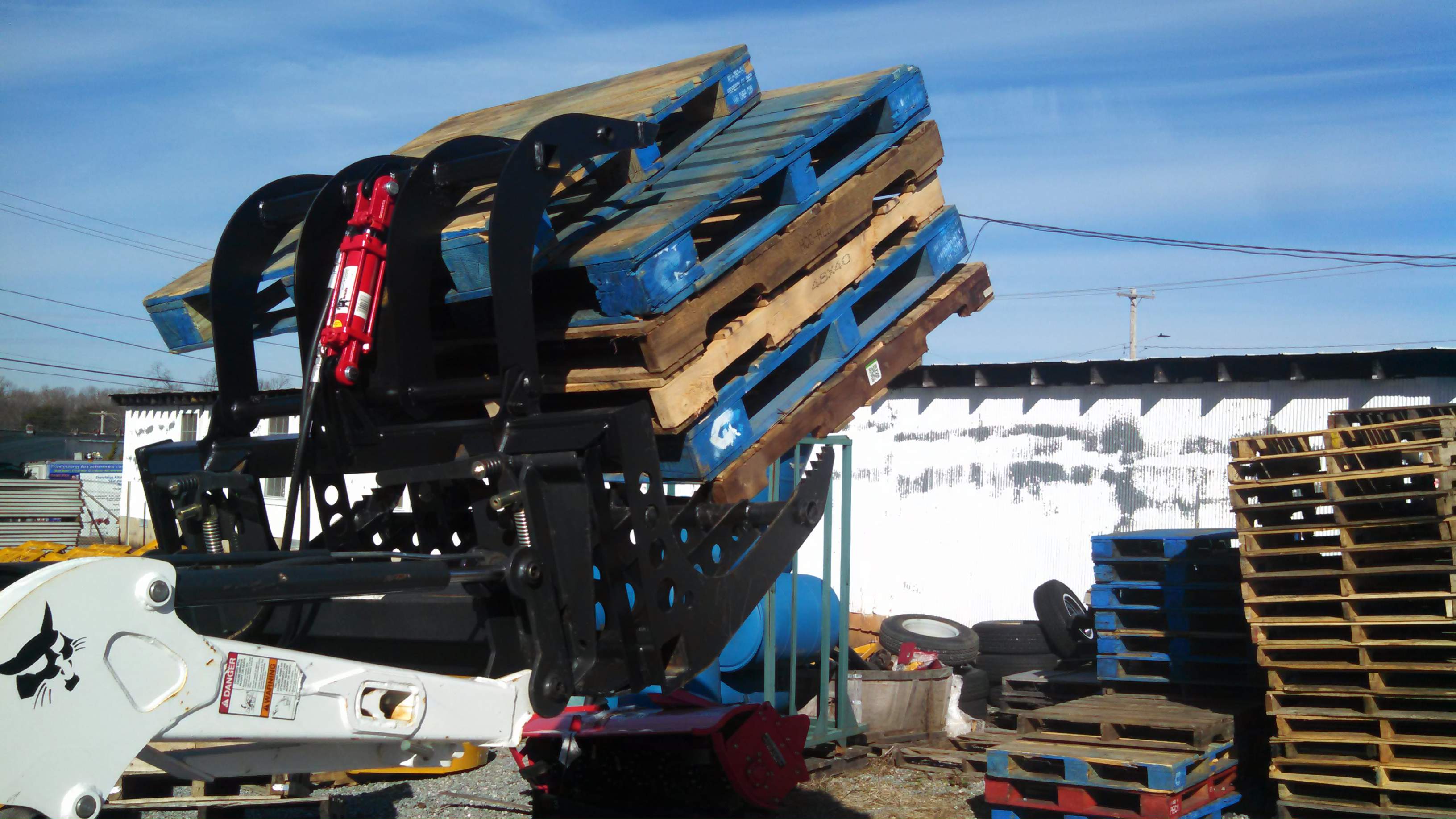

I noticed that a 50" Grapple was hooked to the little Bobcat earlier, so i went out to see what i could pick up. With no counterweight and lots of shiny attachments lying around, the choices were limited.
I did grab a few pallets though.

Good demonstration of the point we have been making. You got six stacked pallets into the grapple and lifted them. What does one pallet weigh??? Maybe 50lbs or so???? Six times 50 is 300lbs. The loader on any tractor bigger than a SCUT will lift 700lbs at least so you are effectively leaving "money on the table" with regard to the weight of the load lifted in the grapple. You guys tested the EA50 with the CT122 and I know that tractor can lift upwards of 1000lbs. If the opening on the grapple were 42' instead of 30", you could have loaded and lifted maybe another three or four pallets.
With brush the issue is entirely what volume, not weight, you can cram into the grapple maw. We all learn to roll up and crush brush to minimize bulk but there is zero question that you can carry a lot more brush if the opening is bigger.

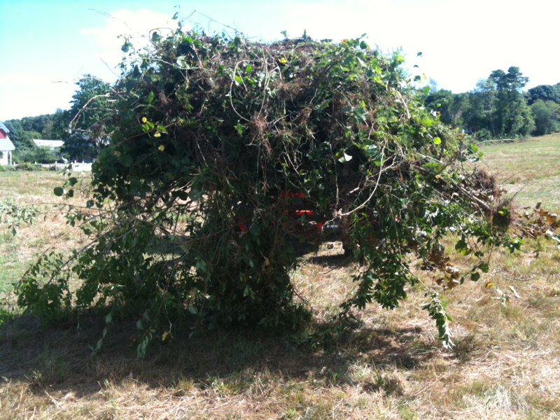

With brush, unless you have it by the center trunk, it is liable to fall out. Case in point: in the photo I supplied, I grabbed a pile of brush, and due to its twigginess, 2/3rds of it was hanging by weak branches that dragged, then broke, or got run over by my front wheels and then broke (because I'm not using a telehandler, which is a completely different kind of machine that can extend the grapple far out from the front wheels for a better grip) so that by the time I got to my dump trailer I was carrying a lot less than what I had initially grabbed.
A scaled up version with longer everything (not just larger uppers) and a wider opening that can still pinch would be more efficient for handling brush.
