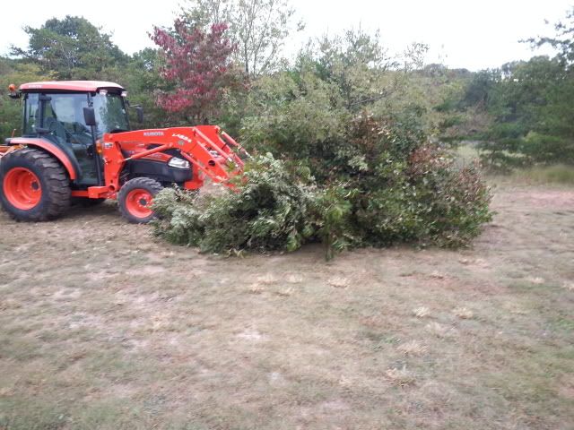

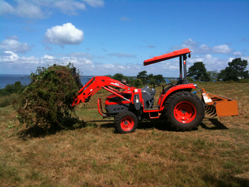

I think for 90% of the time a larger opening a grapple for a CUT would just be for bragging rights.
If I have a big pile of brush I will pull into and push until the tractor won't push or anymore or the whole pile is moving so I have I nice full load in the grapple.
Agree with your technique but grapple opening size will still determine how much light weight brush you can get into the maw before clamping, even with your compression technique (I do the same). None of us have trouble lifting a full load of brush, volume is the issue. I could load and carry as much brush (not stumps, logs) in my CK20 (avatar) as with my DK40 simply because no load of brush weighs more than 400-500lbs tops.

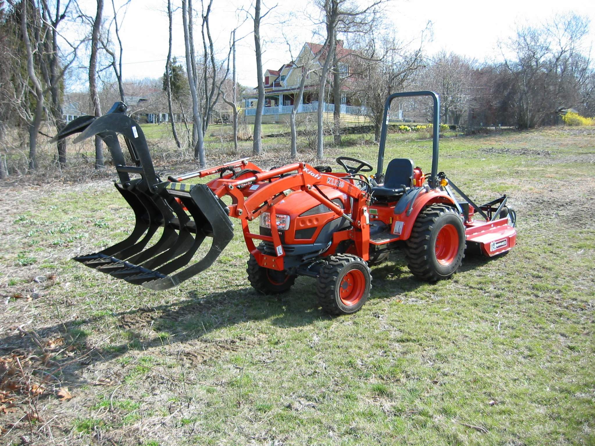

Right, the tines could left the same length, just raise the pivot point.. <img src="http://www.tractorbynet.com/forums/files/attachments/407505-wicked-root-debris-grapple-loflin-mg-jpg"/> Notice how far above the top of the attachment plate the upper jaw hinges are. <img src="http://www.tractorbynet.com/forums/files/attachments/407506-wicked-root-debris-grapple-p6060019-jpg"/>

No need to be defensive. Any grapple is a good grapple. Nobody complains about their grapple because the alternative is to use your own back. It would be like complaining about how cold beer is when you're thirsty. We are just pointing out a simple design change that would enhance an already good grapple. Put another way, why wouldn't EA want to increase the jaw opening if it was a simple change in design geometry and enhanced the brush capacity per load?
