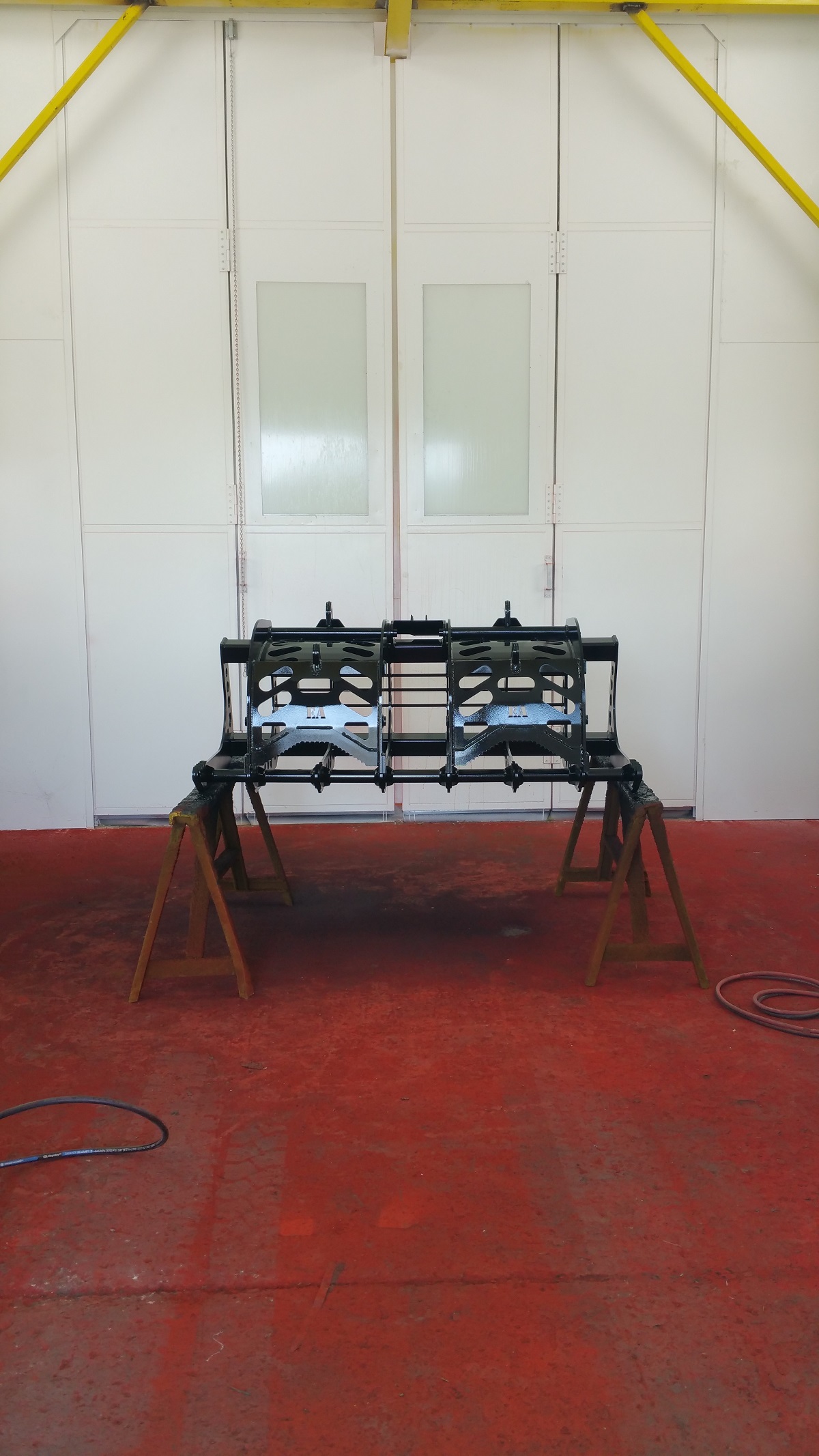

   / The WICKED Root & Debris GRAPPLE!!!!!!!
#3,513
FIRST Wicked Grapple painted in our new facility was a Dual Lid 60"...taken this morning!
