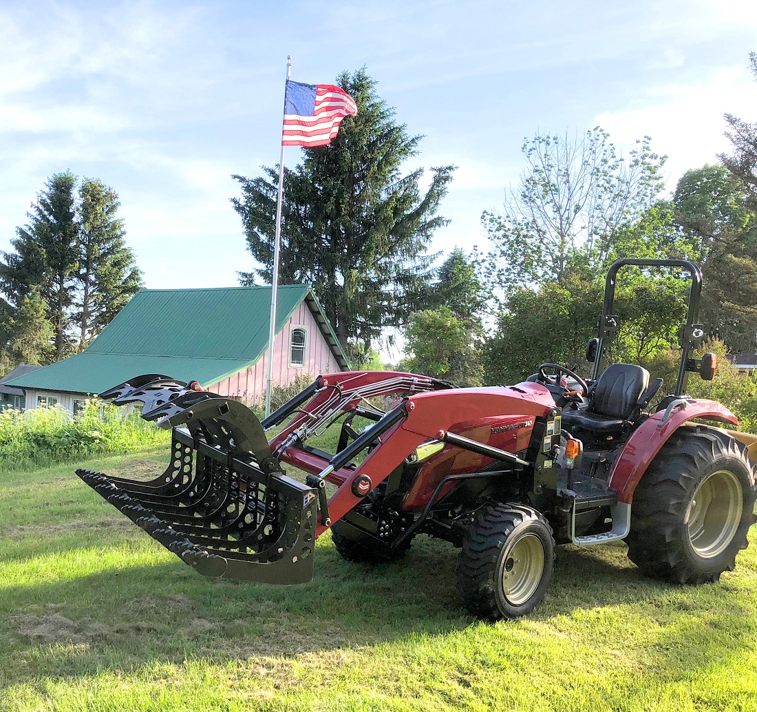

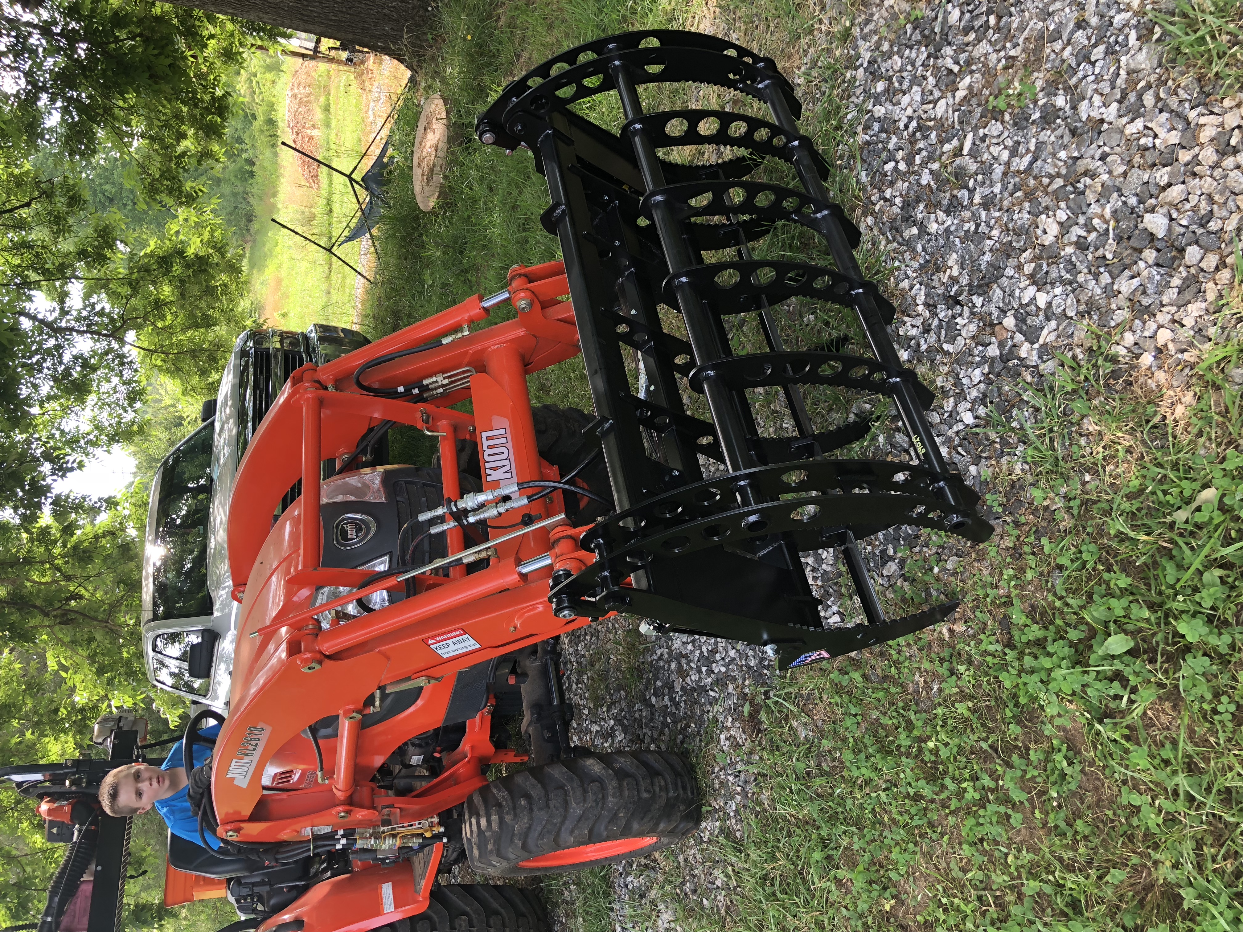

The wait was well worth it. Ordered my 66" single lid wicked grapple on 5/17 and picked it up on 6/11. The grapple is made well and is rock solid. Hoses and couplings fit perfect. Can't wait for my TA 6900 Heavy Duty Post Hole Digger to a be shipped. Thank you Ted and company for making a great product.
Good news, David. :thumbsup:
The pic is just screamin Merica!!! :drink: :applause::united-states:

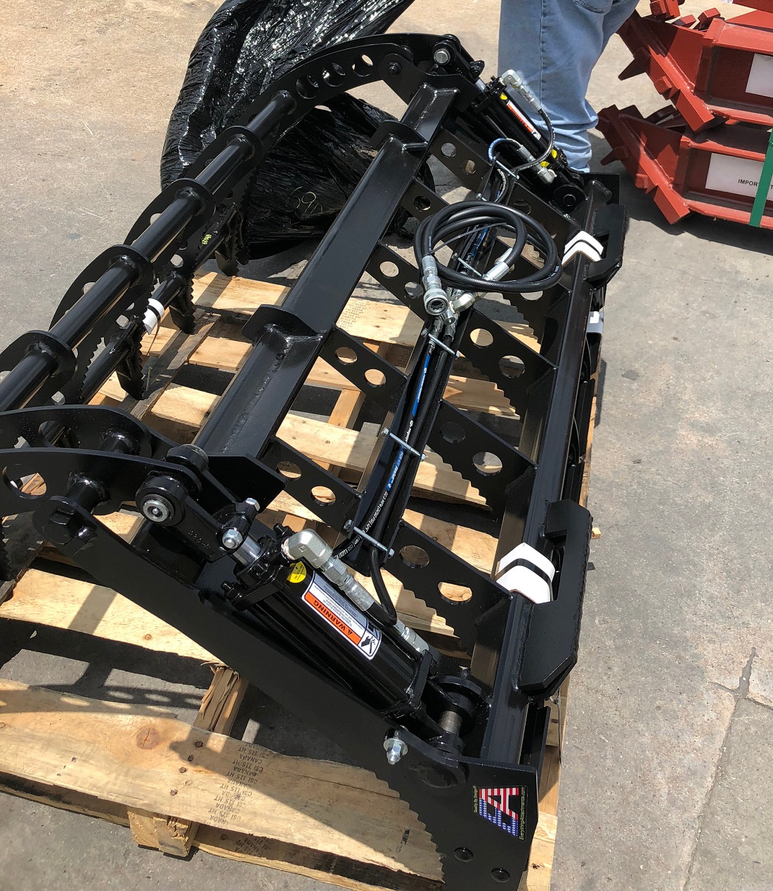

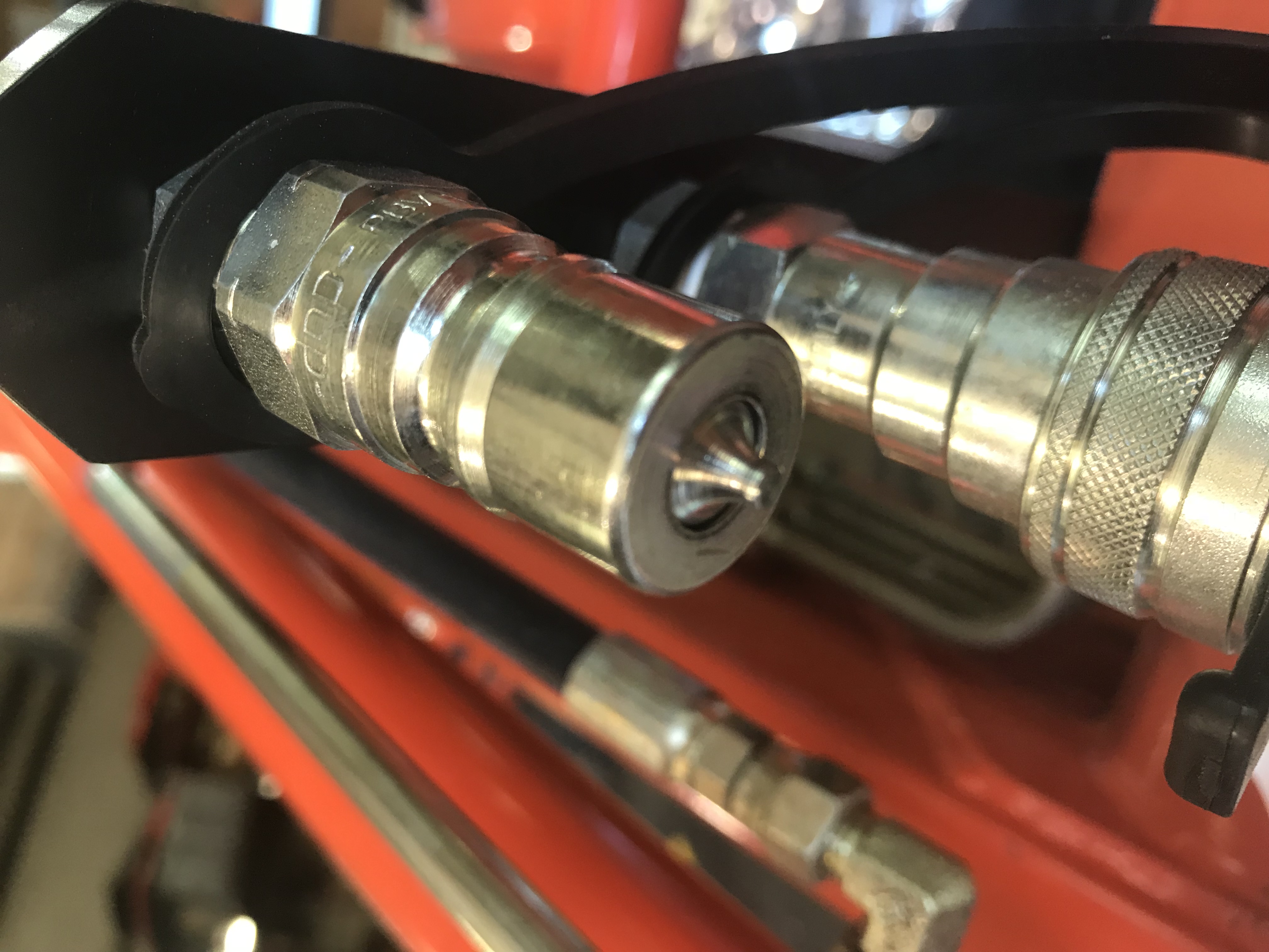

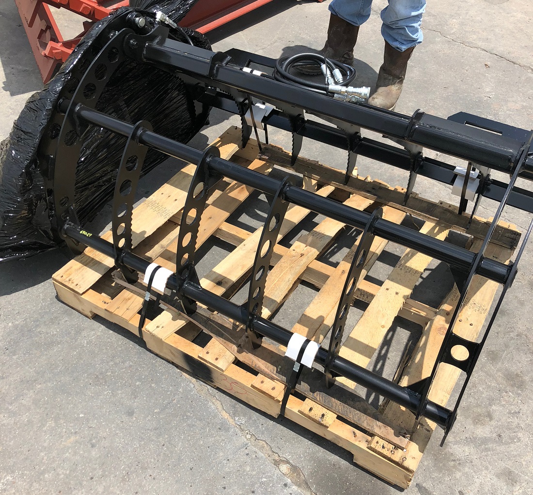

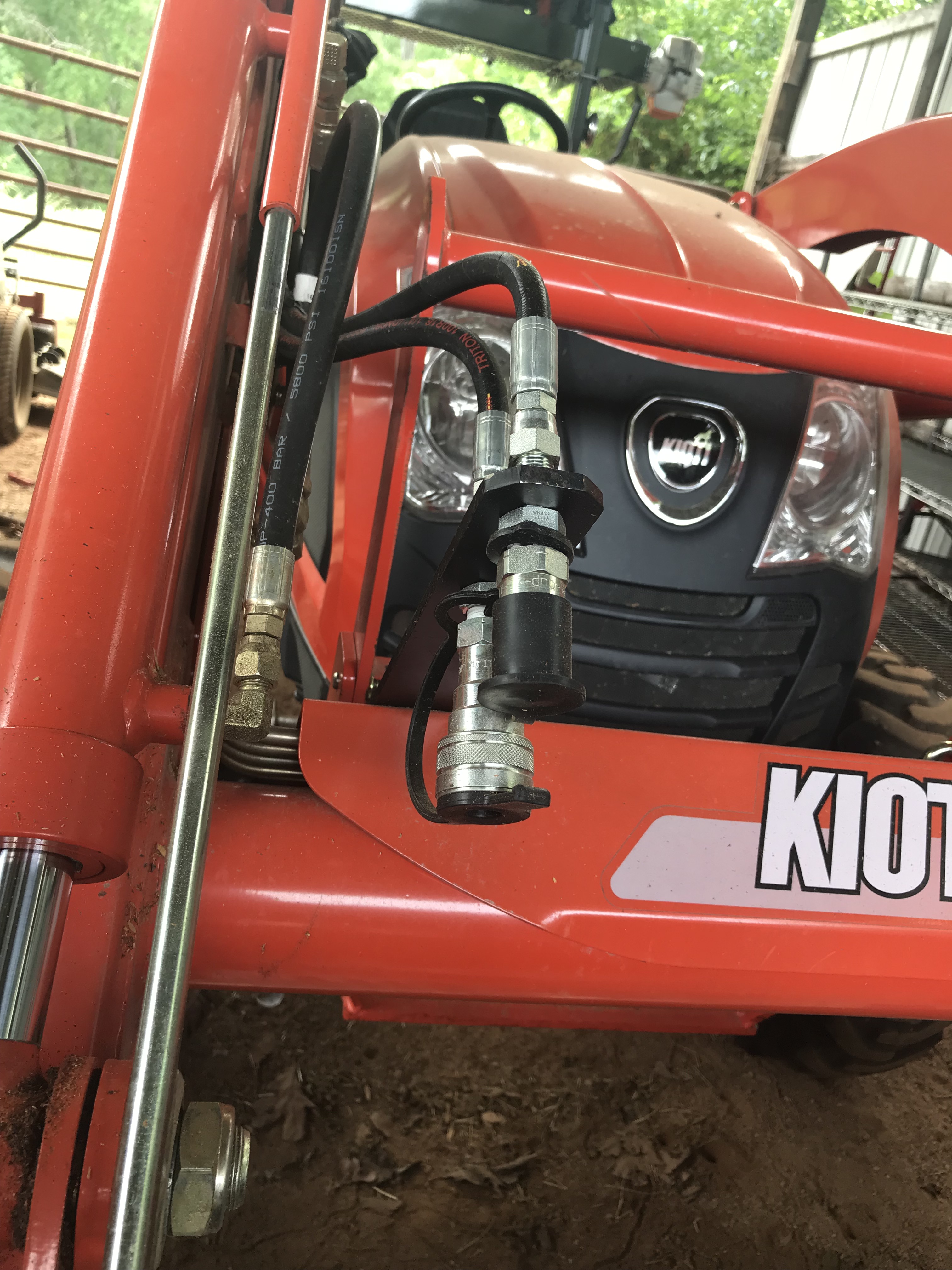

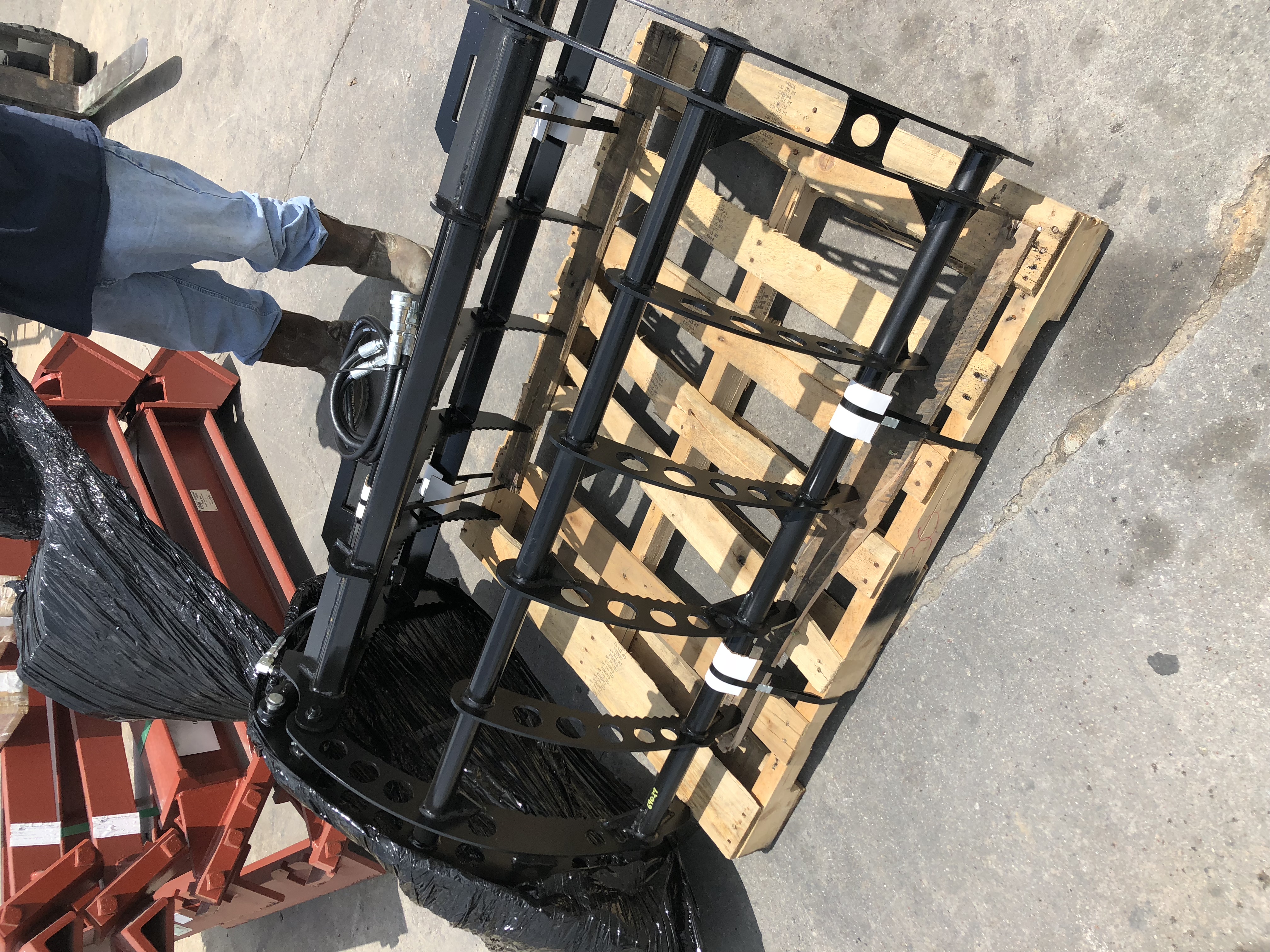

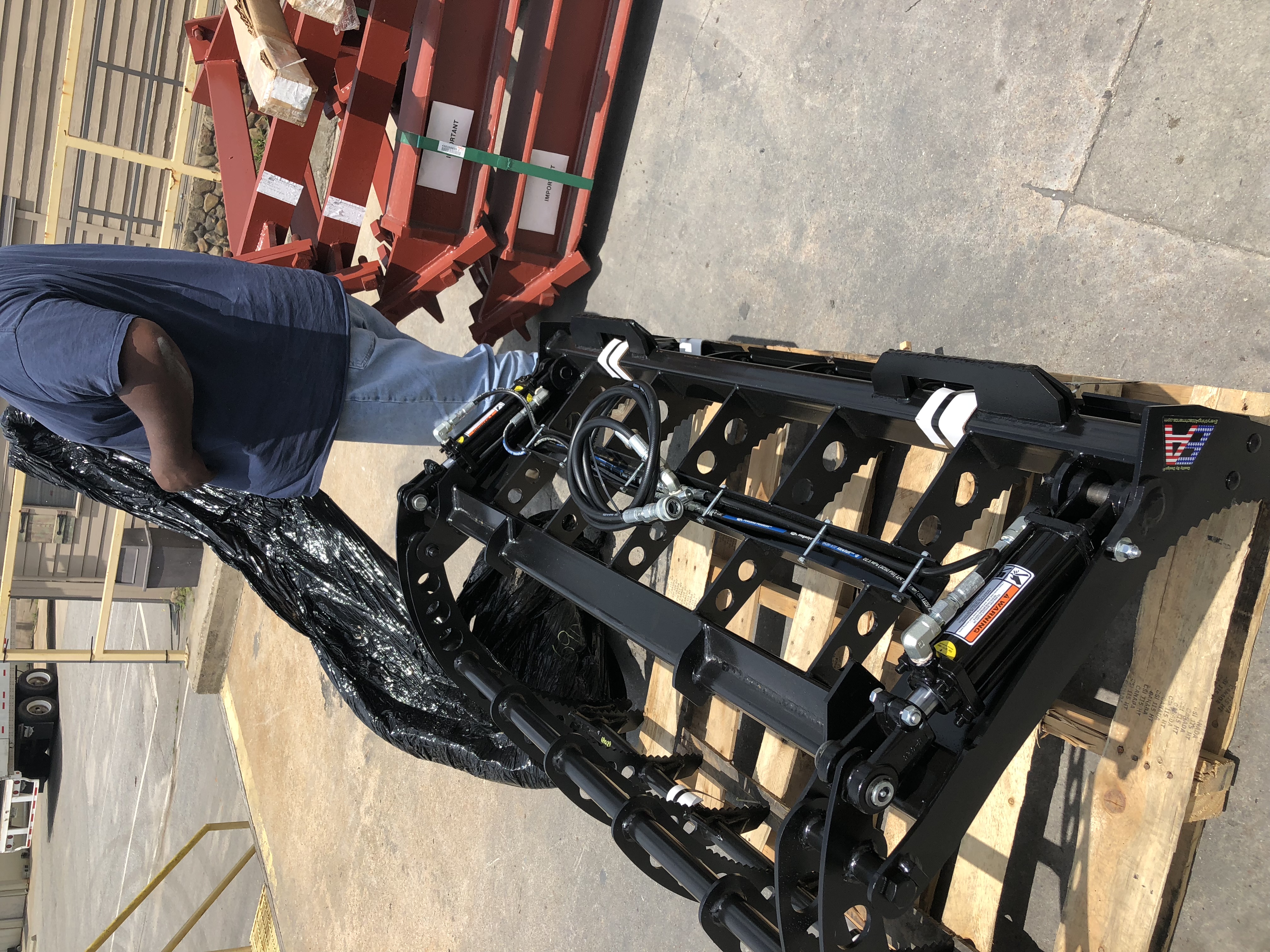

Now on the dock at the yard. The guys have looked it over and accepted it. Not sure when it will get brought down to me. Might be tomorrow... might be Friday... who knows. But its close!
From the pictures as best I can tell those appear correct quick connects. See my W R Long third function pictures also attached.
Sweeeeeeet! :dance1: Good times, easy work and a happy Kioti 2610 comin up!! :drink:
Yes, looks like we're spot on with the couplers. :thumbsup:

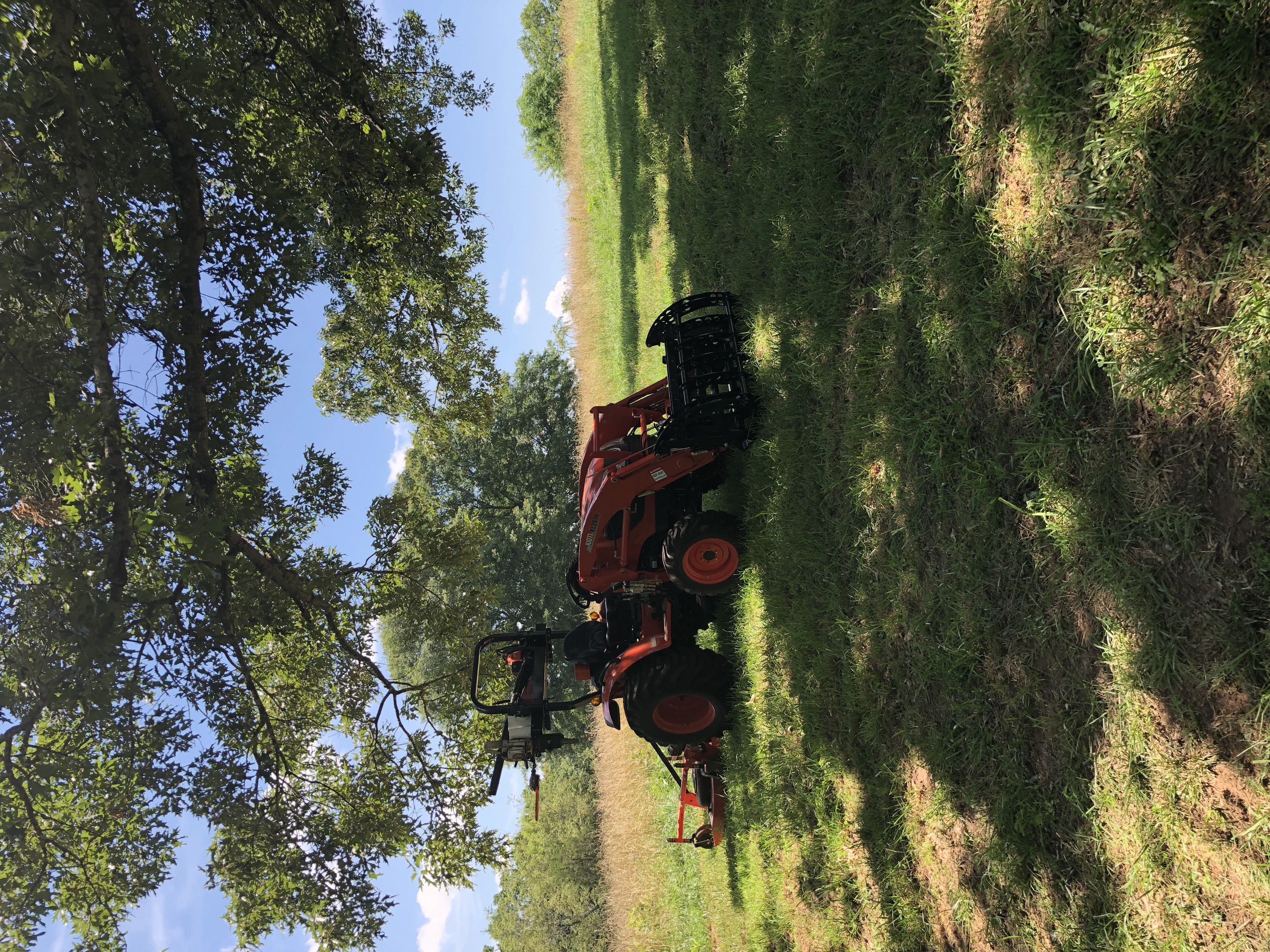

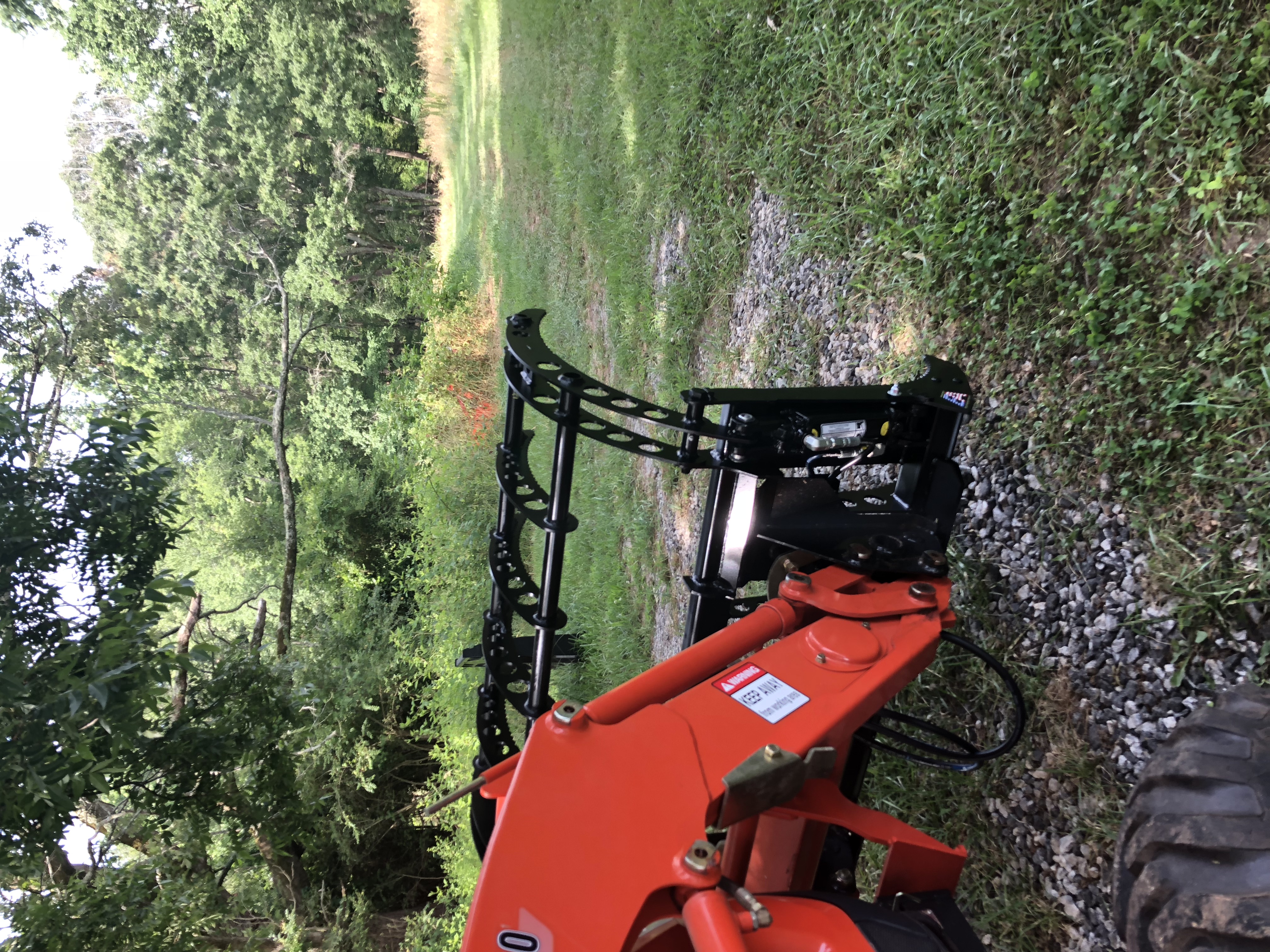

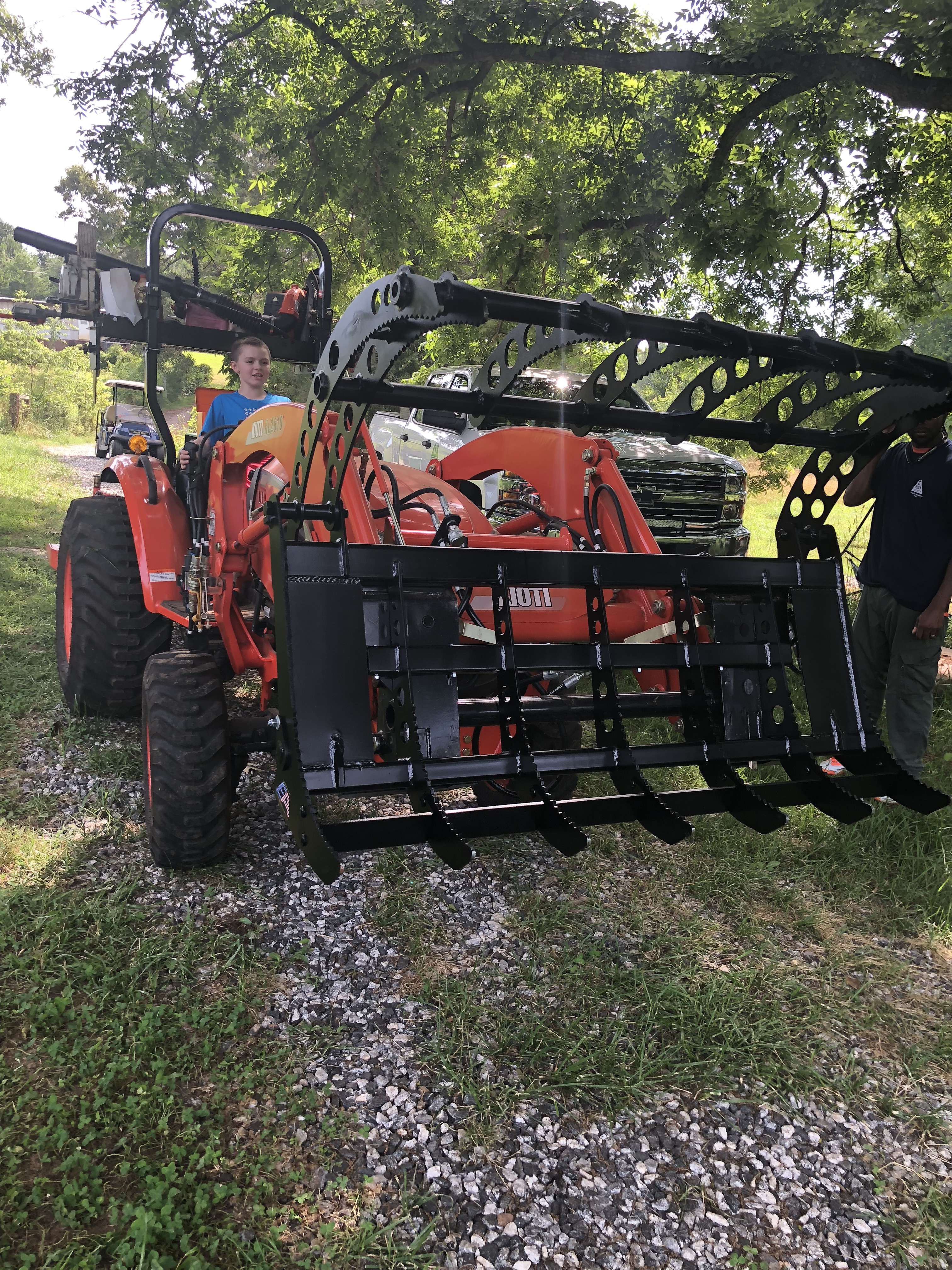

Delivered and working good.
Only thing I need to do is reverse the lines so make the operation more intuitive. As it sits now if you rock the top of the switch it closes and the bottom one opens the lid. So I find that a bit less natural of a movement. Im sure I could get used to it but why not just flip the lines. Its the luck of the draw in that respect which line does which. You can change it about anywhere.
