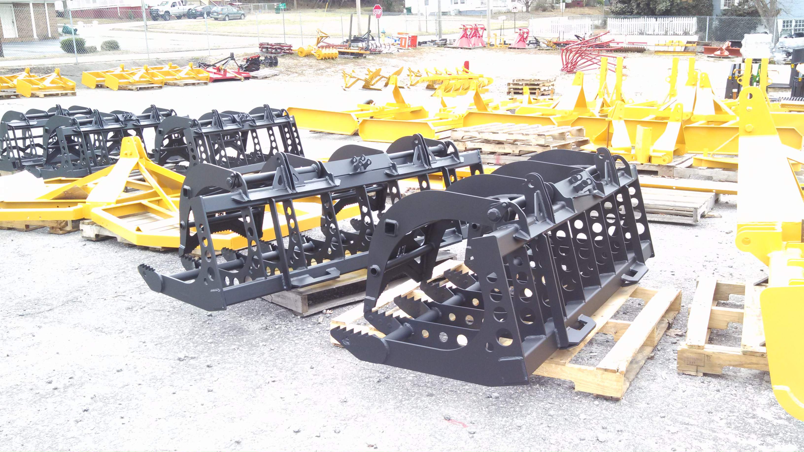

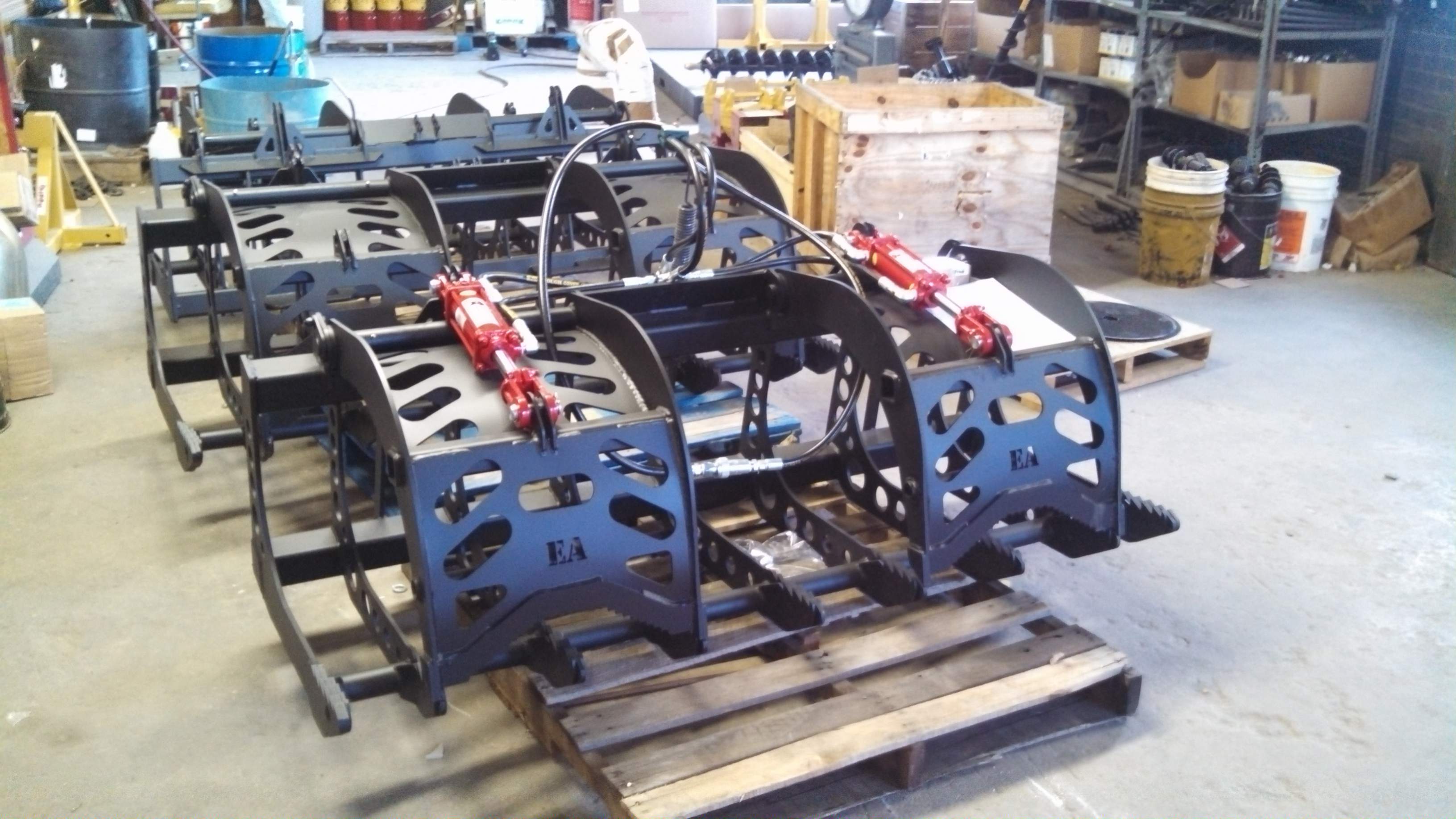

I was passing by and noticed all these Wicked Grapples that are about to be shipped out. Thought i'd share!
Travis
