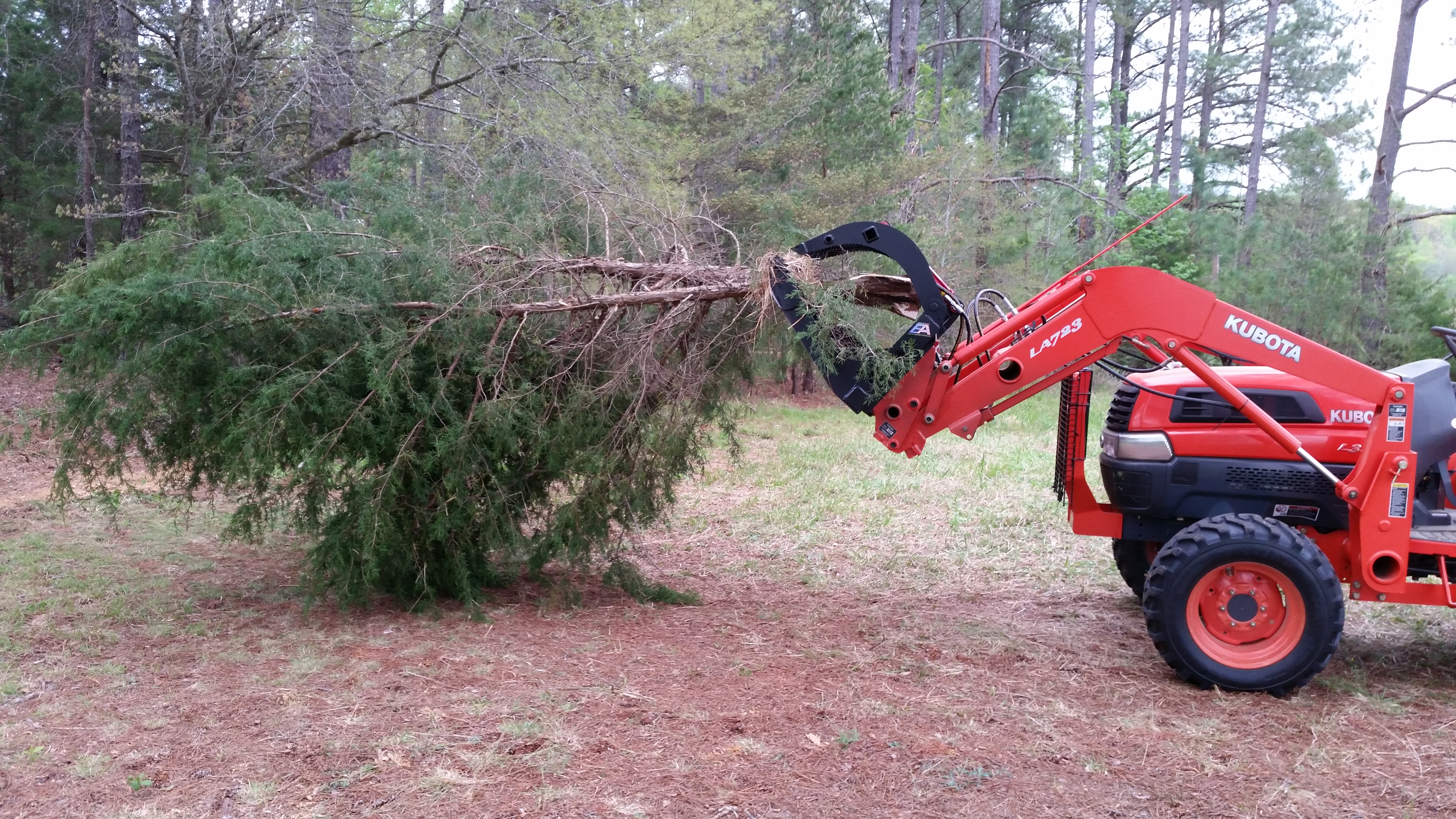

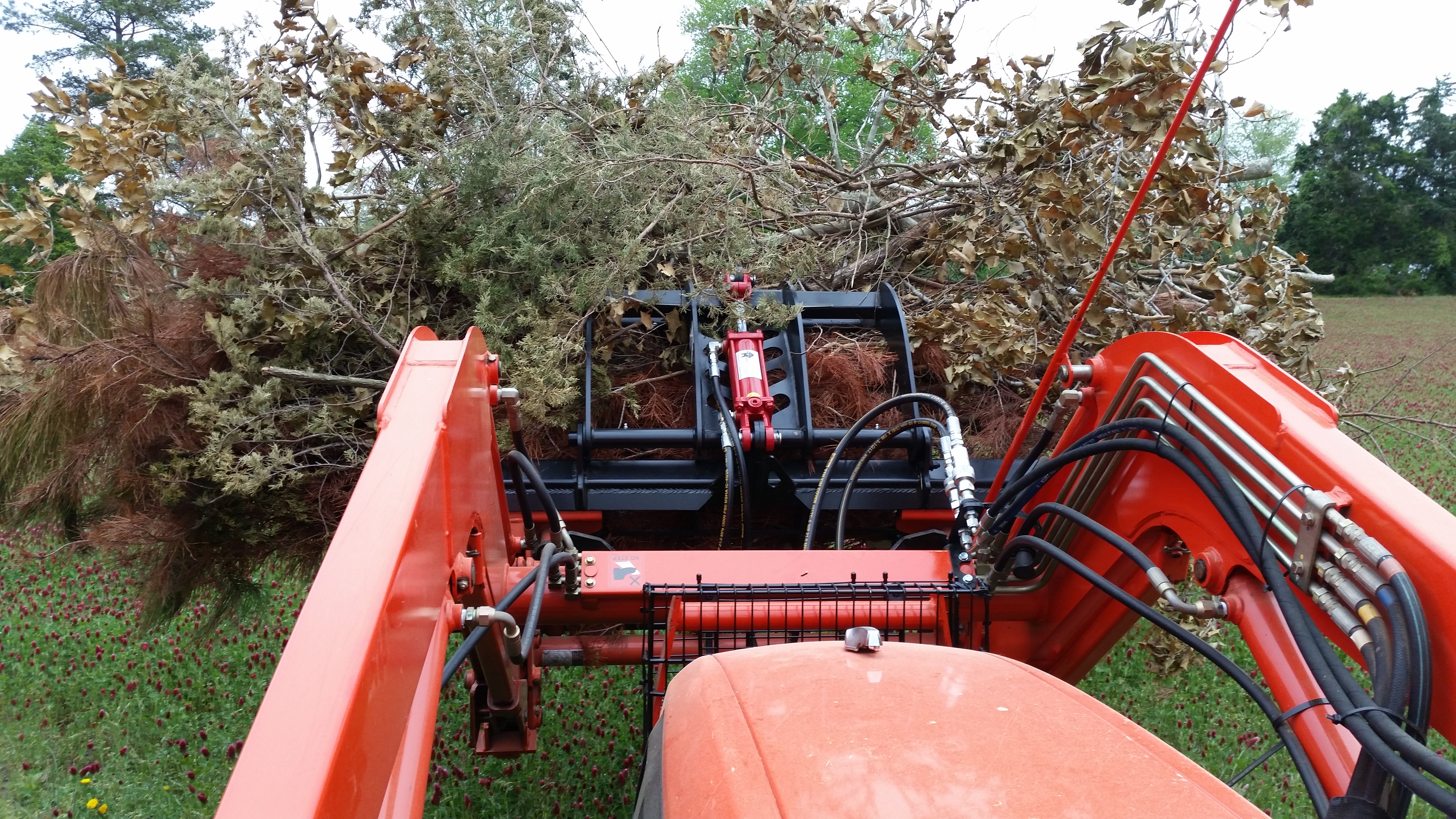

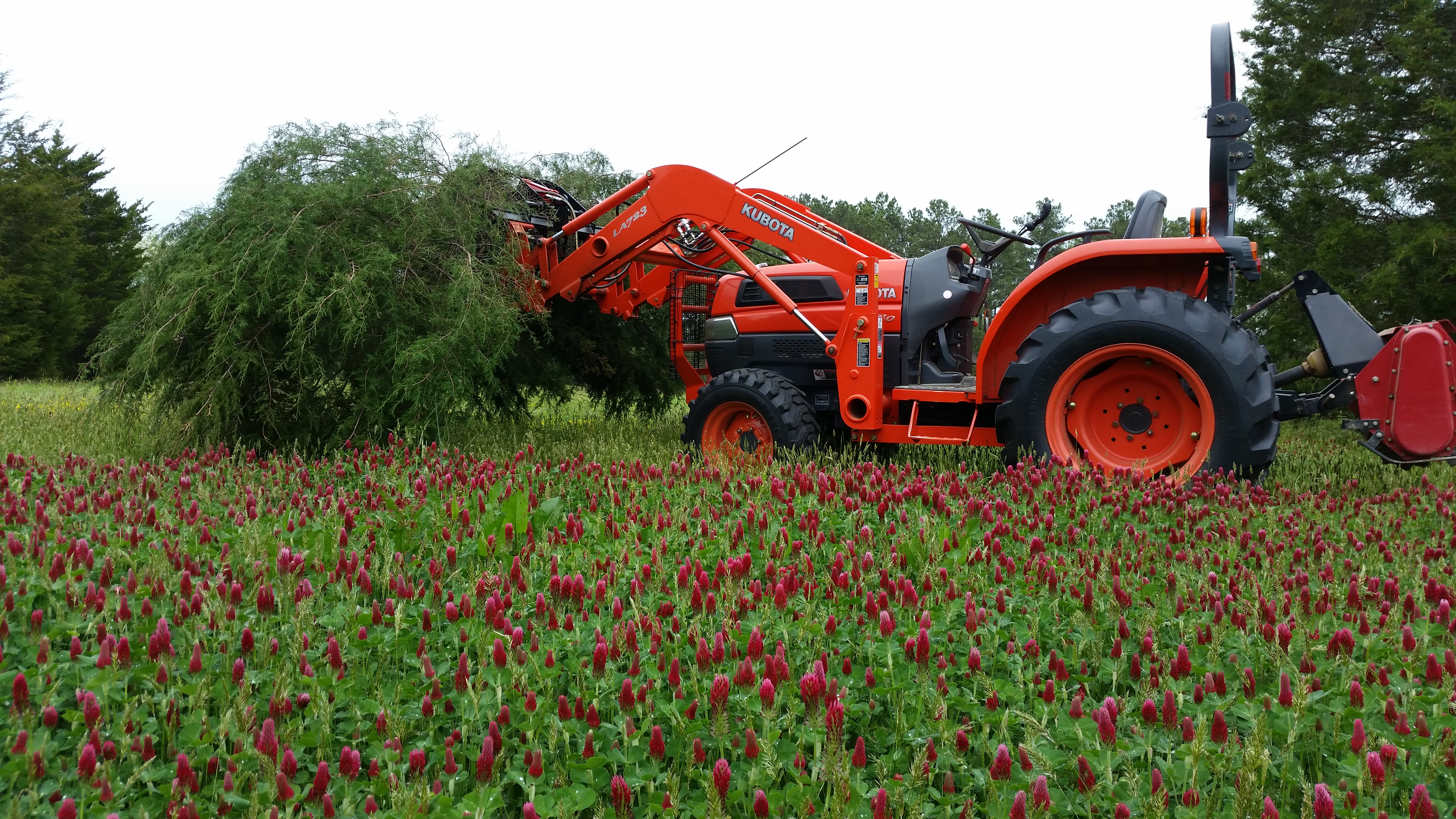

Didn't have time to post these here yesterday, but did get some more practice time with my new Wicked Grapple, getting pretty good at the "Crush and Run" technique by the end of the 2 hour session. Still lots more to do.
I was spraying clover in my lawn yesterday, but man, that red clover sure does look good in tractor pics!! :thumbsup:
