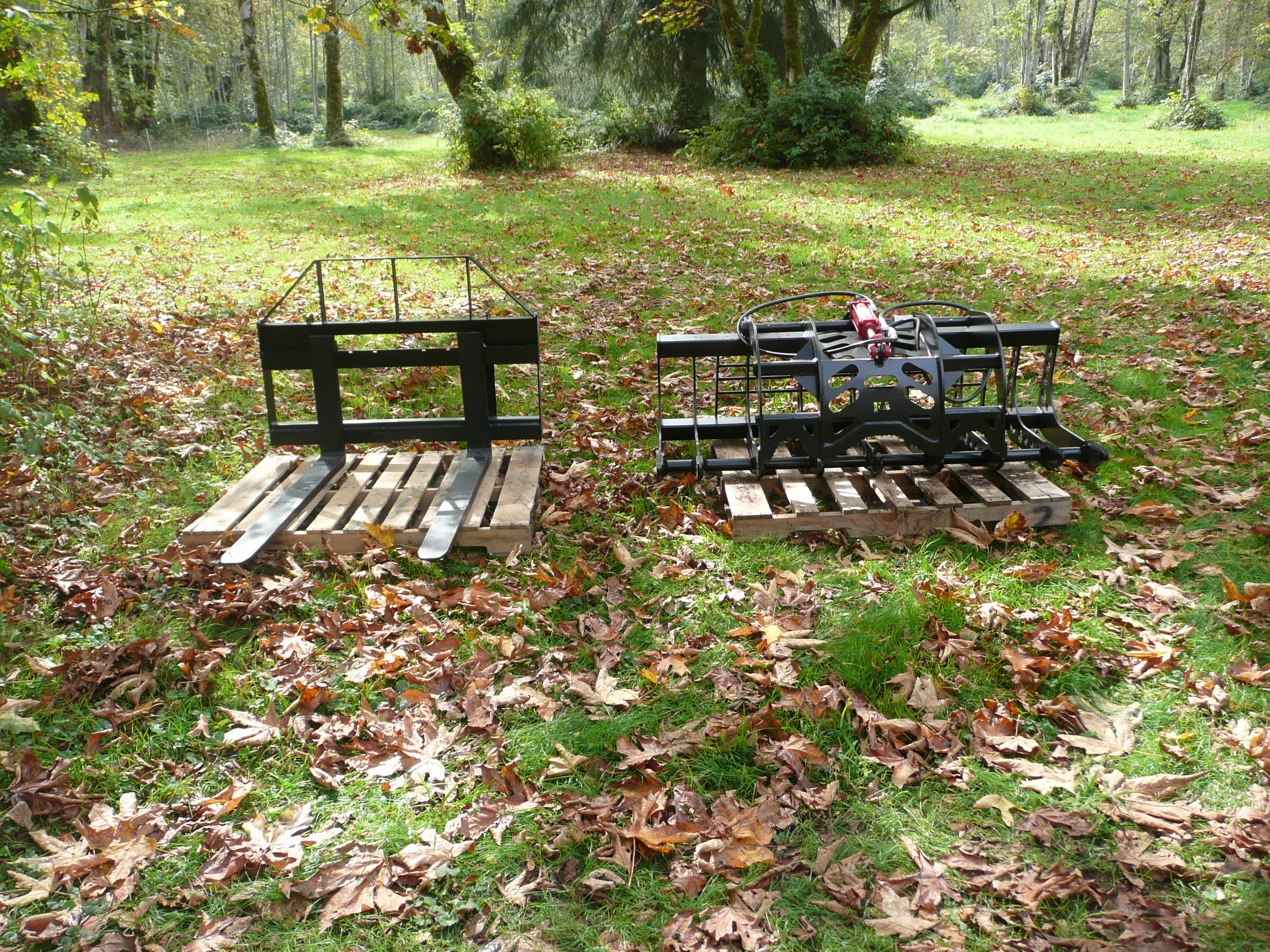

Got my grapple and pallet forks the other day and I unloaded them today.
I'm beginning to think that maybe IslandTractor is right in his thought that people tend to buy too large of a grapple :D
Both EA attachments resting on the ground (waiting for my new tractor, which, unlike EA, didn't get shipped in a timely manner!):
Don't get all worked up. I bought a 66 dual lid and am quite happy with it so far. Tight woods work is not a big priority for me so I went the same width as my bucket. I'd think you'll be quite happy with a 66 on your NX55.

There are reasons for narrow grapples and reasons for wide one......just depends on your application, don't loose sleep over your grapple being 66" I'm sure the ladies will be impressed!

As I'd previously mentioned, the reasons why I chose the 66" version is because: 1) That's basically the width of my [new, yet-to-be-delivered] tractor- pretty standard that one gets an implement the width of their tractor; 2) I constantly veer off the pathway a bit and snag blackberries (I do this with my B7800, which has a tooth bar on the bucket- it works well). If Island had to face my blackberries I'm pretty sure that he'd come to appreciate a wider grapple :thumbsup:
I suspect that most folks learn to just use what they have.

1) Everyone is happy with their grapple so your final point is correct.
2) There is absolutely no rule that says a grapple needs to be the same width as the standard bucket on a CUT. Most people have grapples a foot or more narrower on CUTs.
3) I spend a lot of time pushing into thick brush including blackberries and bullbriar. If I am in thick brush several things make the narrow grapple fine. First, I fill up the grapple within six or eight feet and need to take the load to the burn pile. Secondly, if I am mowing the grapple acts like the prow of a ship, it creates a V shape clearing that I drive through. I've never had problems pushing through thorny brush.
4) We've been through the advantages of a narrow grapple but they basically boil down to physics (applying more force across a narrower area), weight (larger net lift capacity with lighter grapple), better maneuverability and lower cost. Other considerations are that a narrow grapple is less likely to twist the FEL if you hit an immovable object with the edge of the grapple (physics again).
5) We now have hundreds of folks here on TBN with grapples, many of them with narrow like the EA 50 inch compact. Have you seen any threads discussing the need to "upgrade" to a wider grapple??? I doubt Travis gets many calls to upgrade or complain that their grapple is too narrow.
Be happy with your grapple, it will be fine and become one of your favorite implements but it would also have been fine if it were narrower.
