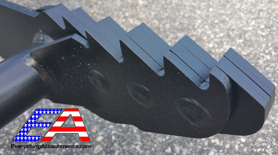

The Wicked Grapple tines promote digging into the ground, gripping and sawing roots.
It would be much cheaper and easier to simply weld triangular gussets, but we're not all about cheap and easy! :D

I forgot to say it, but AWESOME pics as always, snowback!
Travis
Wow, those are aggressive tines! I personally would not want tines with an angle that traps material. A shallow tine, like on a bread knife, would cut roots just fine when you lift. These very aggressive tines would cut mostly when you back up. Who backs up when grappling??? The sharp acutely angled tines would also make unloading vines and briar tough as the material would snag rather than drop. IMO tines should be serrated like a bread knife or an inverted W so material can slide off not acutely angled like a fish hook.
I also don't see how these sharp tines would make digging any easier at all.

A bread knife saws back and forth. We plunge the grapple into the material, grapple, lift and backup. We want to hang on to what we've got and tear our way loose. Much as the talons of an eagle hold and tear apart prey.

It may hang onto some materials, but the grip and rip are worth it in Ted's opinion after many hours spent with both styles.
Simply curling the grapple when you lift keeps material from falling out.
I've honestly never noticed the acute angled serrations on the EA grapples before and I don't think most other grapple companies use them. Mine are what I assumed was industry standard which is the bread knife type. Never had an issue holding on to debris or cutting roots.

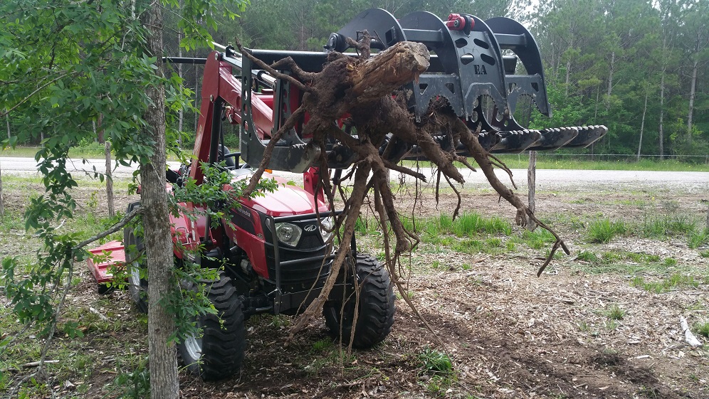

Snowback reaped the benefits!
I like that analogy! :thumbsup:
