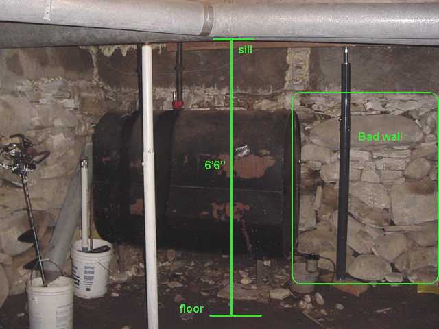

Wife and I and 2 boys are moving in to my family’s old farmhouse (1850 at least I’d guess) and one of the stone walls in the basement was pushed in by frost this winter. A friend of mine who is a builder looked at it and suggested replacing as much of the wall(s) as possible. He estimated the whole project would be about $12k (I’m rounding that to 15k just to be safe). With roughly half of that being excavation.
My brother and I are talking about getting a tractor for the farm (not a working farm but that’s what we call it). I need it for snow removal (rear mount) and have already thought of endless other projects for it. He would like it for when he comes up from NY to winch logs from the woods (ever hear of a forester from Long Island?).
Sorry about the rambling. So here’s the question, instead of spending $6,000 to $8,000 on the excavation, buy a BH with the new tractor and do the digging myself (put in as part of the home improvement loan??). Can a 7 ½’ or 8 ½’ BH do this job? Would prefer a 7 ½’ BH to keep costs down on both the BH and the tractor. I’ll post some more pictures and dimensions of the project...

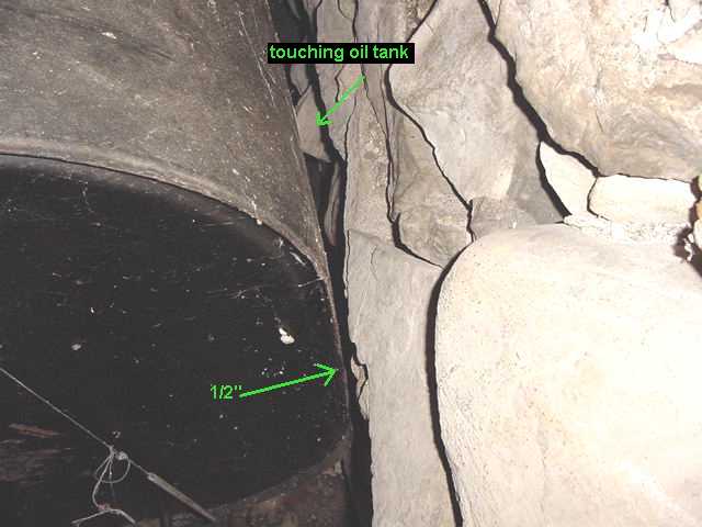

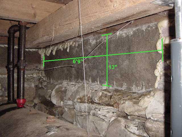

Would a 7 ½’ BH go deep enough and/or be strong enough? The sill rests on large blocks of granite that run 6-7’ long, 13-19” high, and 8-10” thick.

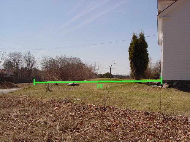

Have some room to work with in front of the house but not a whole lot. About 28’ from front of the house to the embankment going down to the road. Was thinking I would dig toward the embankment and ramp down into the basement. Does that make sense?

What is that 28' like, meaning a lot of rock, boulders, or soil that a bucket on a FEL could dig into?
I would consider digging a trench (with the FEL bucket that has teeth) along the front wall of the house (I am presuming that is the wall that needs the help), replacing the wall, and then backfilling the trench with sand and non-clay soil that is well drained with tile and that will not expand when frozen to protect the new wall. A bit of landscaping in front of the house towards the road could be tailored into the project.
I don't see the real need for the backhoe. Possibly a skidsteer would work better than a FEL, but that may or may not fit into your plans.

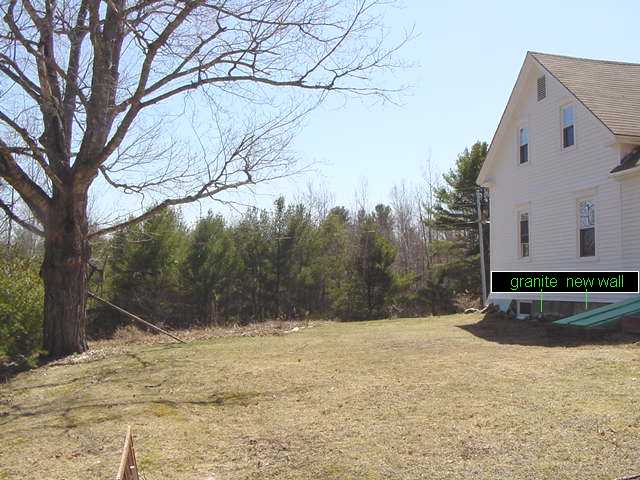

It is a very big project and probably done late in the summer (August). The bad wall is on the embankment side of the house (South face). Plan on replacing the entire corner meeting up with new wall that was put in when a bulkhead was add (see pic).
The “soil” is my biggest concern (no way a FEL will dig it with or without dentures). It is very rocky and I’m not sure what I’ll find once I start digging. I don’t believe there’s anything nasty like a ledge but could be some very big rocks. That’s why I’m curious what to expect from a BH on a CUT.
Should have plenty of help and will speak with the guy that would do the excavating if I don’t see what he thinks.

With that much area around, he could scrape off a good foot of top soil from that entire side of the building before starting, and that might make the whole production a little less deep.

The basement it's self is 6'6" deep, give or take a couple inches.
I'm not familar with a Trachoe and don't really want or need another piece of machinery. Mostly just thinking that if I have to take out the loan for the house repair anyways, that I should get as much out of it as possible ie. a BH. But of course I need to feel confident that I can do the job with the BH.

Support the house well from the inside (already looks like you are not depending on that wall to hold it up, given the steel posts shown in the pics).

We believe this little flower bed is the culprit (see pic). It was put in last summer and is right where the damaged wall is. Must have let more water into the ground creating more frost?? But the place has stood for at least 110+ years or more and is otherwise is in incredible shape. All floor joists, carrying beams, etc are dry and rot free (or at least very good for a house this old).
The house itself sits up on a hill and water drains away on all sides. I don’t believe drainage will be an issue once it’s done and filled properly.

Go for the BH. You of course have to support the floor joist just inside the wall. You won't need to dig toward the bank. dig parrallel to the house about 36" out. that's all the room you need for a man to work on the outside of the wall. Most of the work will be done from inside. As for logging... A BH with a hook on the bucket and a few good chains works as well or better than a winch. Sometime a little slower, but more control since you can draw straight in or swing left/right as needed to snake a log out. You just shorten the chain with each draw towards the tractor. You also get some lift when you need it. I've done it this way for many years, and wouldn't be bothered with a winch. Also chains won't wrap around your neck like cables if they break. With that property you'll soon wonder how you ever lived without one. Pulling stumps, digging ditches, burying whatever?, planting trees, loading trucks/trailers. moving all sorts of things. All in all an indespensible tool. Like a third hand.
