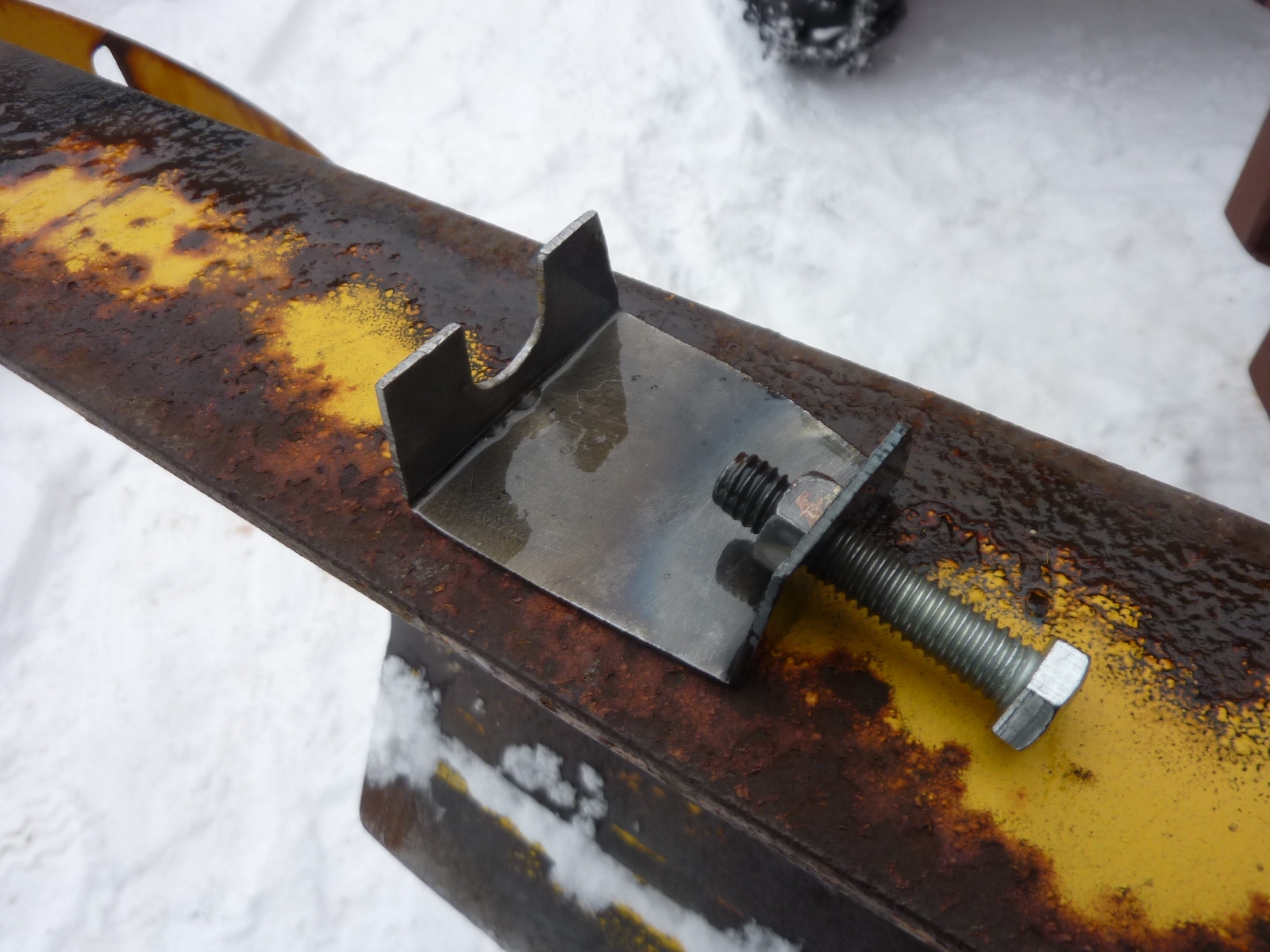

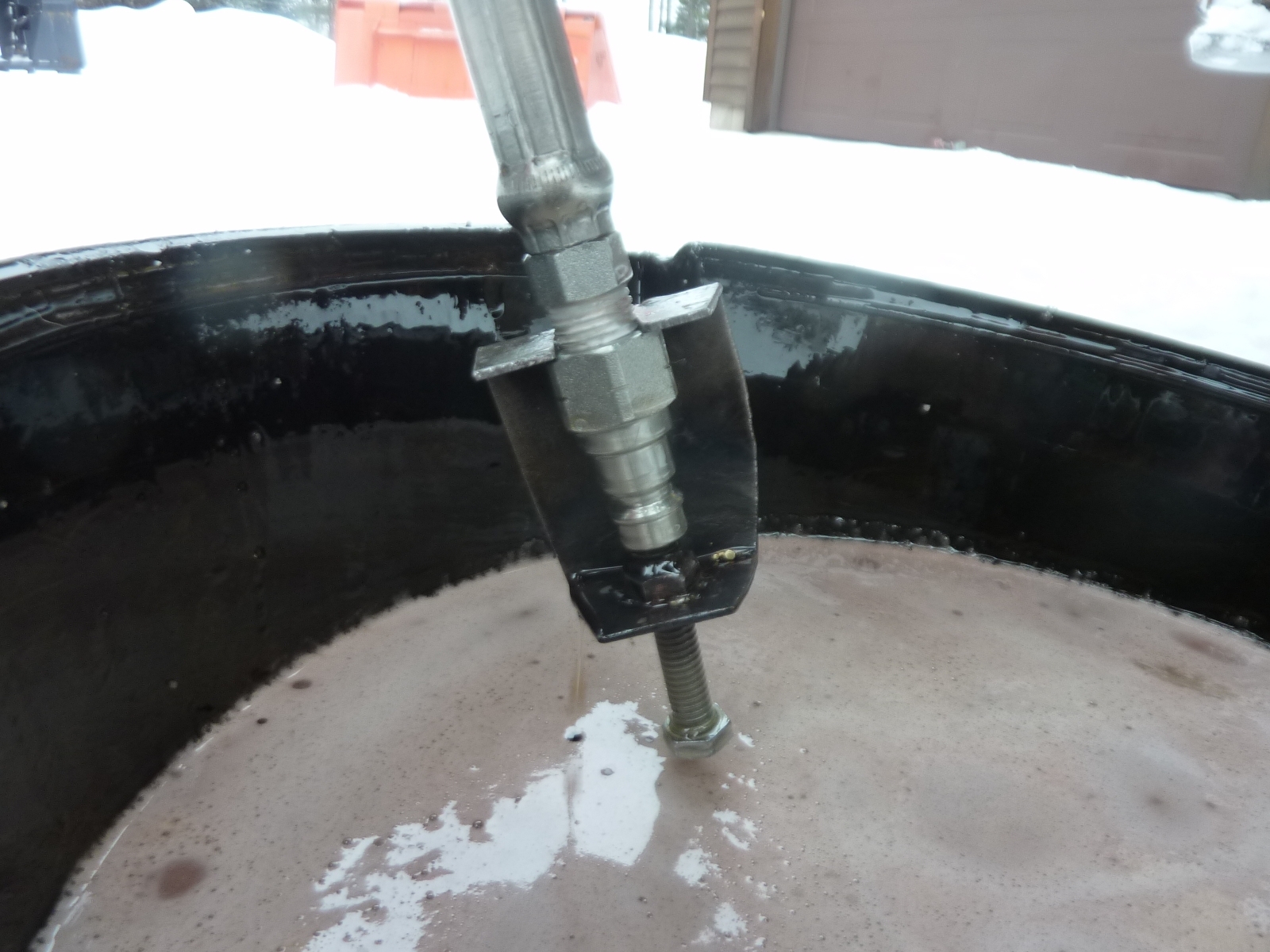

   / The Original Tractor Relief Tool - Easier Hydraulic Connections #39
Here is a simple one I made. A nut welded to a piece of bent up light steel. You could do it w/o welding but you need a wrench to hold the nut. I am using it to hold the connector open to drain the yucky oil from an old plow I bought.
