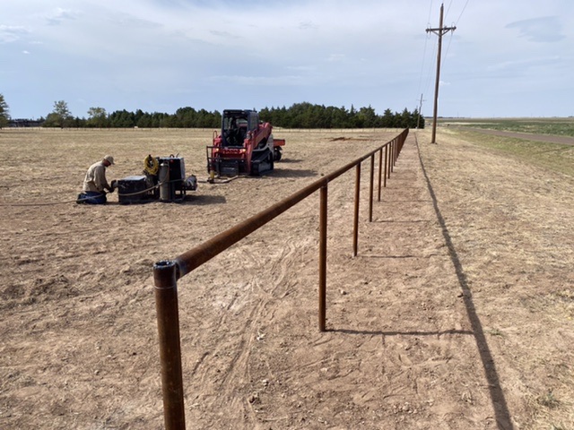

I am sure it works in some places. Here it is painfully dry. Even at 3’ deep the dirt is so dry it is like powder. It is actually hard to get it out of the hole as it just runs off the auger like sand. I have heard of some people here who pour the dry mix in the hole and then add water but to me that just doesn’t seem as good. In the grand scheme of things and all the other costs involved mixing the concrete isn’t that hard to do. Plus I like knowing how quickly the posts will be set. If you pour dry mix in a hole and count on ground moisture to set it who knows how long that might take right? Premixing I can come back the next day and weld up the fence and know my post isn’t going to move.
We finished setting all the posts yesterday. Ended up using 8.5 pallets, or 360 80lb bags in three days. Today we start welding.

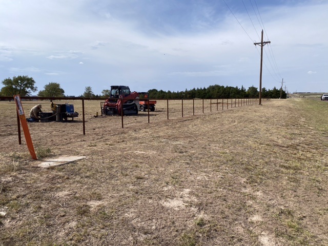

Today we welded the top rail on one side of the five acres. I have three helpers but am the only one that can weld and run a torch so it was a slow process. My guys were cleaning the concrete off the posts and raking out the ground as we went along to get rid of the piles from the holes. I am pleased with how it turned out but it is going to take quite a bit more time to finish.

Because it is basically a fence around my house that borders two paved roads. I want it to look nice. It is not like it is a fence around a back 200 acre pasture or something.
