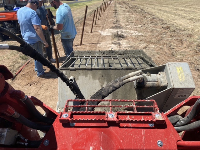

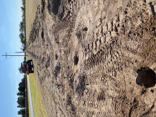

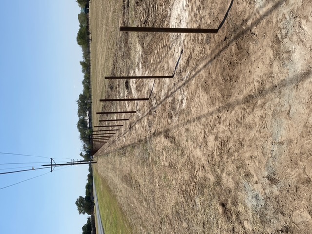

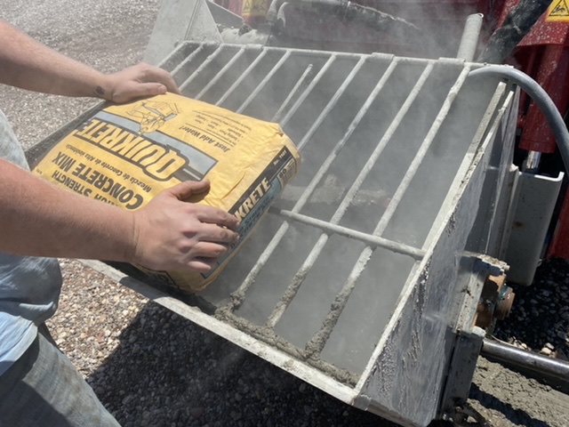

Actually it is nine pallets. We are building a pipe fence around five acres adjacent to our house that we purchased.
We are using 2-3/8 oilfield pipe. Drilling 9 holes 36 deep for each post with posts spaced 8 apart. The fence will have a pile top tail and then the 50 livestock panels welded on for the fence. Each post is set with two 80 lb bags of quickcrete.
I have about a half mile of fence I built exactly like this ten years ago with zero issues. I actually pulled a small section of it out this week and busted the concrete off around the post and it was still shiny metal with the factory paint ID numbers on it. No frost heave here to worry about.
Today we set 64 posts.
When we built the original fence we used a harbor freight emend mixer. Mixed one bag at a time, dumped it in a five gallon bucket, and then dumped it in the hole. Now we have a mixer that mounts on the skid steer. We can put 16 bags in it, enough for eight posts, and it has a chute where we can just drive to each post and dump the concrete in.

I had never tried it before today but I marked all the post hole locations with my GPS. I took a reading on each of the corner posts and then calculated the length and divided it to find the number of posts without exceeding 8? The posts are actually something like 7.96 apart. I then built a file with the coordinates of each fence post and marked their locations on the ground to drill the holes.
We stretched a wire between the corners when setting the posts to ensure they were straight but I was pleased at how well it worked. All of the posts fell in the holes and 90% of them were dead center.
